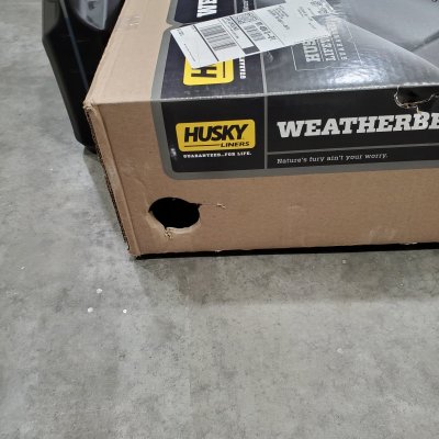

If you happen to live in an area with minimal sunshine and have no ability to warm up your liners so they will lay down the right way once installed try this.
Cut a circle on one side of the box then an exhaust hole on the opposite end of the box. Install a blow dryer and run it for 10 minutes at high. This will warm these liners up to the point they are hard to touch due to them being hot and they will lay down on the vehicle the way they were designed :)
