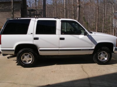

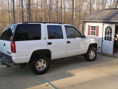

Here ya go its only a 3in Body Lift but ive got 31's on it
1st is before
2nd is after
1st is before
2nd is after
i lke that and thats the lift set up i was planning on too. but mines blue with a silver bottom so im still on the edge of demolding but on a solid color like urs it looks sick
