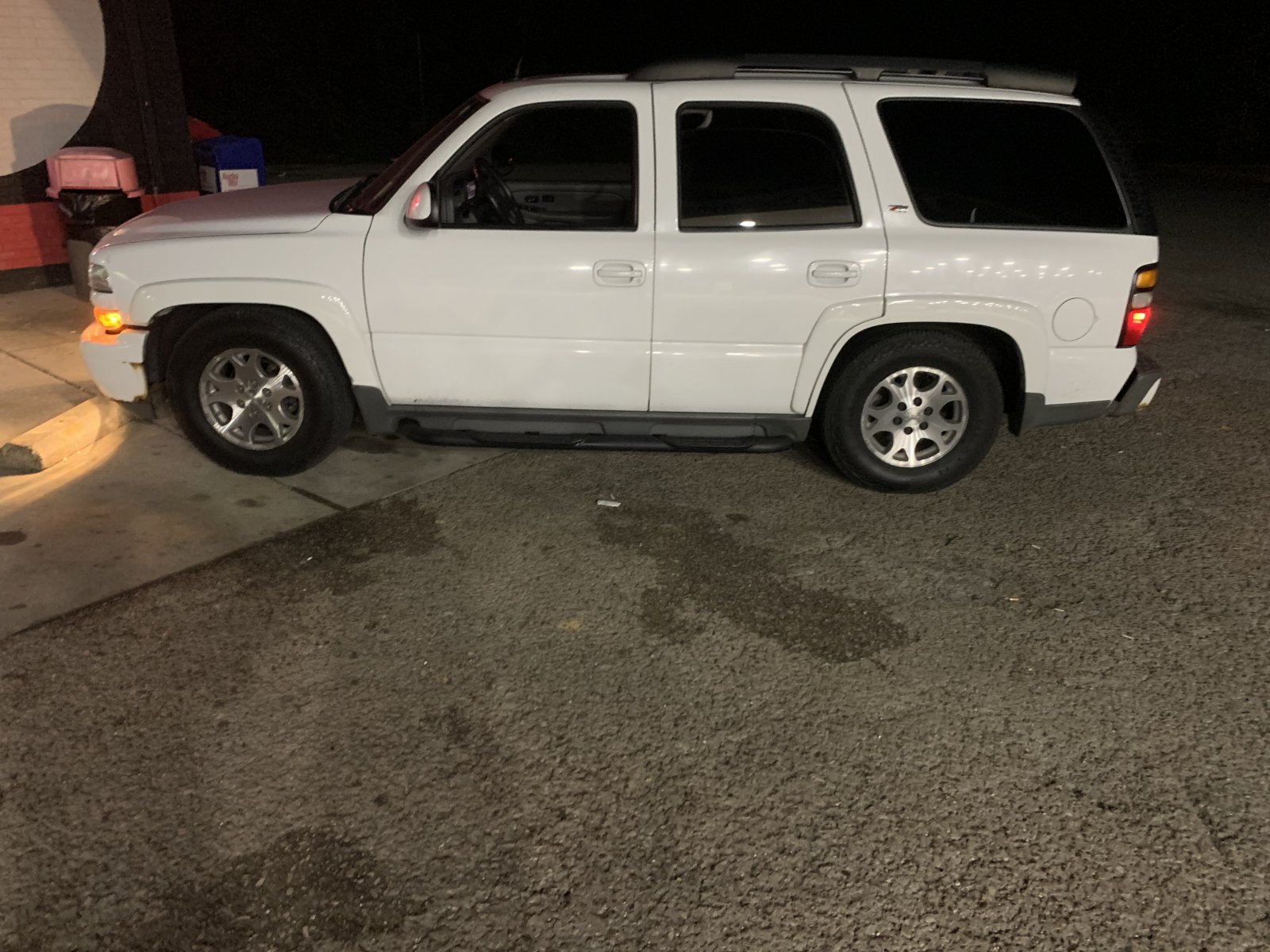

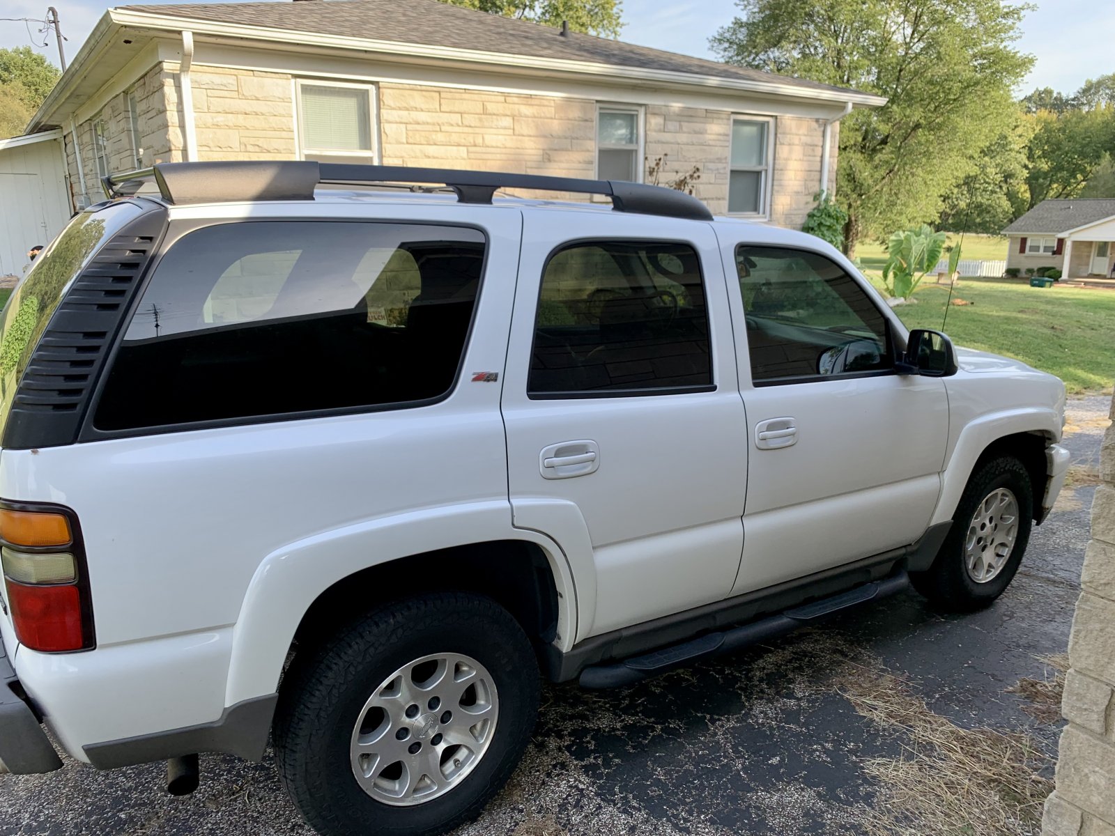

Start of the build of my 05 z71
Imlow78
Sep 29, 2021
122
180

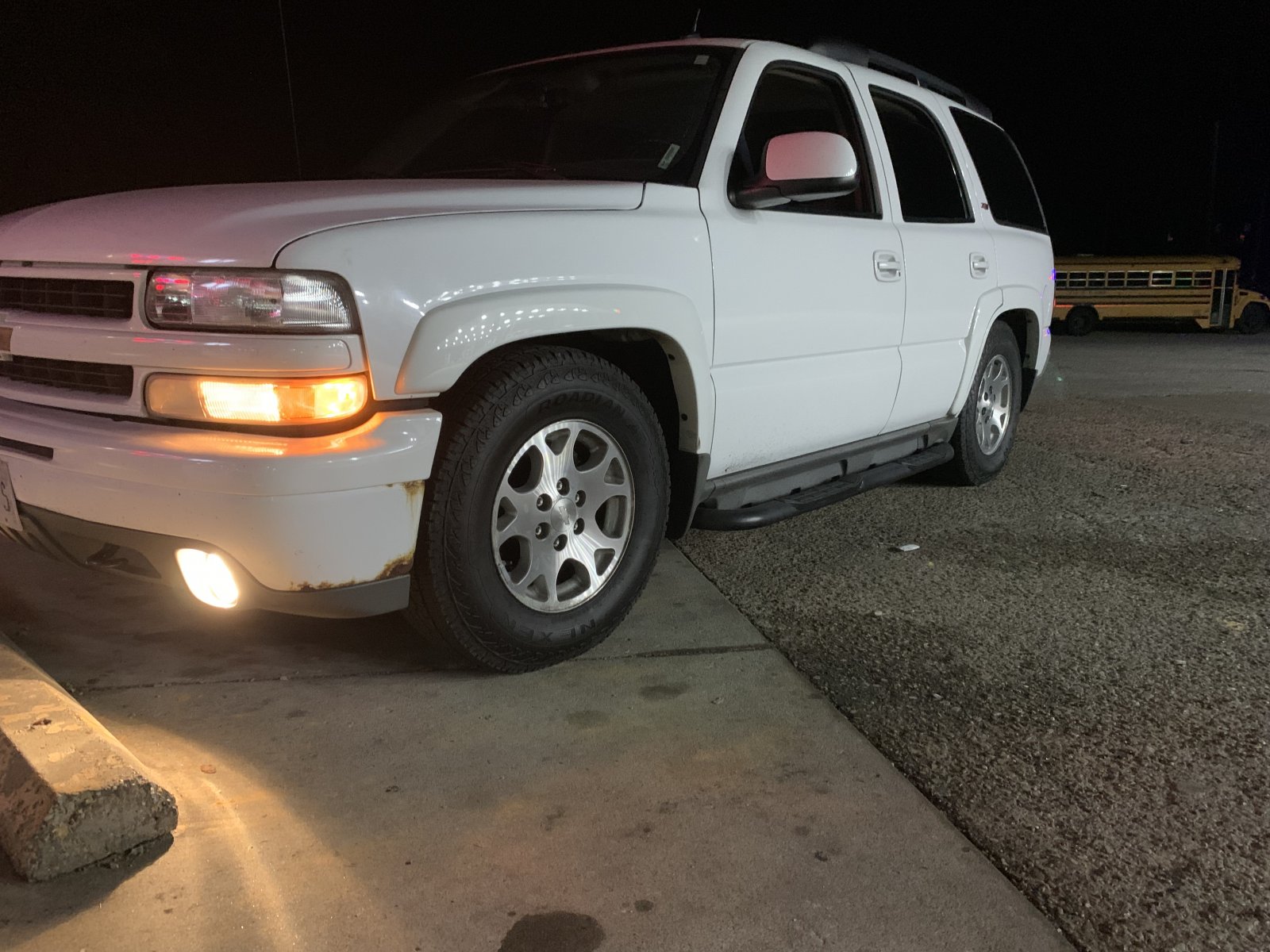

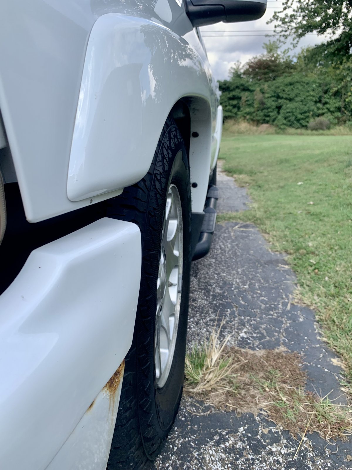

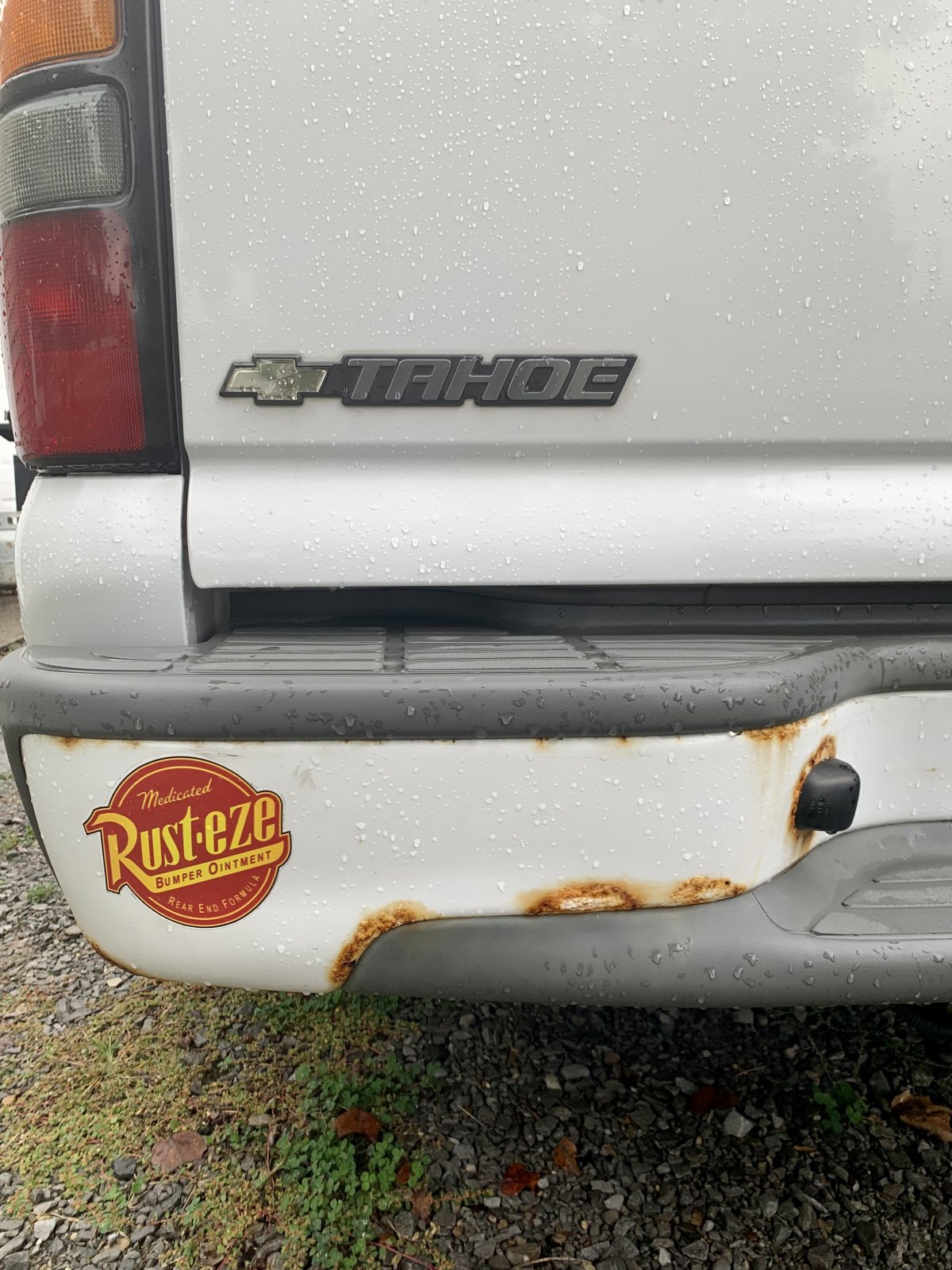

I’m calling her old Rust EZE. (Bumpers are the only rusty part) more info and photos to come Saturday after I rebuild the front end and lower this pig.

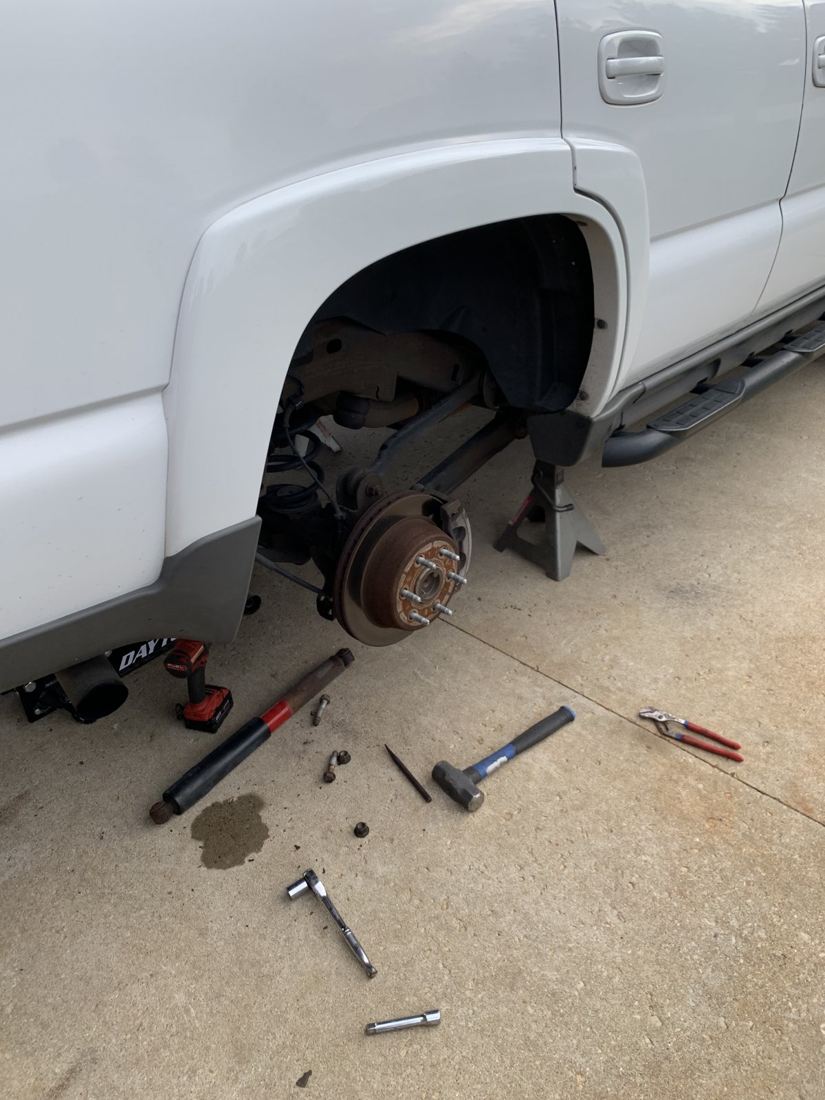

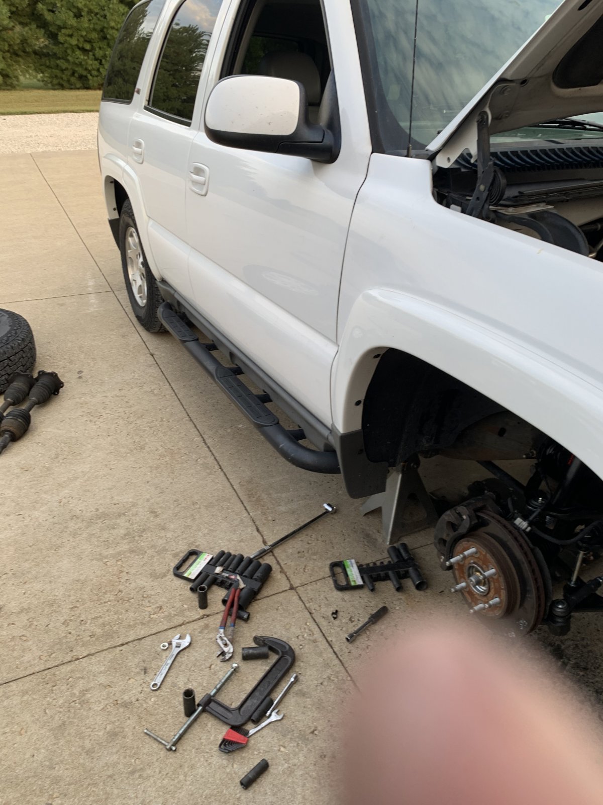

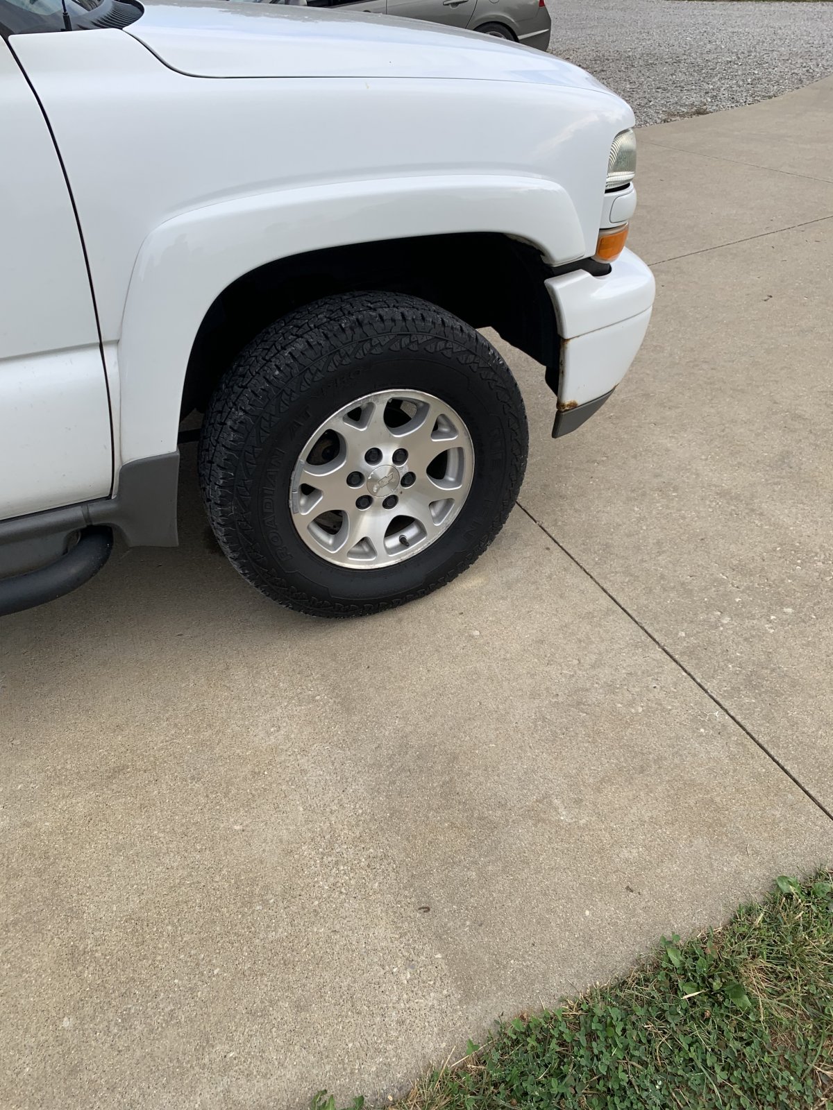

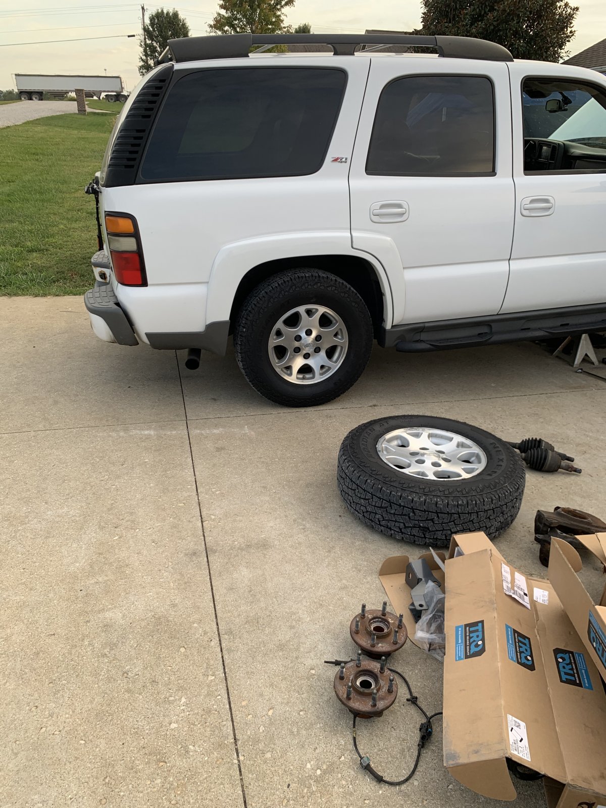

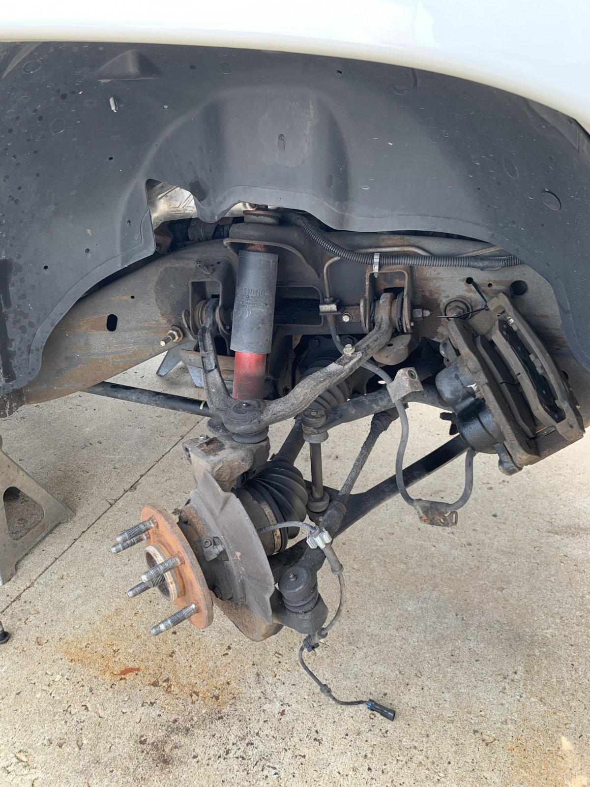

So maxtrack lied. The factory 17’s would not fit without some massaging of the lower ball joint. FML!

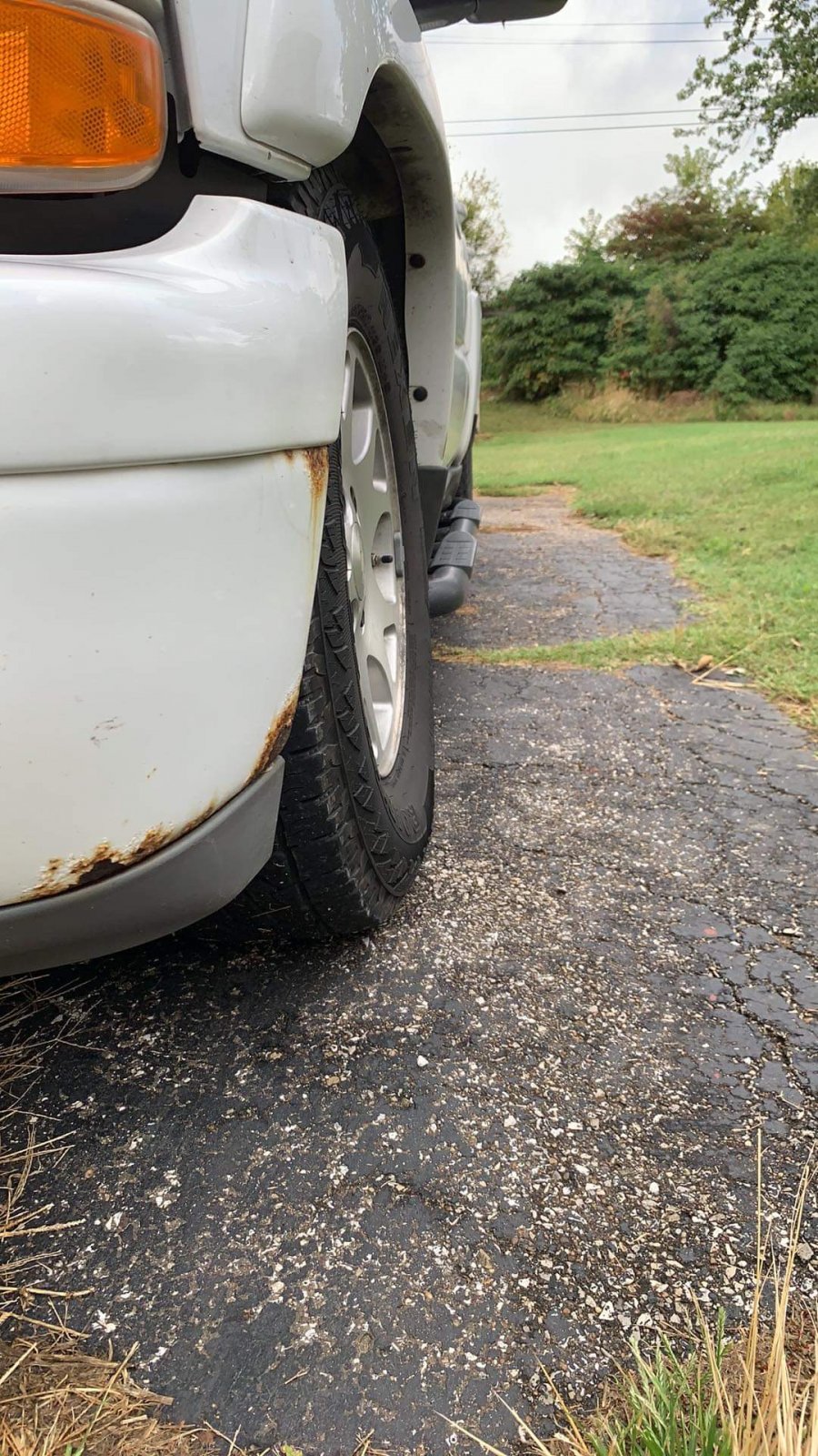

Drove it a little yesterday and the front settled. Ordered new bump stops and the alignment kit from Belltech. That stuff should be here tomorrow. Got to love it.

I'm also lowered, along with an alignment kit, and my front wheels are at a similar angle. Had it aligned twice too.

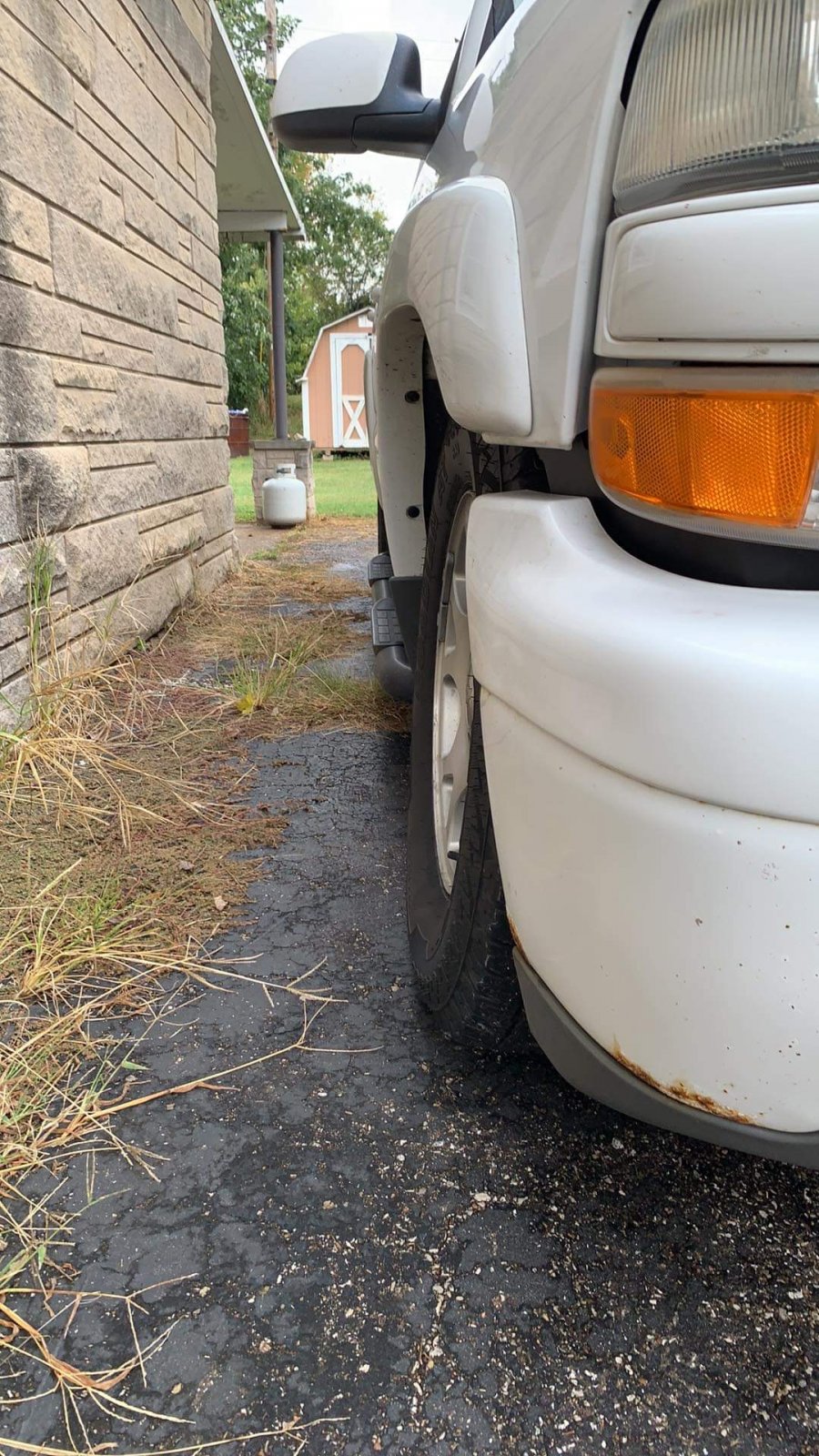

No more bow legs in the front. Thank god I bought the camber alignment kit from belltech. Maxtrac really missed this one with their 3/4 drop.
Now I’ve got to buy some helper bags for the back to try and band aid the ride. Then fully remove the bump stops on the front. Seems the ones I got from belltech won’t work on the front.
