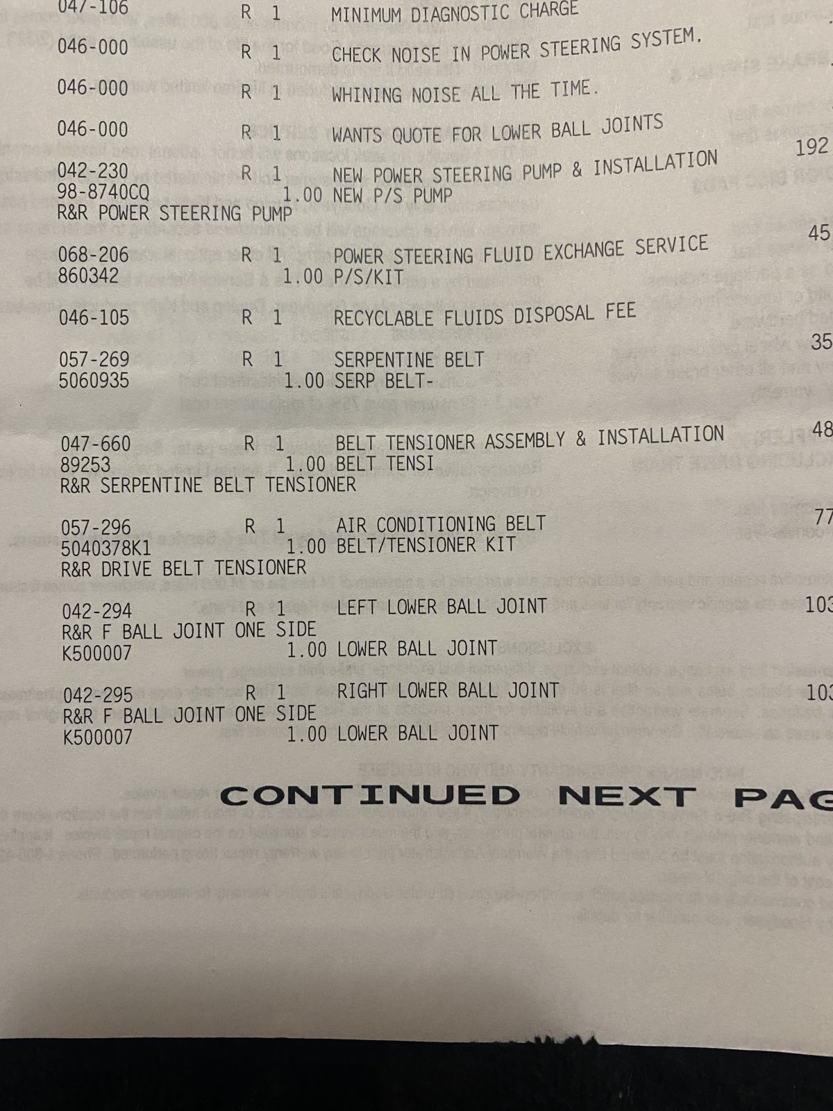

Does it specify the brand or part number that was installed? Wondering what the quality is.
R&R? Maybe?

Any recommendations on a tensioner that will last more than 3 years? This one was replaced in December ‘21 by the previous owner. I haven’t called the installer yet but the paper work is pretty clear, warranty valid to original purchaser only.
5+ yrs and 63k miles ago I repalced all my belts, pulleys, tensioners, with NAPA/Gates.
Still going strong.
