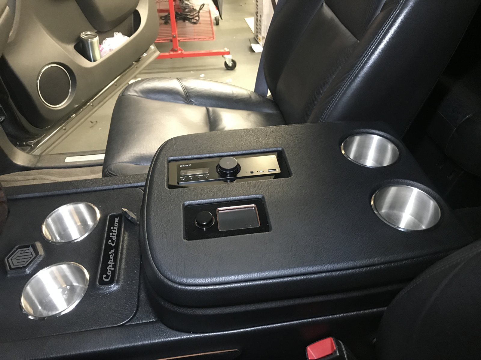

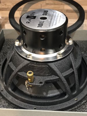

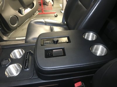

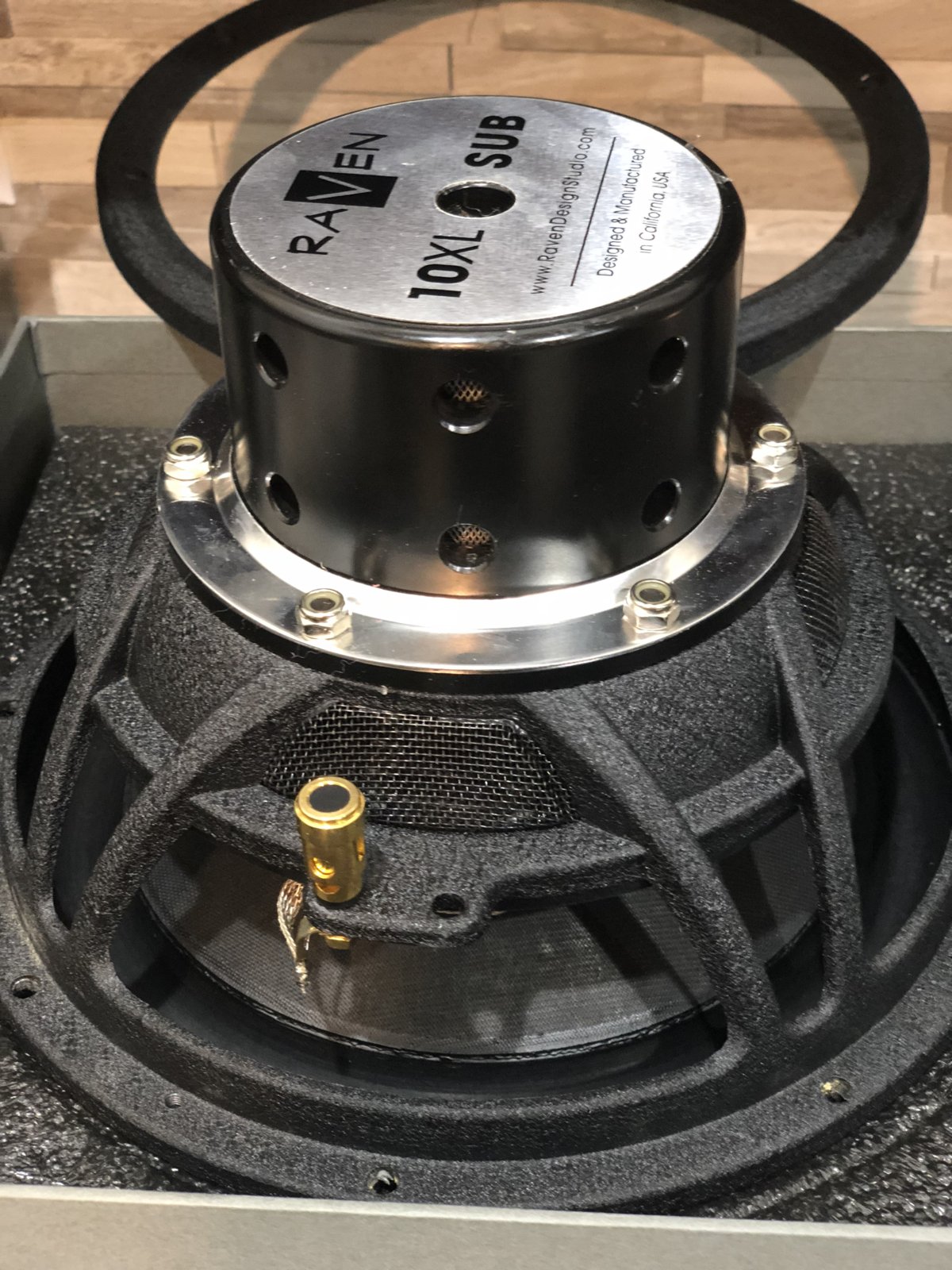

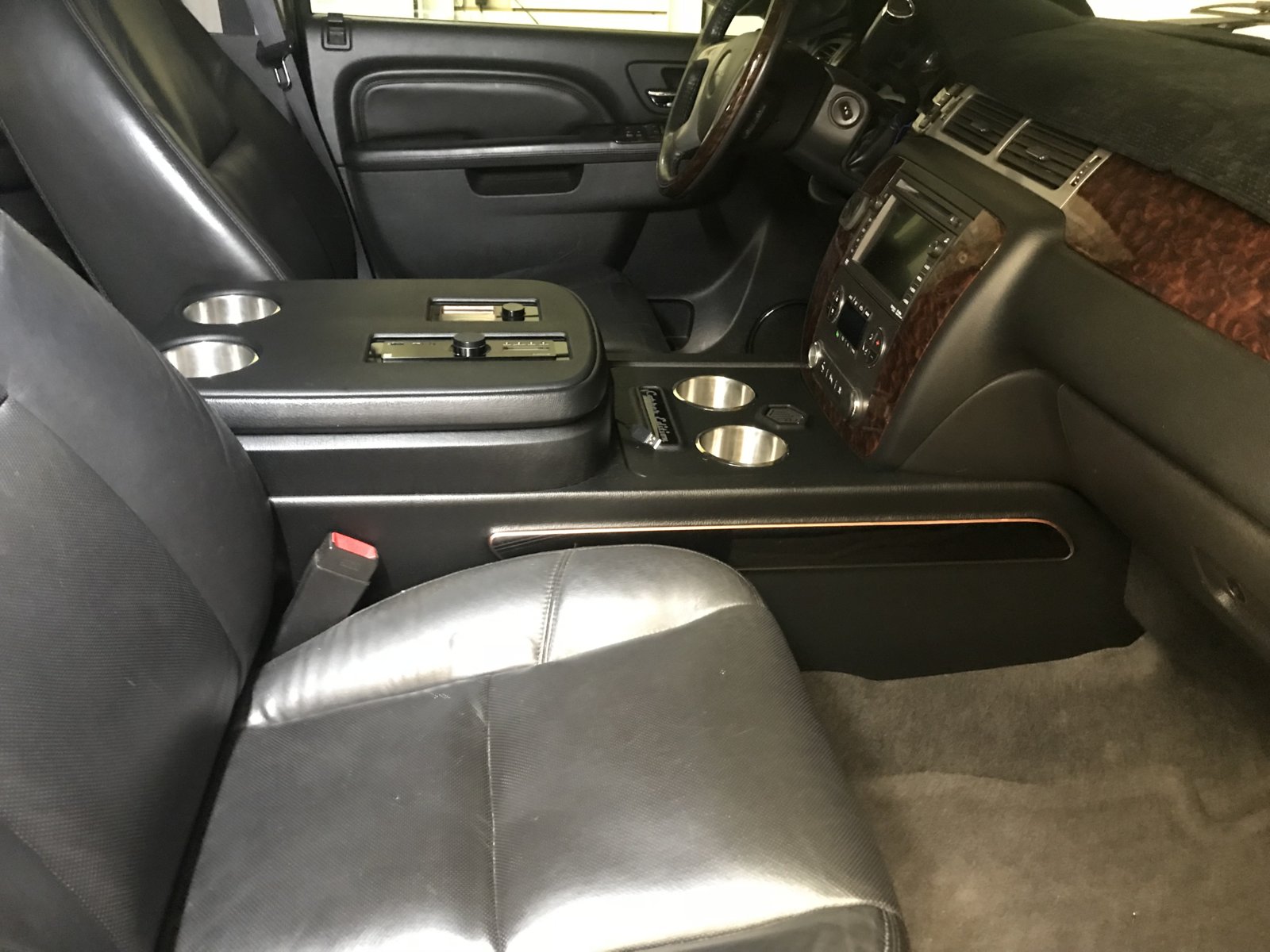

The subwoofer I decided to move upfront from the rear and had a custom console built that functions as a subwoofer enclosure and houses a Raven Design Studio 10”XL subwoofer upfront. It is Illusion Audio’s before Home Audio version on the 10”. It also houses my Sony RSX-GS9 Hi Res Audio headunit and controller/Director for my
Helix Pro MKII DSP.

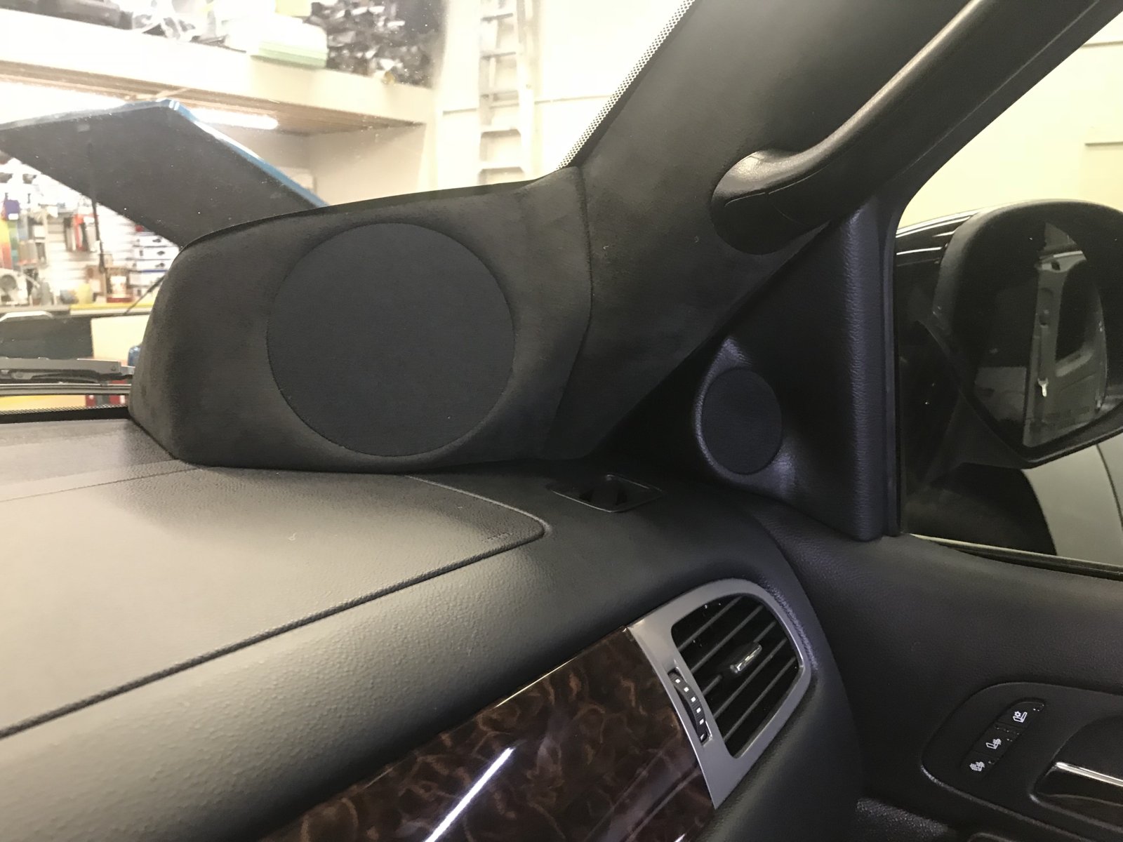

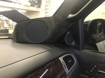

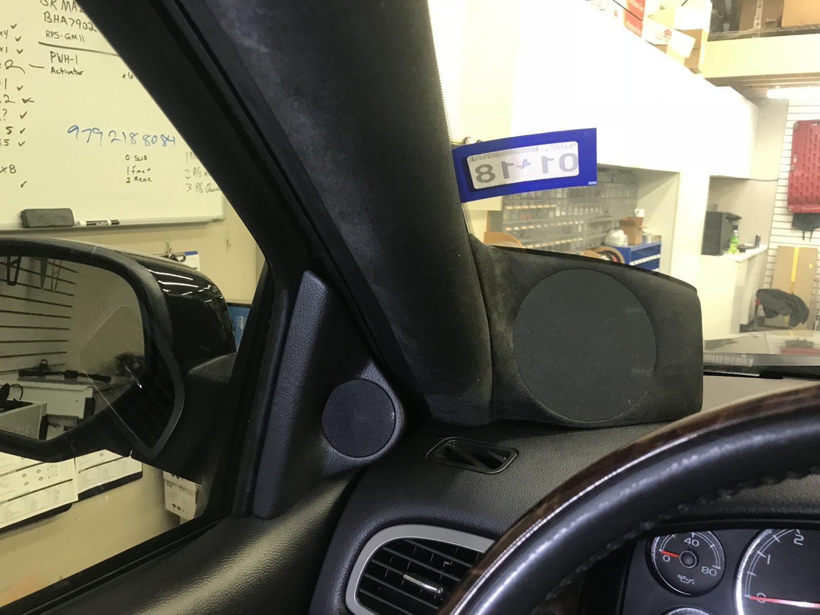

I wanted a wider stage so we moved the tweeters to the Sail Pillers and moved Midrange Drivers wider as well both in custom pods wrapped in black suede and leather for the sails. Changed drivers to Focal Utopia prototype 4” Midrange and scanspeak d2904-6000 1” tweeters.

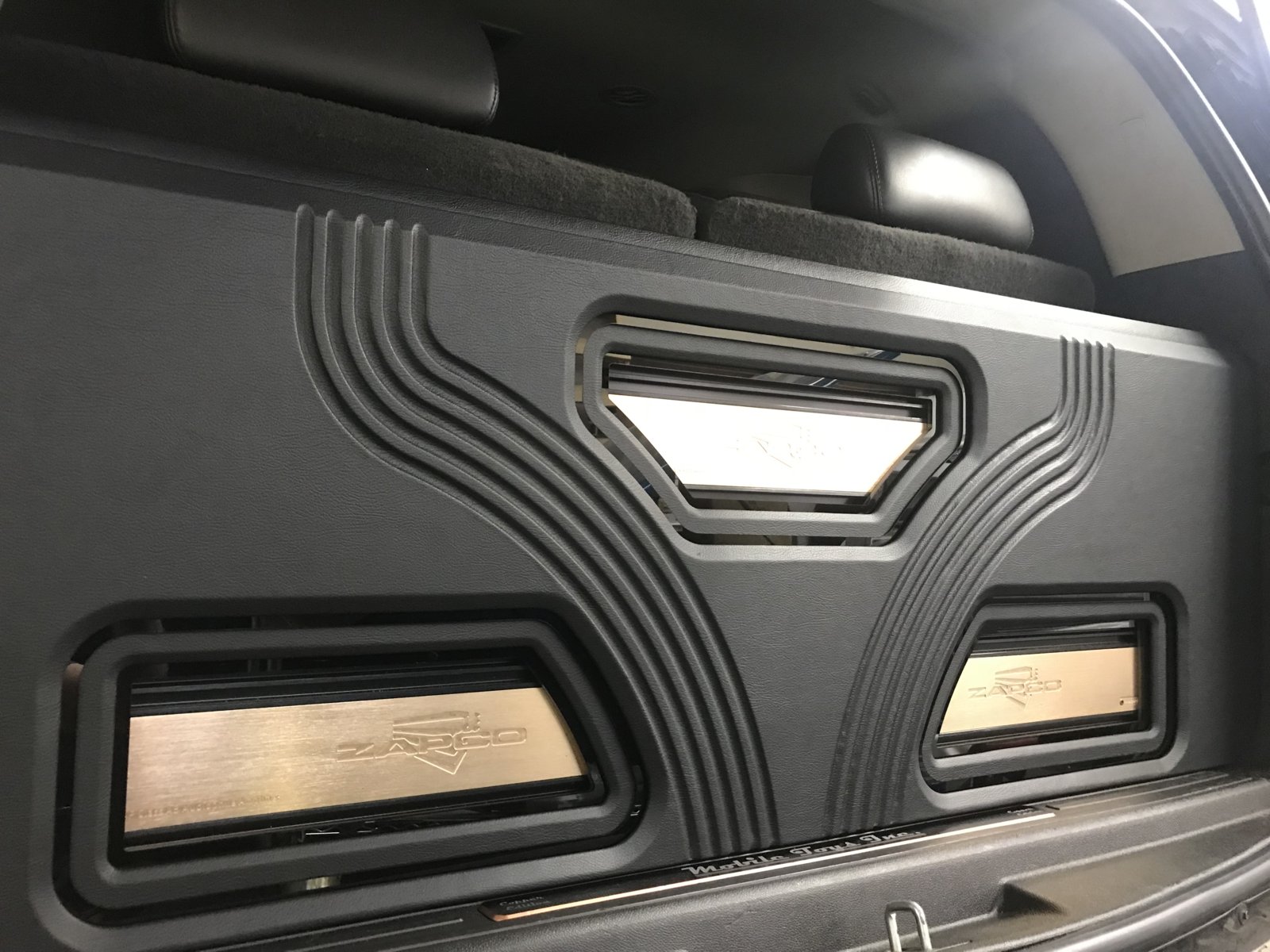

Amp wise I am running 3 Zapco Z AP amps- these are Zapco’s top of the line audiophile amps that just came out.
I have a 400.2 bridged to 1350@4 ohms to my Raven sub
400.2 going to my Illusion Audio C8, 8” midbass drivers in kick panels.
150.4 powering my Midrange and Tweeters.

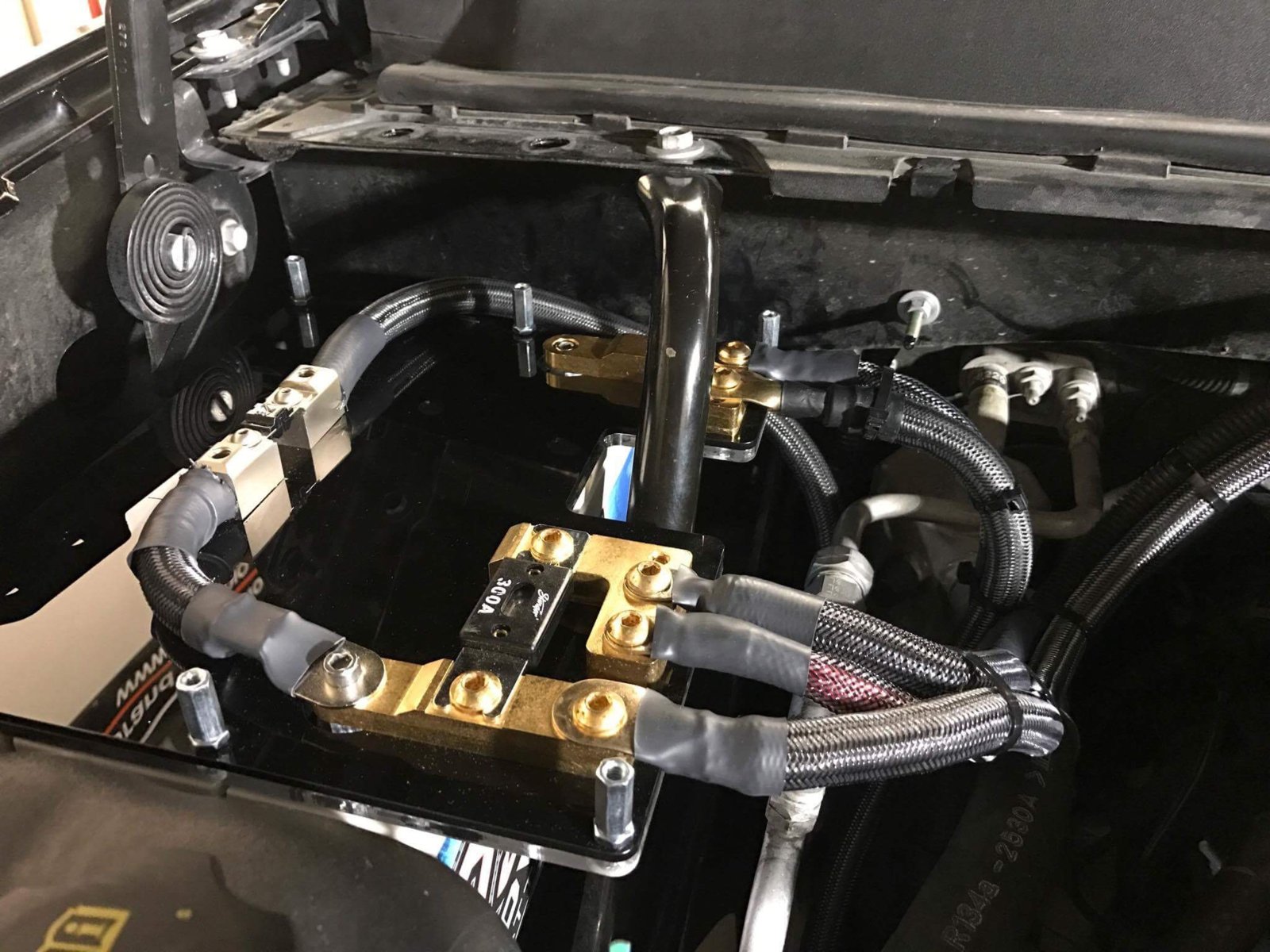

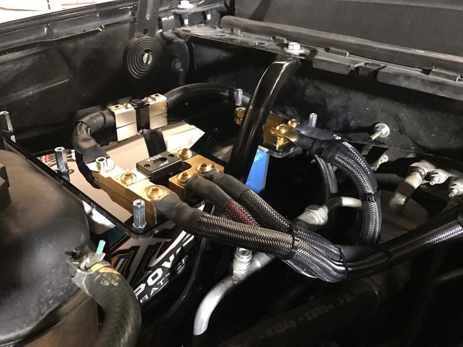

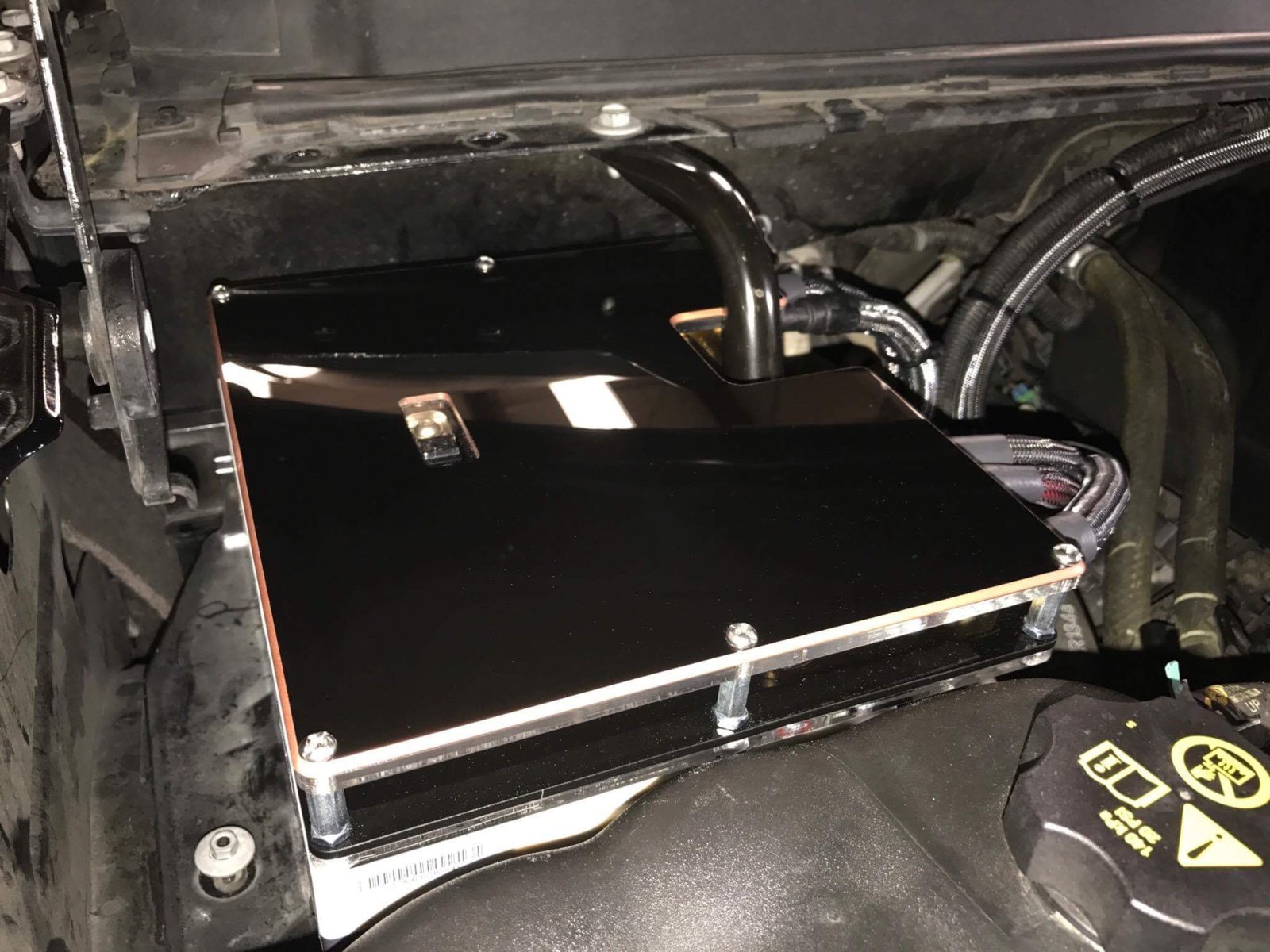

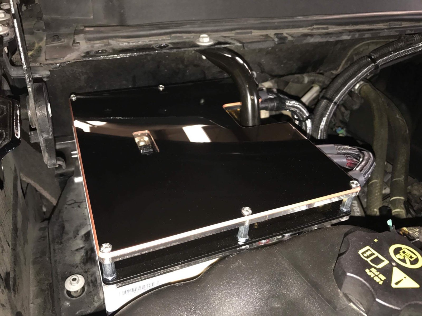

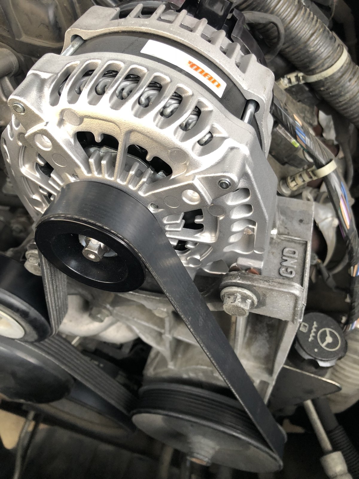

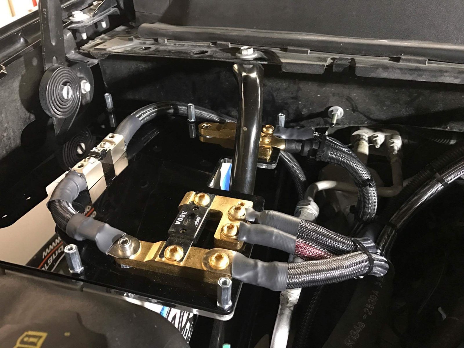

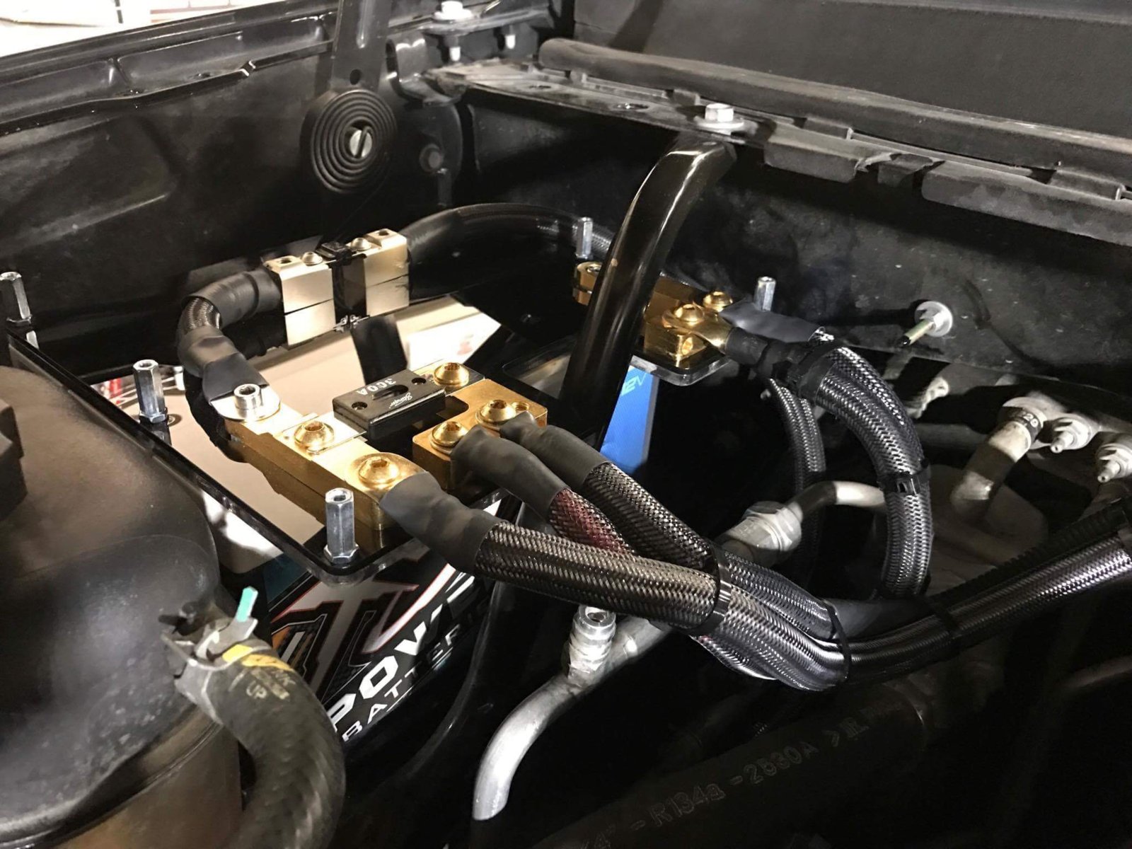

With the amount of current needed for my Audio system I went with a Mechman High Output Alternator and XS Power D3400 battery.

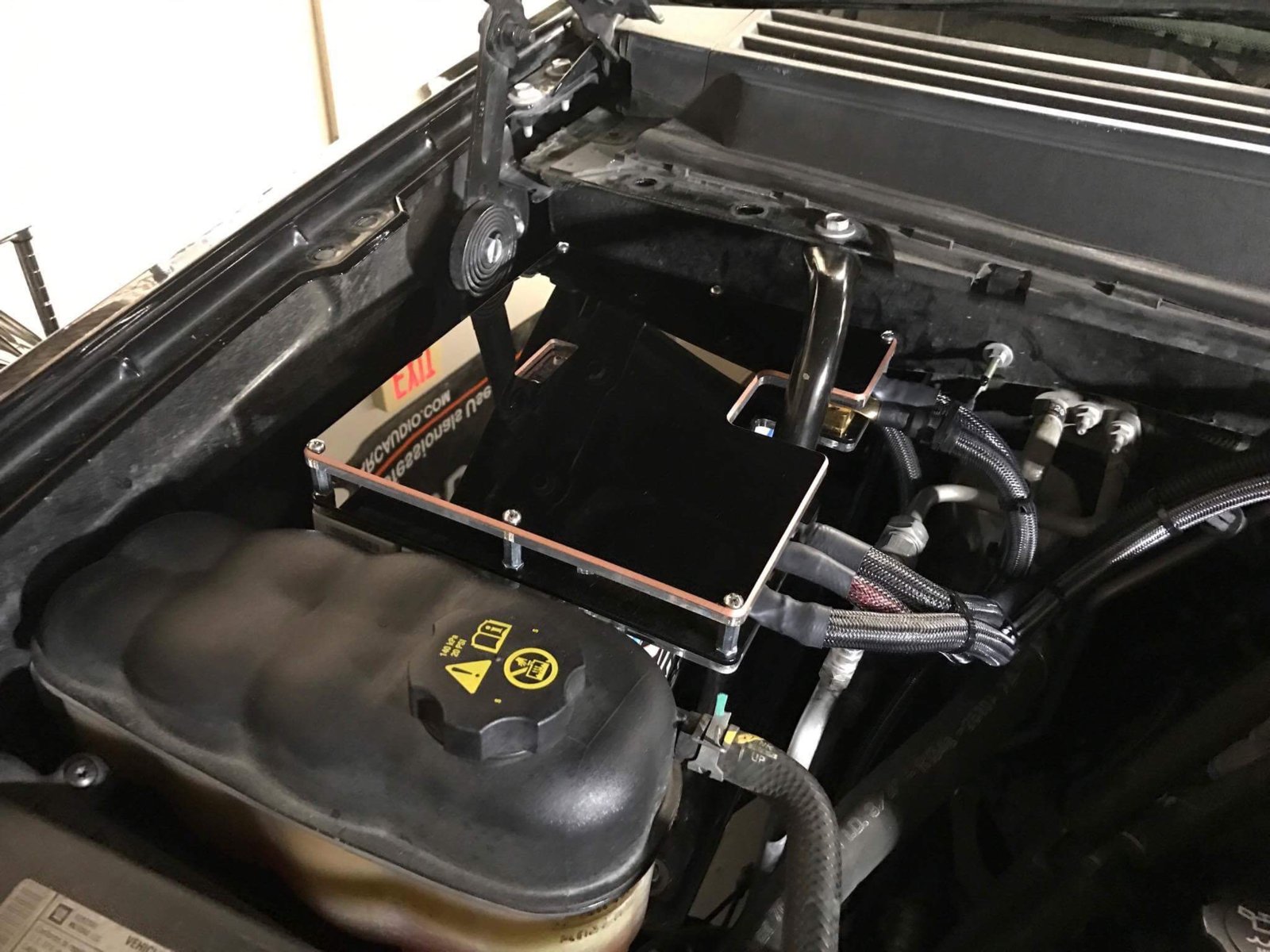

Came out very nice ! Did you have to do anything special to fit the XS Power 3400? Or did it drop right in?

The 10” sub is inside of the new center console I had made. It fires directly into the dash as per my needs for a smoother response.

Nice! The alt is a must. I'm surprised you didn't add a second battery.

How did you get the battery secured in your setup? I Want to add the D3400 in my Tahoe also just want to make sure everything will go in together before I drop the $.
Both of my batteries are under my back seat. I'm running my sound system off one and everything else from the other one.

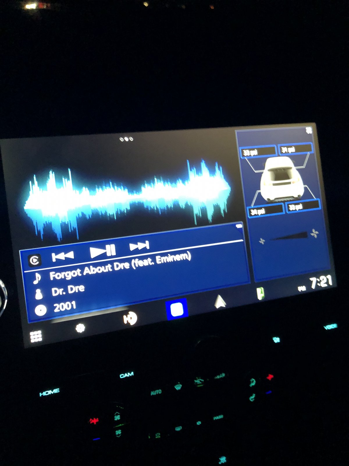

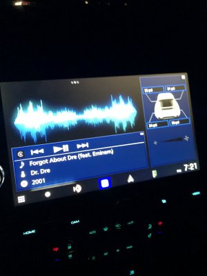

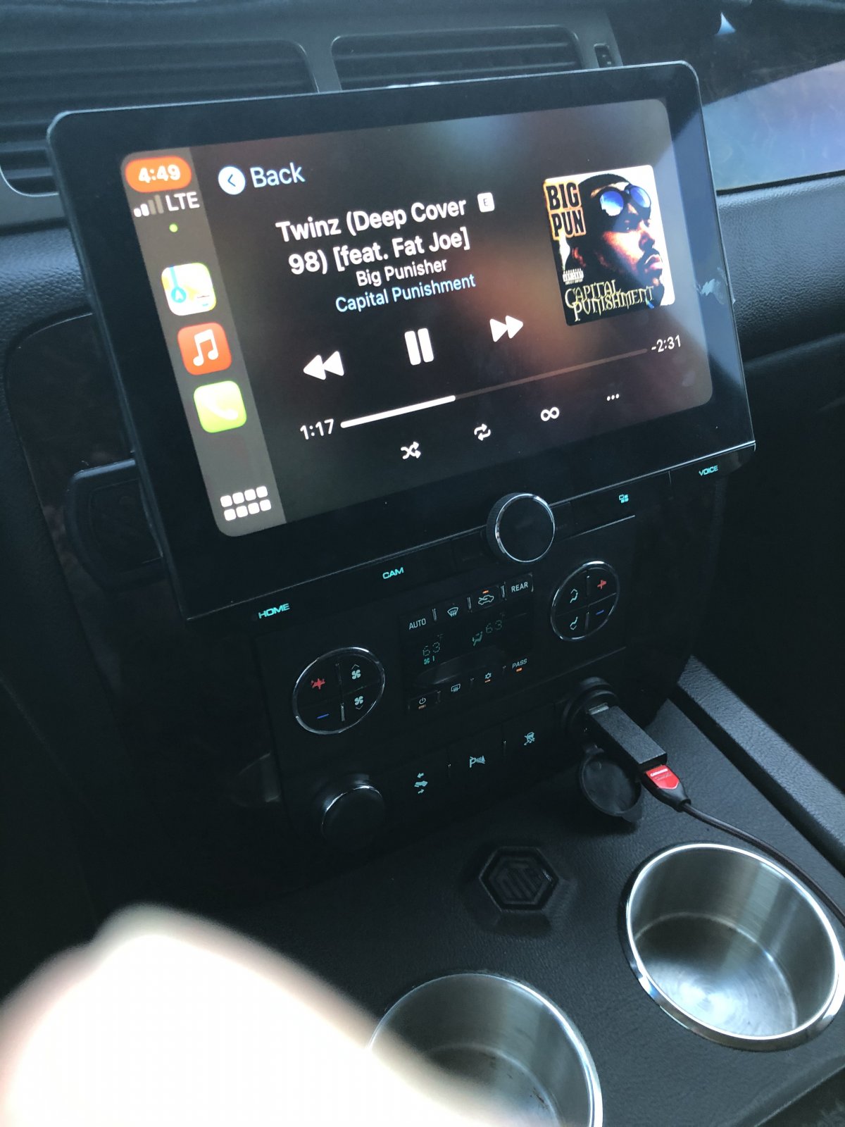

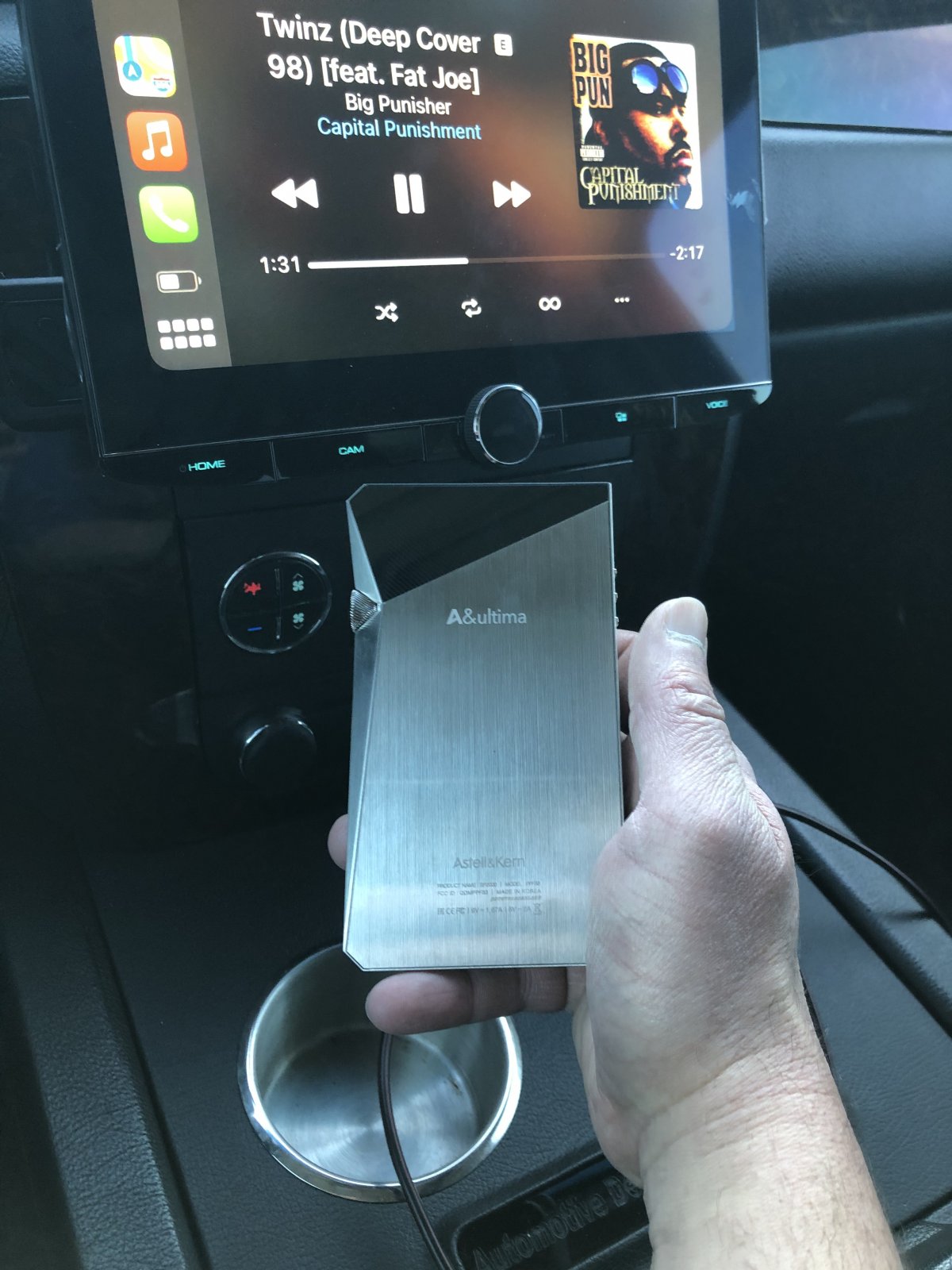

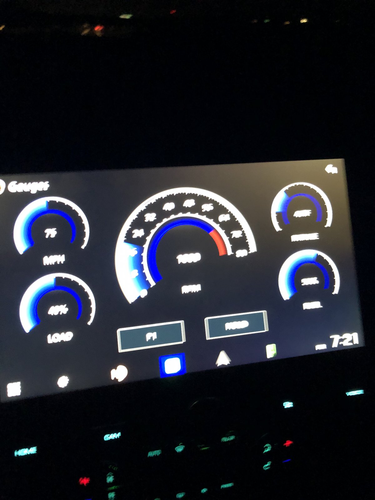

And then there’s this I’ve run a Sony RSX-GS9 hi res music media player for 4 years. Amazing Sound Quality but using my iPhone for screen display and maps finally beat out pure SQ.
I swapped it out for a Kenwood 1057XR with the 10.1” floating touchscreen. Best touchscreen out imo. There’s zero glare from any direction, 1280 x 700 pixels full 13 band eq for anyone not running a Dsp and will play my hi res audio files. Very happy with it so far.
