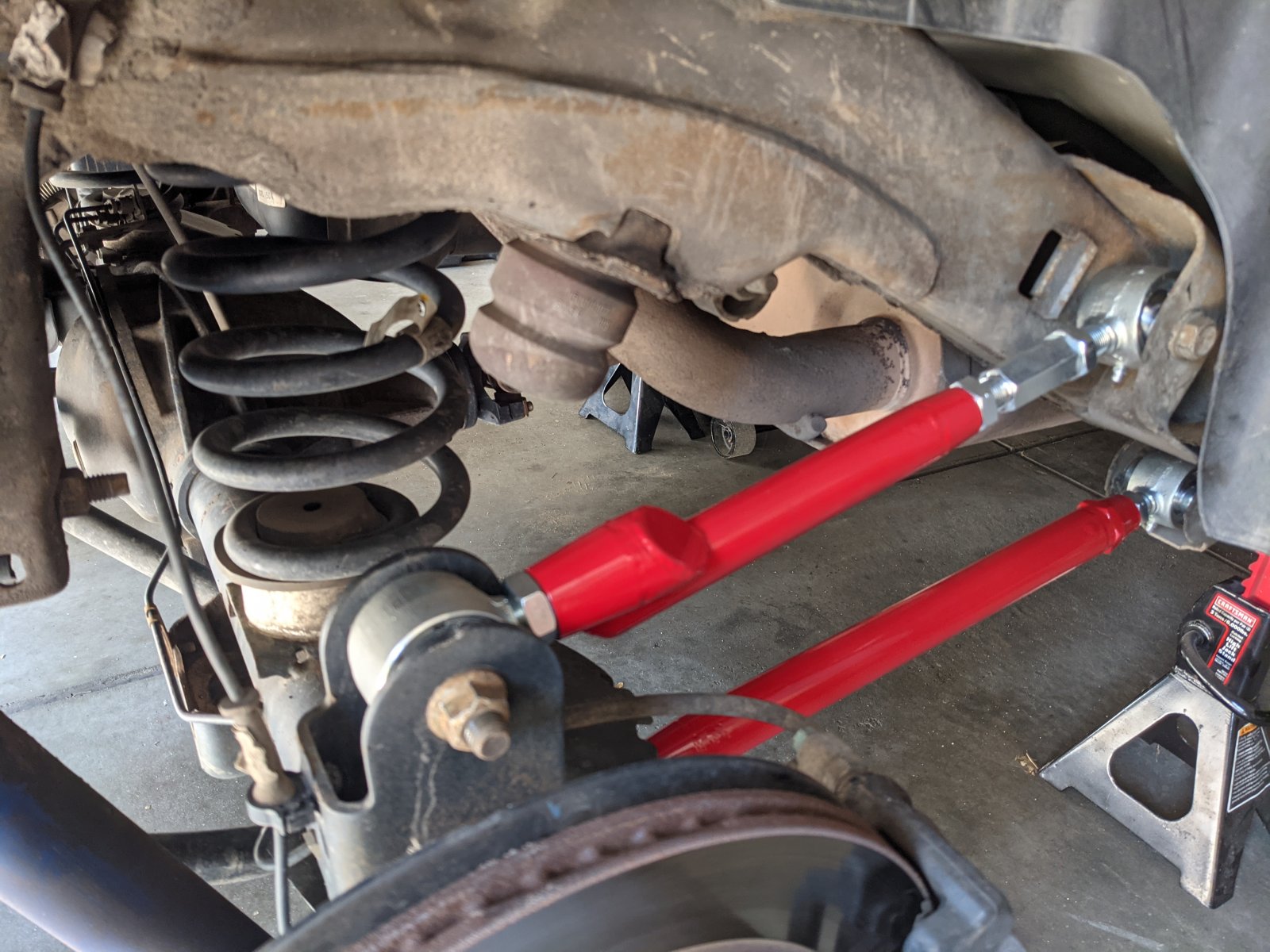

We got them in our Suburban so far no issues. Only been in since April. Definitely alot more suspension travel with them. A little more rear body roll during fast corners or lane changes but not terrible. I got poly bushings wherever it was a option.

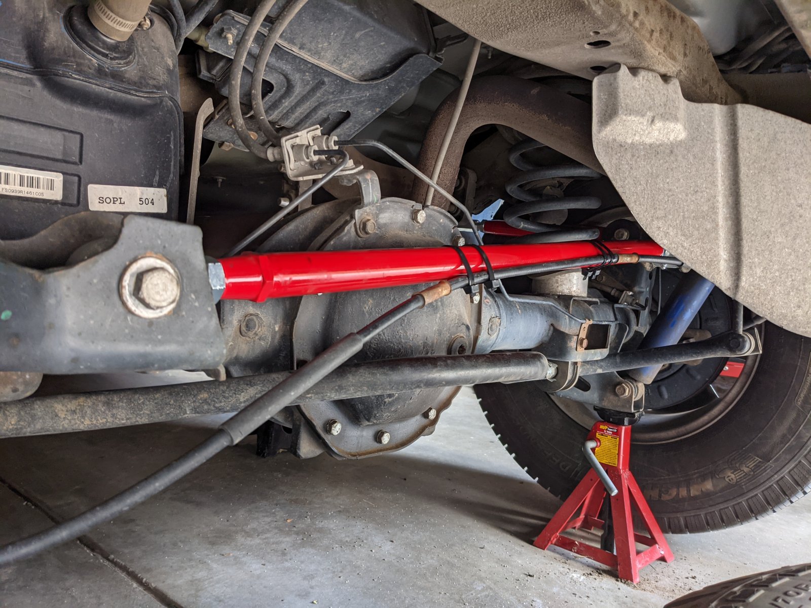

@gmartin1215 I have the Spohn panhard bar with the Delsphere joints. For the first few months I had a lot of clunks and noise from them and It was my fault, I went and tightened the joints pretty tight and now the bar is perfect. I suspect that those people were not tightening the joint enough. I have been running the bar without problems for 3 months now.

@gmartin1215 I have the Spohn panhard bar with the Delsphere joints. For the first few months I had a lot of clunks and noise from them and It was my fault, I went and tightened the joints pretty tight and now the bar is perfect. I suspect that those people were not tightening the joint enough. I have been running the bar without problems for 3 months now.View attachment 305148
