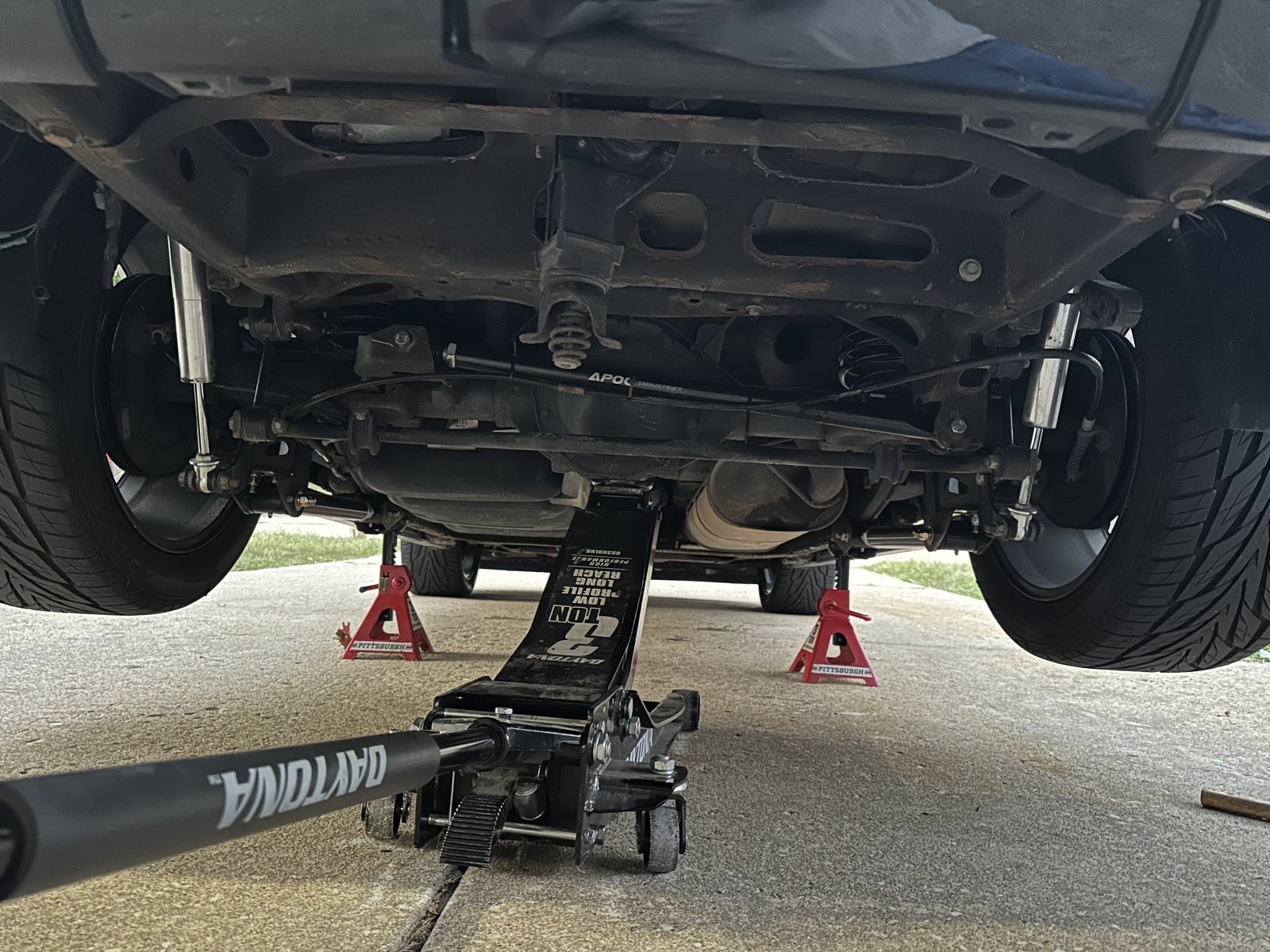

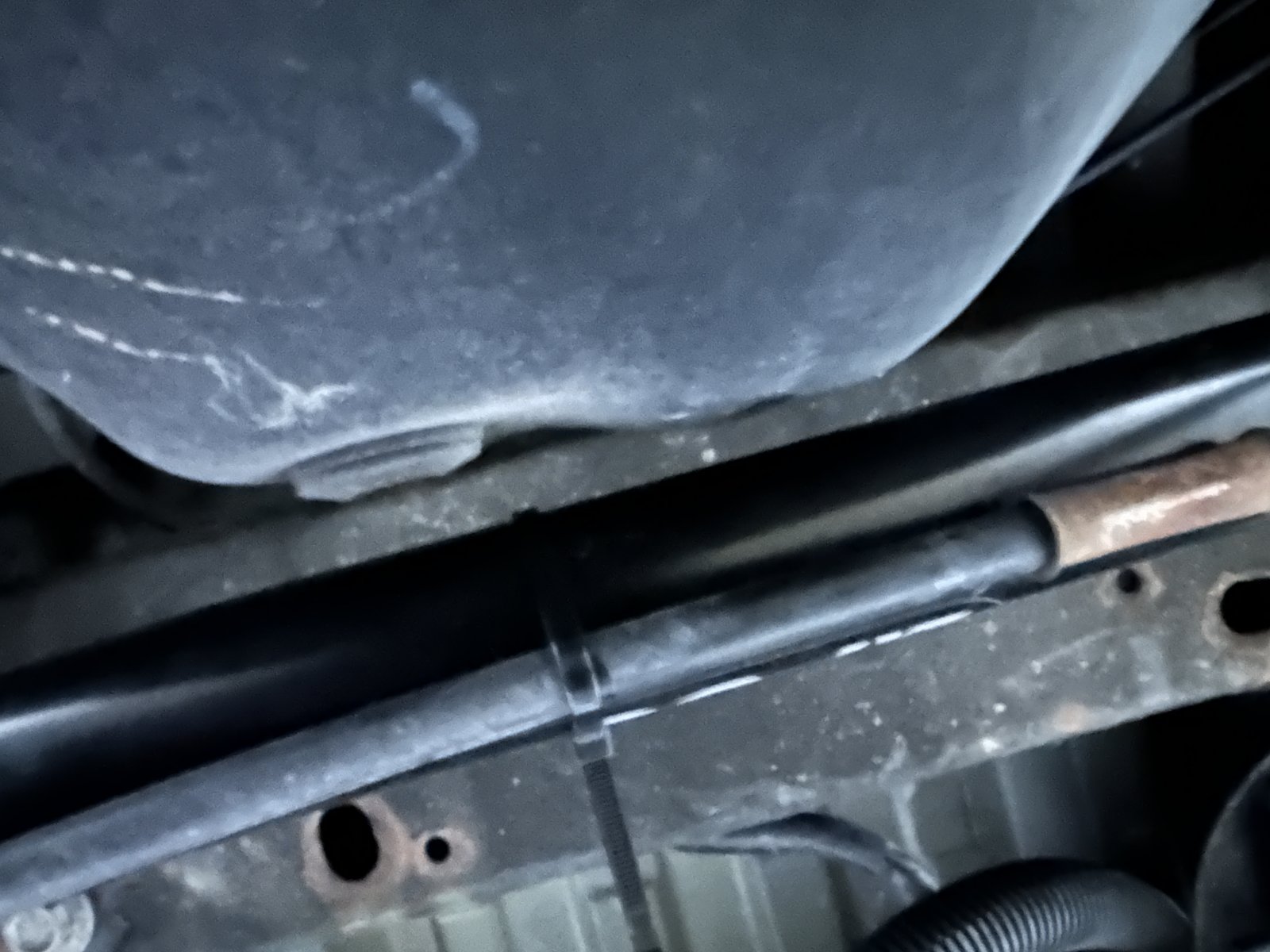

Yessir! I did the track bar, too.
I’m very curious if that curved track bar will clear a bigger aftermarket differential cover I’d love to put a mag hytec on my rig but that’s the main reason I never did
I'll snap some pics tomorrow in the sunlight. Any particular place you want a measurement from?
Mainly the center of the differential cover I reckon? I believe @Doubeleive is the one on here with a mag hytec
I appreciate you getting pics and better yet measurements for us man that’s awesome

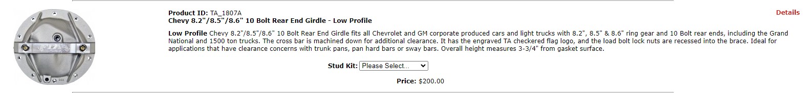

I have the TA performance girdle on mine which is not a big as a mag hytec even with the qa1 bar which has more curve to it than it looks like the apoc has I don't think a mag will fit.
not sure how much clearance it needs

Pictures as promised. This is with the axle resting at ride height.
Here’s the clearance to the diff cover. View looking up, top of picture is forward. Its between .200 and .250" clearance
I had no idea TAP made a cover that fit our trucks! Do you run their original, or low-profile?
30,750
48,438
as far as I know they only make one for the 8.5" , requires a curved panhard bar the qa1 works but they don't make them anymore also had to hit ace hardware and get different bolts the thread on the ones that are supplied with it are not the same thread.
