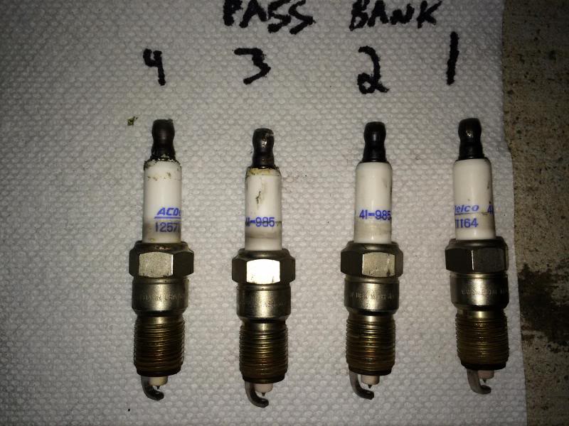

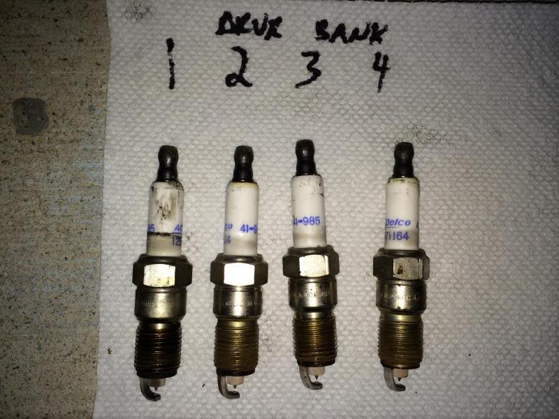

got the new sparkplugs installed. stumble/rough idle is gone
here are the old plugs I pulled out. 100,000 mile plugs my butt! gap was on average 0.080...vice the 0.060 they were supposed to be if platinum tip, or 0.040 if they were iridium tip (most likely since they're cheapo AC Delco).
As far as I can tell, those were the stock plugs at 66,000 miles. Rubber boots were a major PITA to get off. I'm interested to see if I gain any MPG's back now. She's been getting about 15 MPG combined
Drivers side
Pass Side
---------- Post added at 07:56 AM ---------- Previous post was at 07:55 AM ----------
btw, I put the new plugs back in at 0.040 per the TSB that was issued...which I cannot find at the moment. Basically it says that you use 0.060 gap for platinum tip plugs, and 0.040 for iridium tip plugs. Platinum burns hotter so you can have a bigger gap
