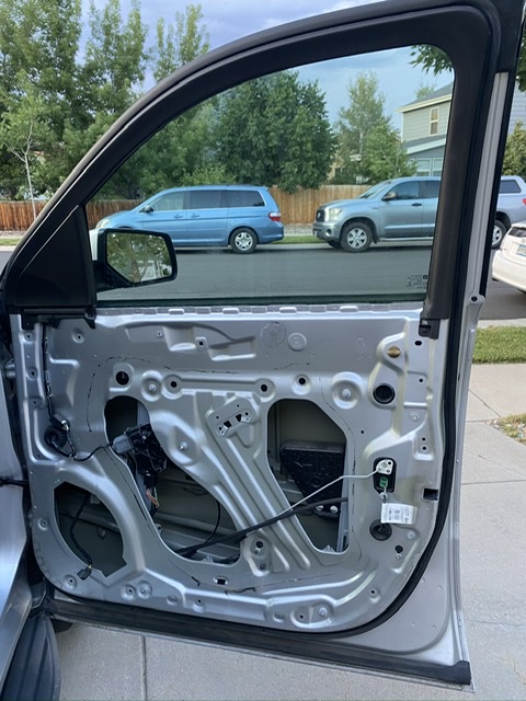

Interior is out.
Sound deadener going in.
How much of a difference can I expect?
Covering the floors, removed headliner covered ceiling, working on the doors outer skin then door panel.
Kenwood stereo & Focal speakers next.

mostly the Noico 80mil rubber pad
They sell a foam I used on the roof and layers of each in the doors.
peel and seal from Lowe’s as a cheap supplement in areas of the walls and rear door.
the peel and seal could be used for the whole thing and results would be pretty good.
