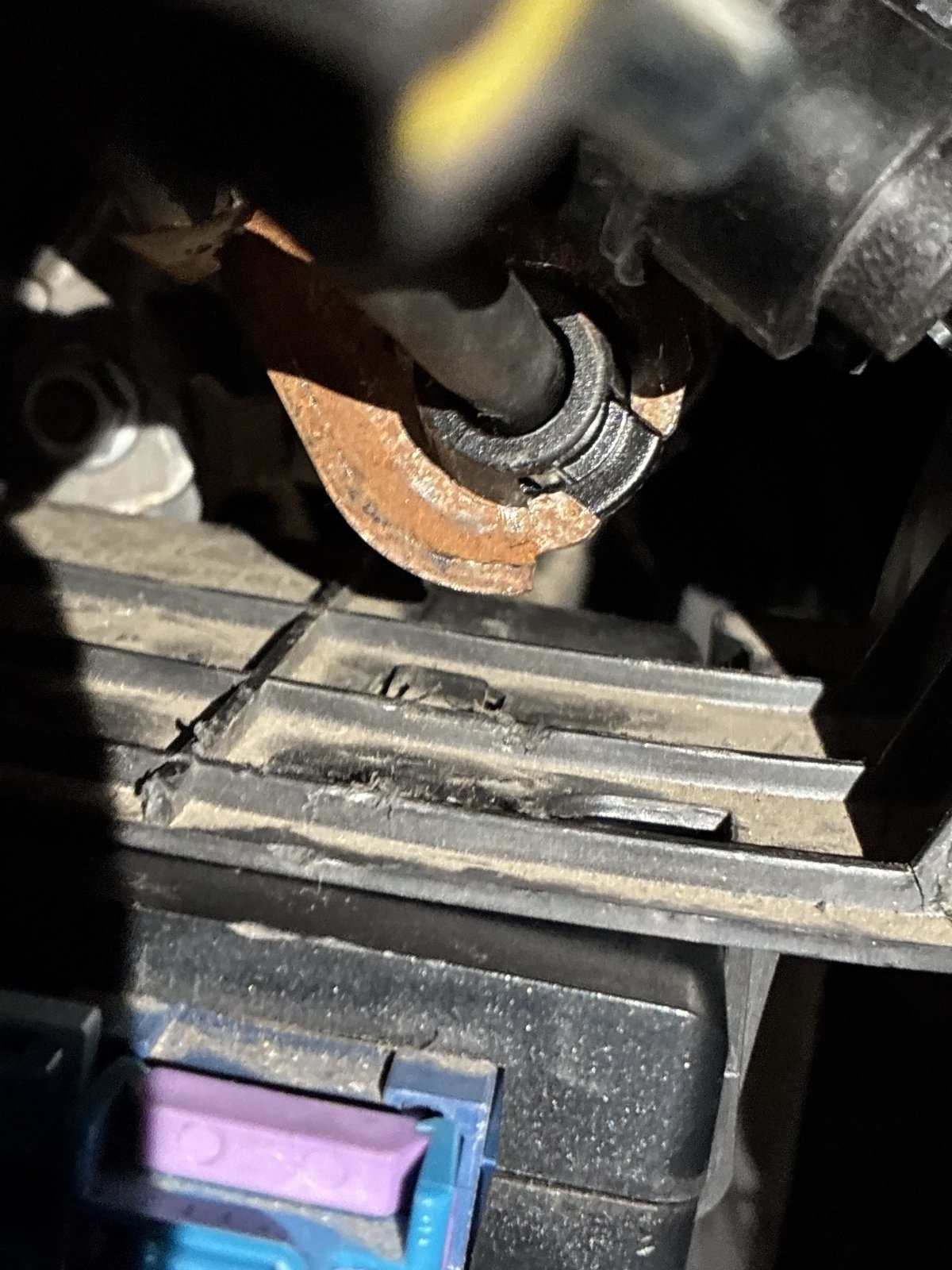

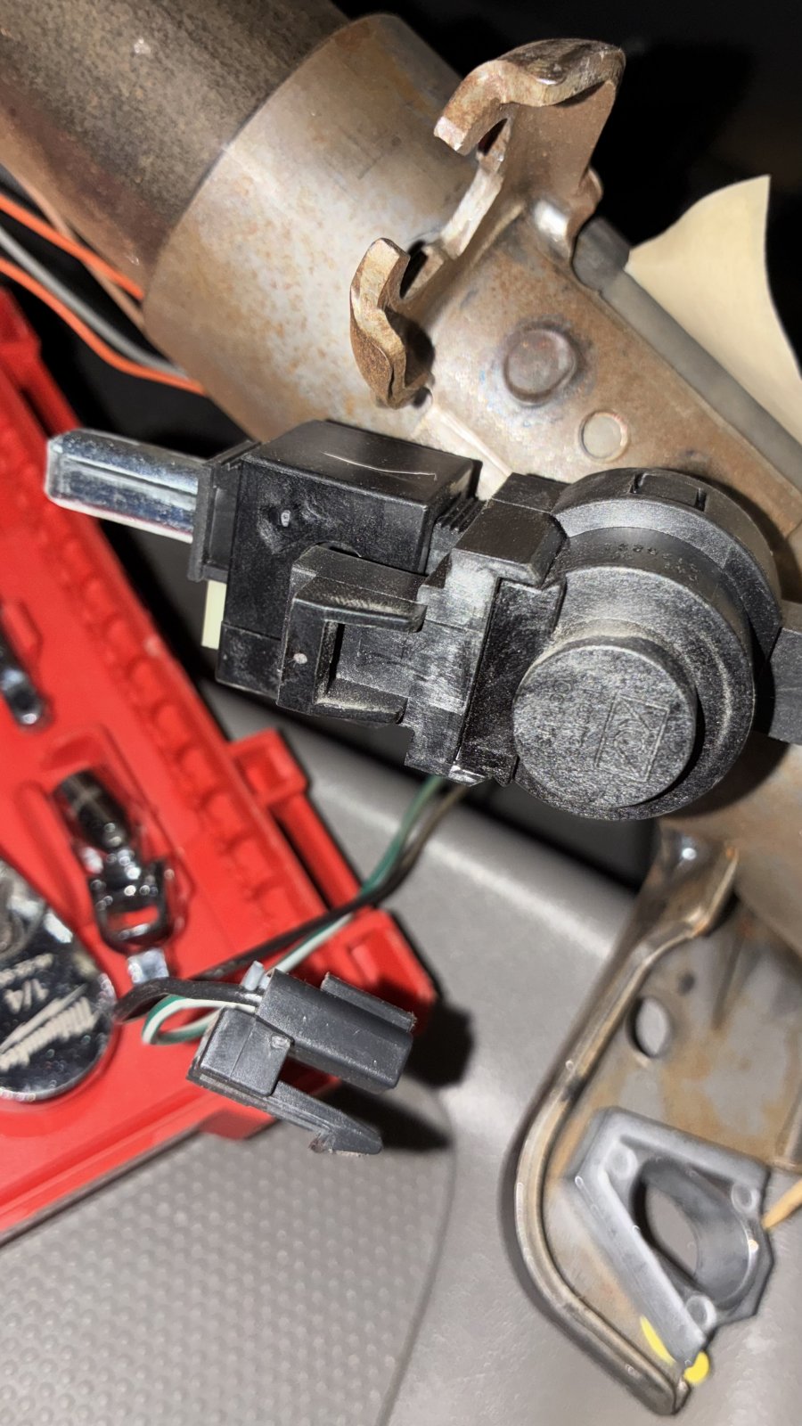

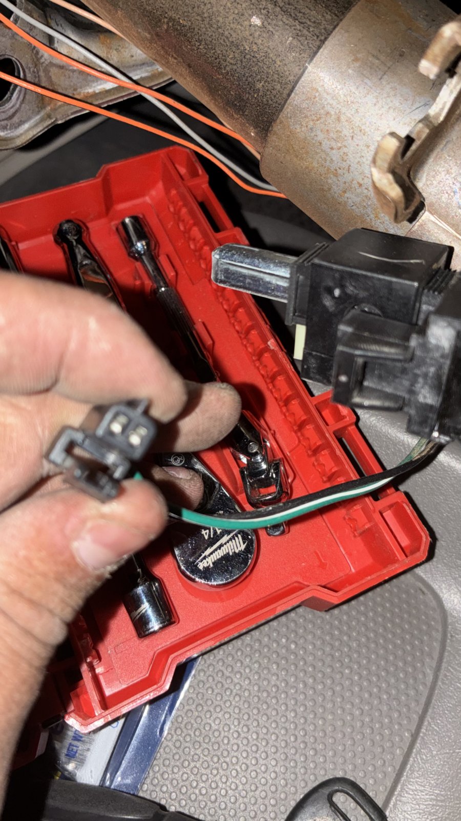

I need assistance. In the photos above show my old steering column. Anyways, I swapped it out because the mf was being weird and someone recommended to me to swap it. So i do just that. Now this wire in my fingers is from the old steering column but on the new one that wire, the prongs, broke and now my truck won’t shift out of reverse or neutral. (When I installed it, it wouldn’t go into park, well originally I said oh okay that’s fine. Because I can just put it in neutral and be fine) well I was wrong and now my truck may be cooked unless anyone has a better answer for me.
2002 Chevy Tahoe 4x4 5.3L V8
Edit: 11/2/2025
Yesterday I figured out the issue. So, one I installed the steering column incorrectly and had the shift wire incorrectly placed. So, I swapped the new upper wire and made sure to install it correctly. On top of that I didn’t hook up the plastic catch piece to the metal catch piece to add tension to the wire. Also I spliced the wire correctly from the old steering column.

Not really sure what you're asking but if you’re saying you can’t plug the connector together because the male end is broken, and that’s preventing you from shifting in/out and to/from park, neutral, etc….cut the connector off both sides and splice the wires directly together, color for color, If you need to extend the wires do so, Solder and tape and be done.
