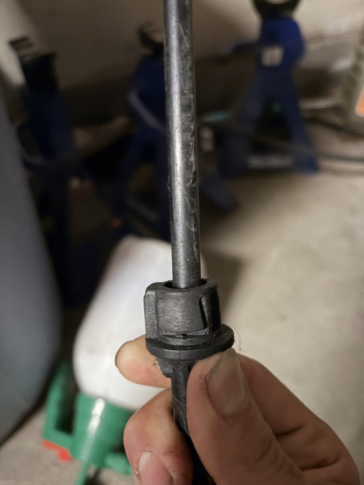

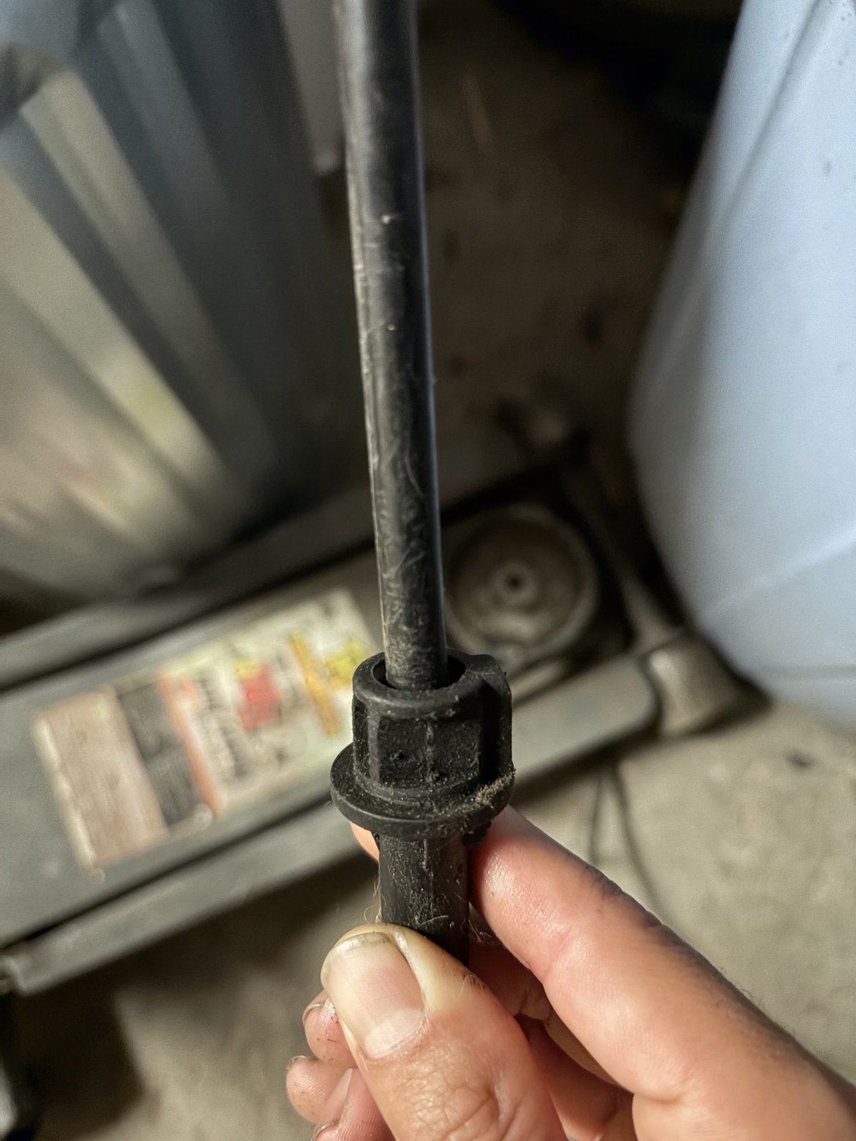

This little piece right here is what slides into the bracket under the column at the shift linkage and the locking tabs on either side expand and hold it into the bracket. Then the little metal u shaped clip slides into the slots behind the tab. This is my cable that broke, the first photo shows one side of the locking tab broken off and the second photo shows the tab intact. If those tabs aren’t locked into place along with u shaped clip securing it in, and the whole thing can slide in or out of the bracket, thats why the shift handle won’t actually move the linkage to shift int gear.
I have this connected correctly. I just don’t have the retainer clip in. But the shifter won’t move in or out of the truck. So the shifter was stuck before I got to this step. I figured that maybe it was because it needed tension to move. But that’s not the case. It’s like the shifter is just jammed into park. The shifter will however move back and forth. The indicator says I’m in “P”. Smh. Can a shifter just be stuck?
