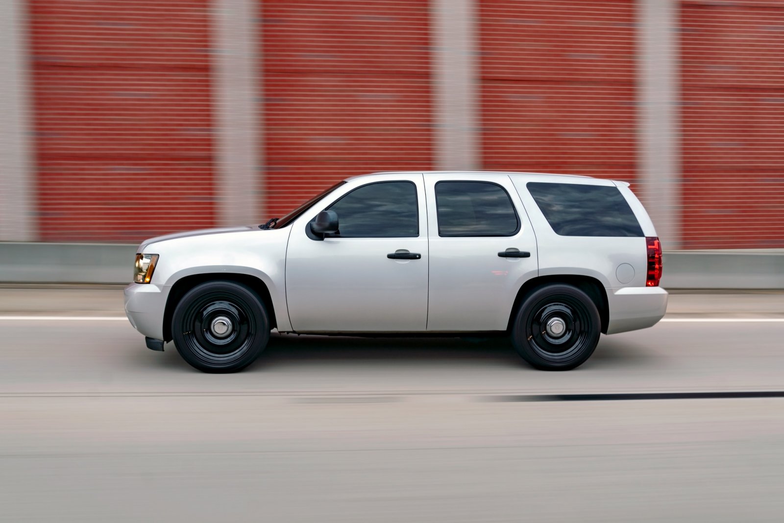

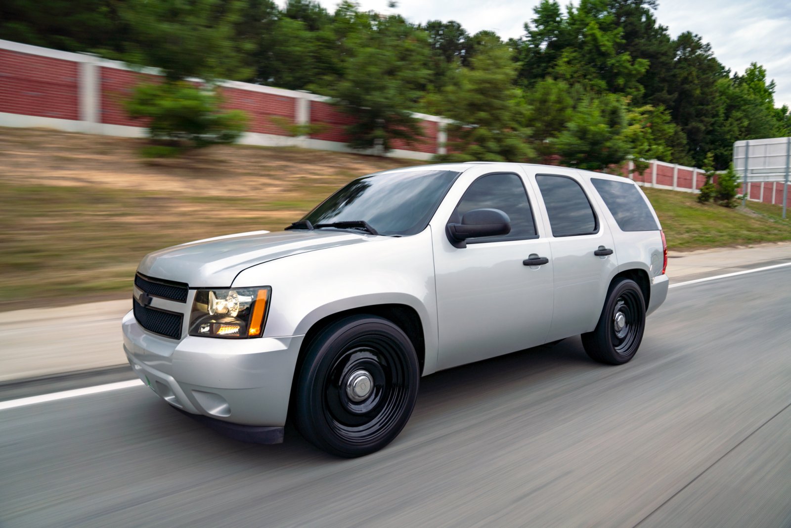

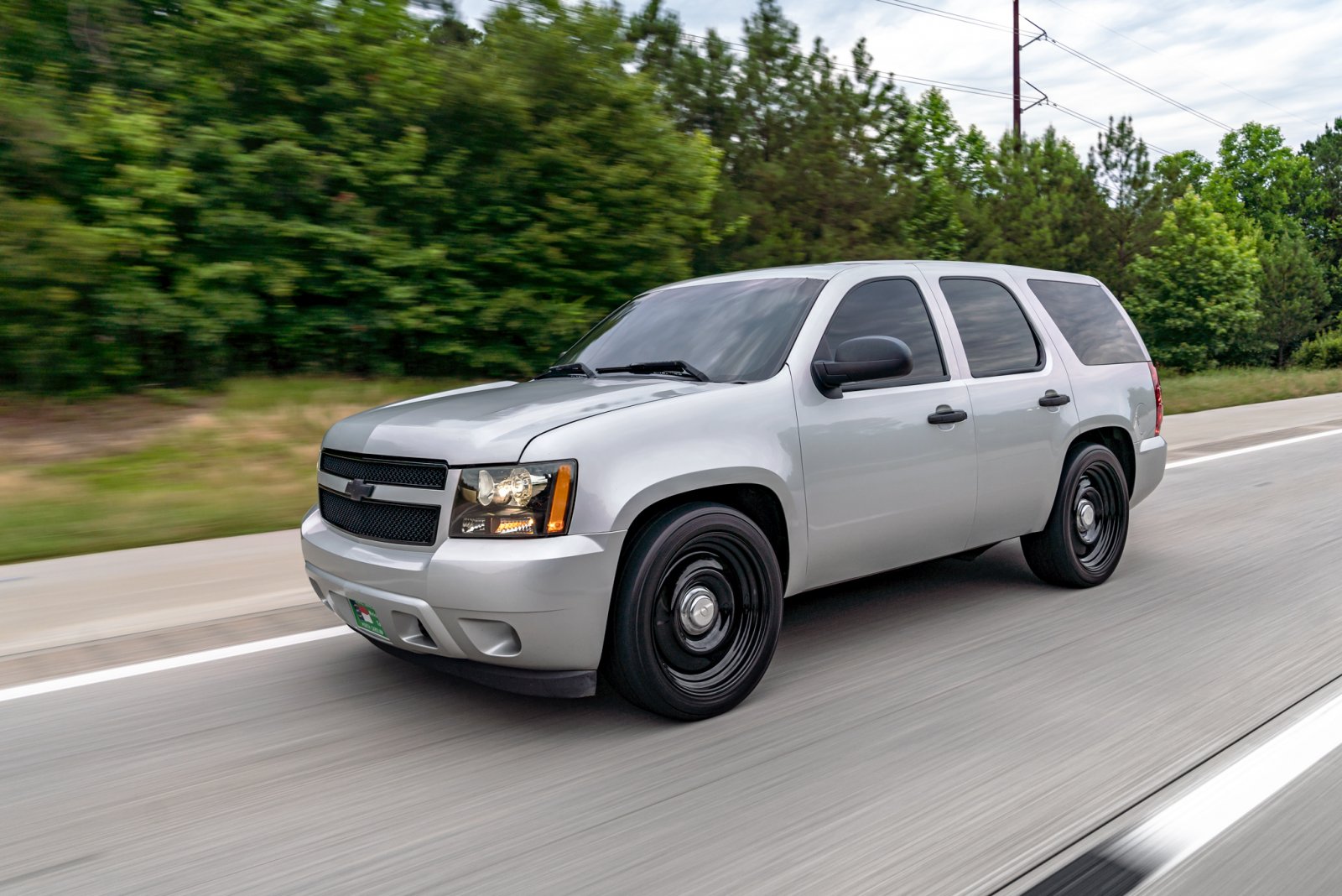

Nice rollers!
What camera gear?
I've only attempted rollers once and got some decent results.
A buddy did the rollers for me, I shoot antiquated DSLR stuff (with mirror)......I'm a Canon guy. For all my still shots, I am using a 1D Mark IV and primarily a Canon 100-400 L lens. For these rollers, Mike is a mirrorless Sony guy, I think......I'd have to check.

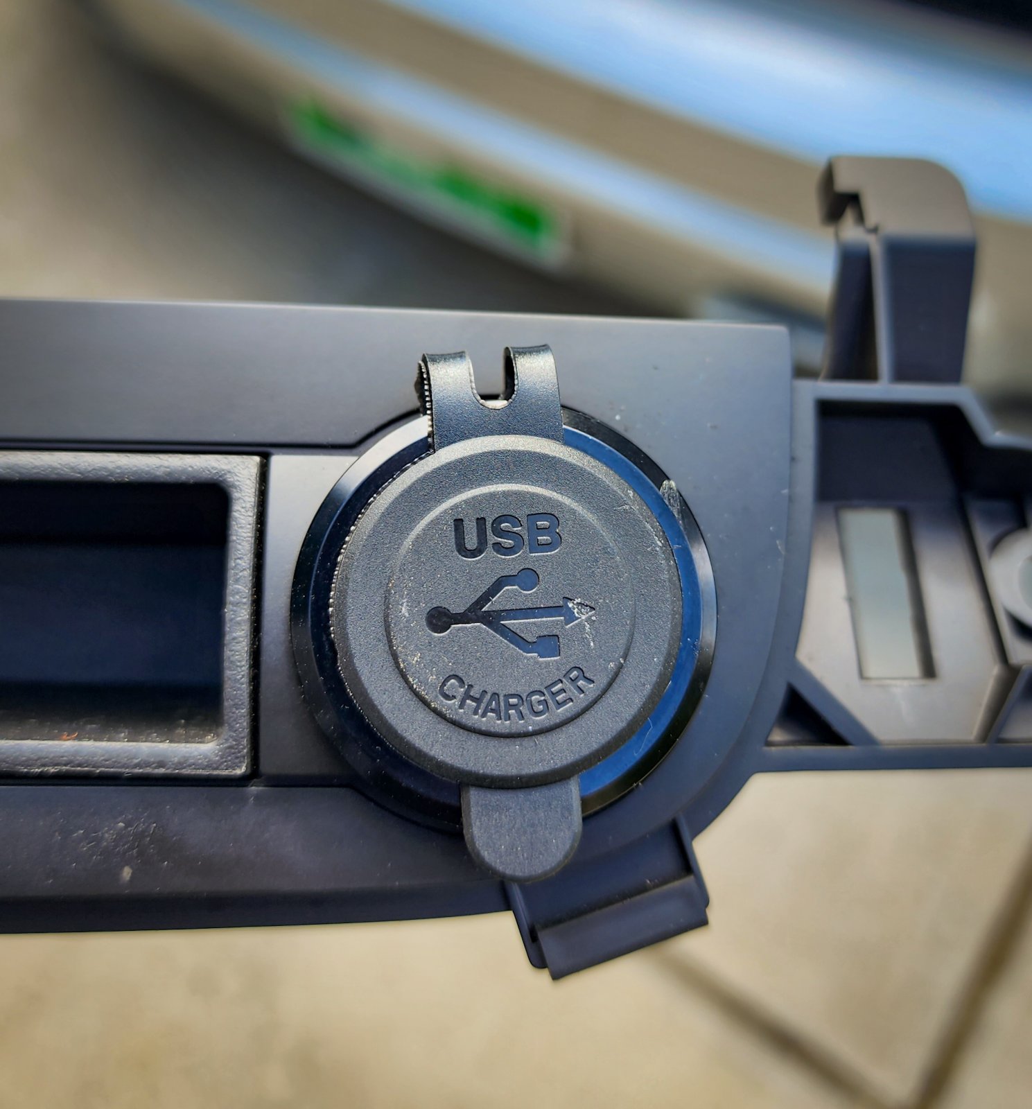

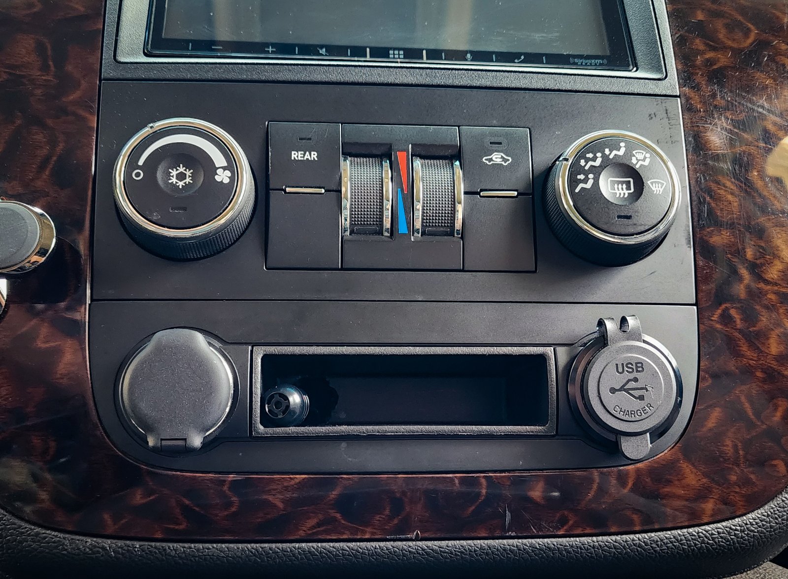

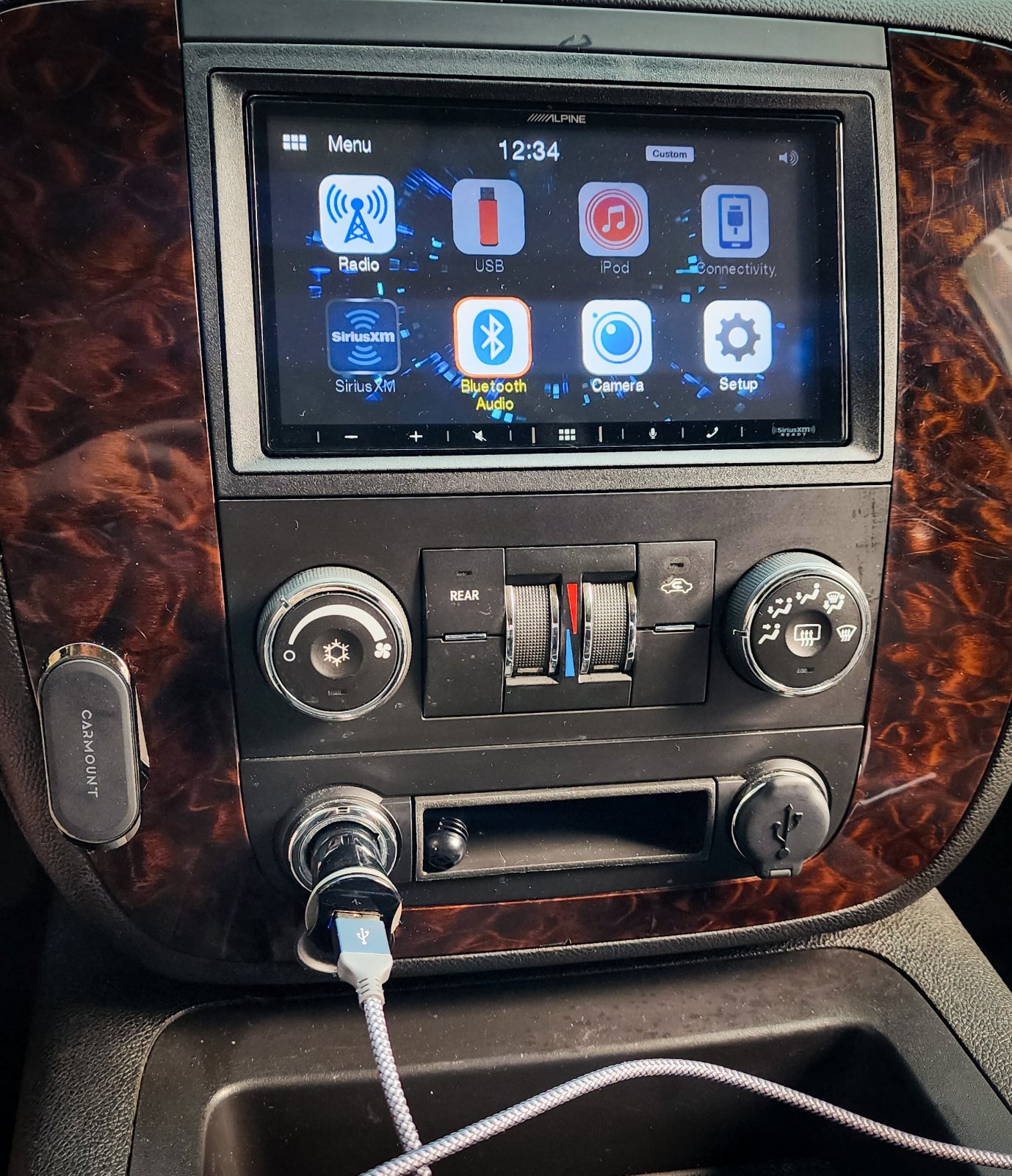

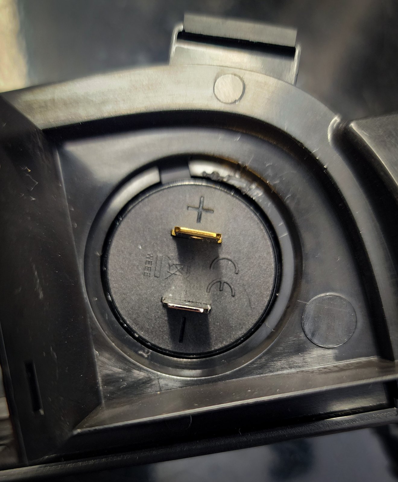

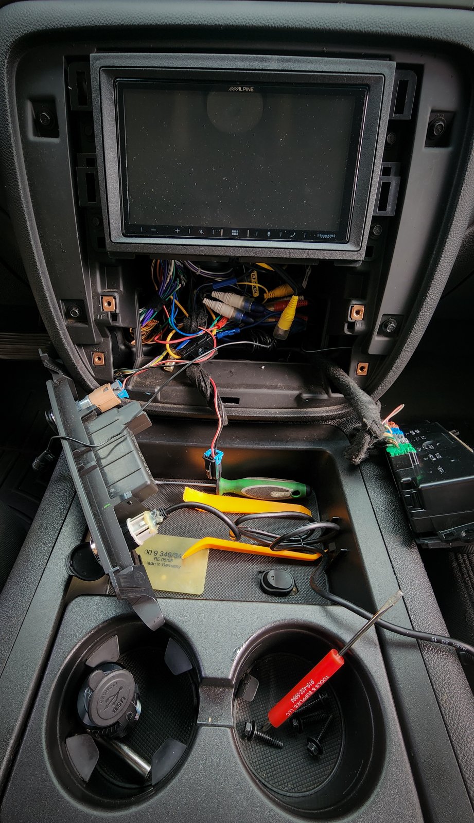

I went ahead and picked up the USB adapter that @vsp4717 mentioned, got it installed today. If y'all have read this thread so far, you know I like to photo document. Mainly so anyone else with less experience can see what it would take to do some of these things. This was pretty simple, honestly the hardest part of this was getting the faceplate trim out from around the radio (always fear scratching or cracking it). But it just takes some patience and a few pry tools to pop each fastener.
My setup prior to today: left was/is a traditional cigarette lighter socket, the right side was a USB into for AndroidAuto. That USB socket used to run directly into the back of my Alpine iLX-650 for that easy access to plug my phone in. Why Alpine put the socket on the back? Who TF knows. But I installed a Moto AndroidAuto wireless dongle in there and haven't looked back. Wireless AndroidAuto FTW.

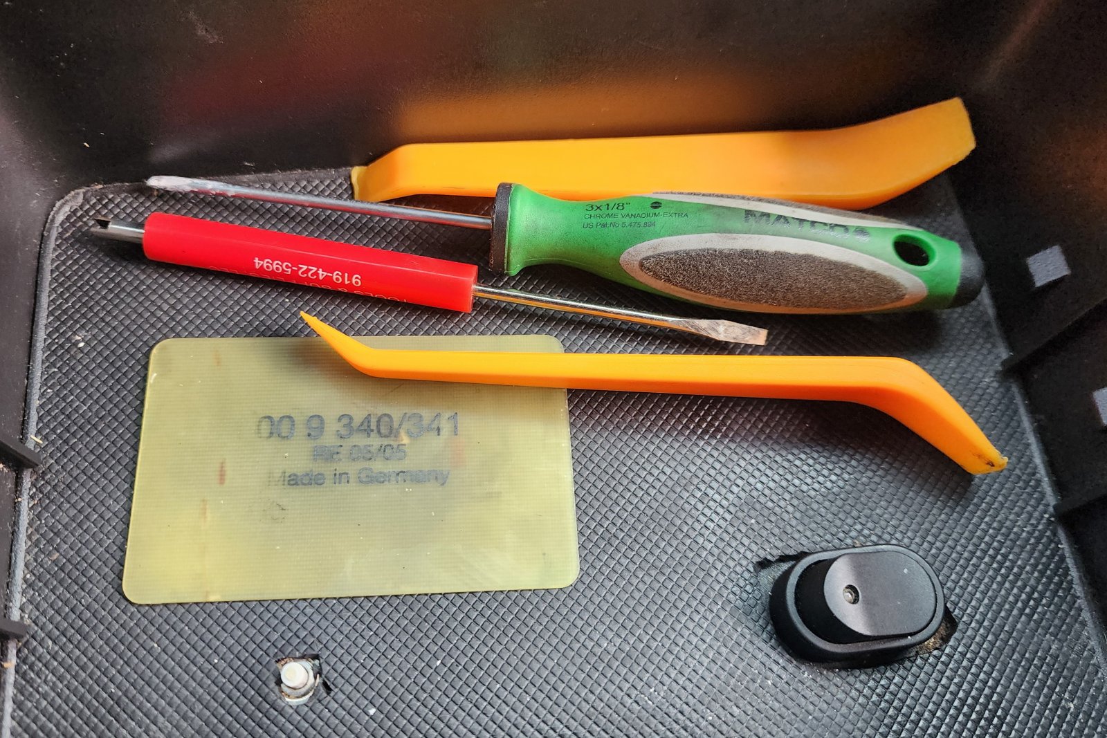

Gathered the tools I'd need to pop off the faceplate trim.
Faceplate off, HVAC and lower insert removed.

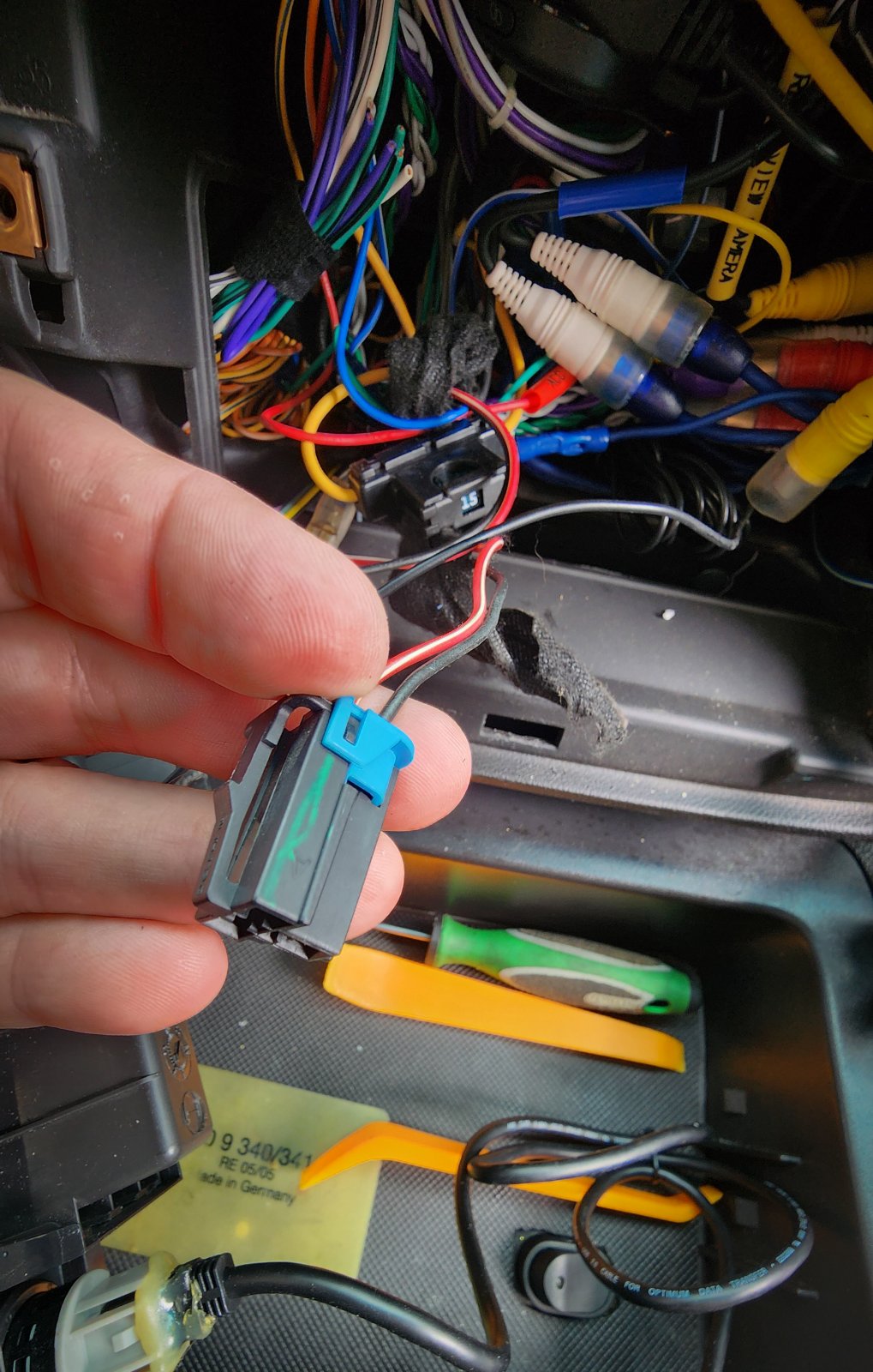

Located the power plug I removed from the passenger side cigarette lighter socket (where I installed the USB for the head unit).
Since it wasn't plug and play, it was a simple snip of the power/ground and some male spade connectors crimped in place. Plugged it in, KOEO, works great.

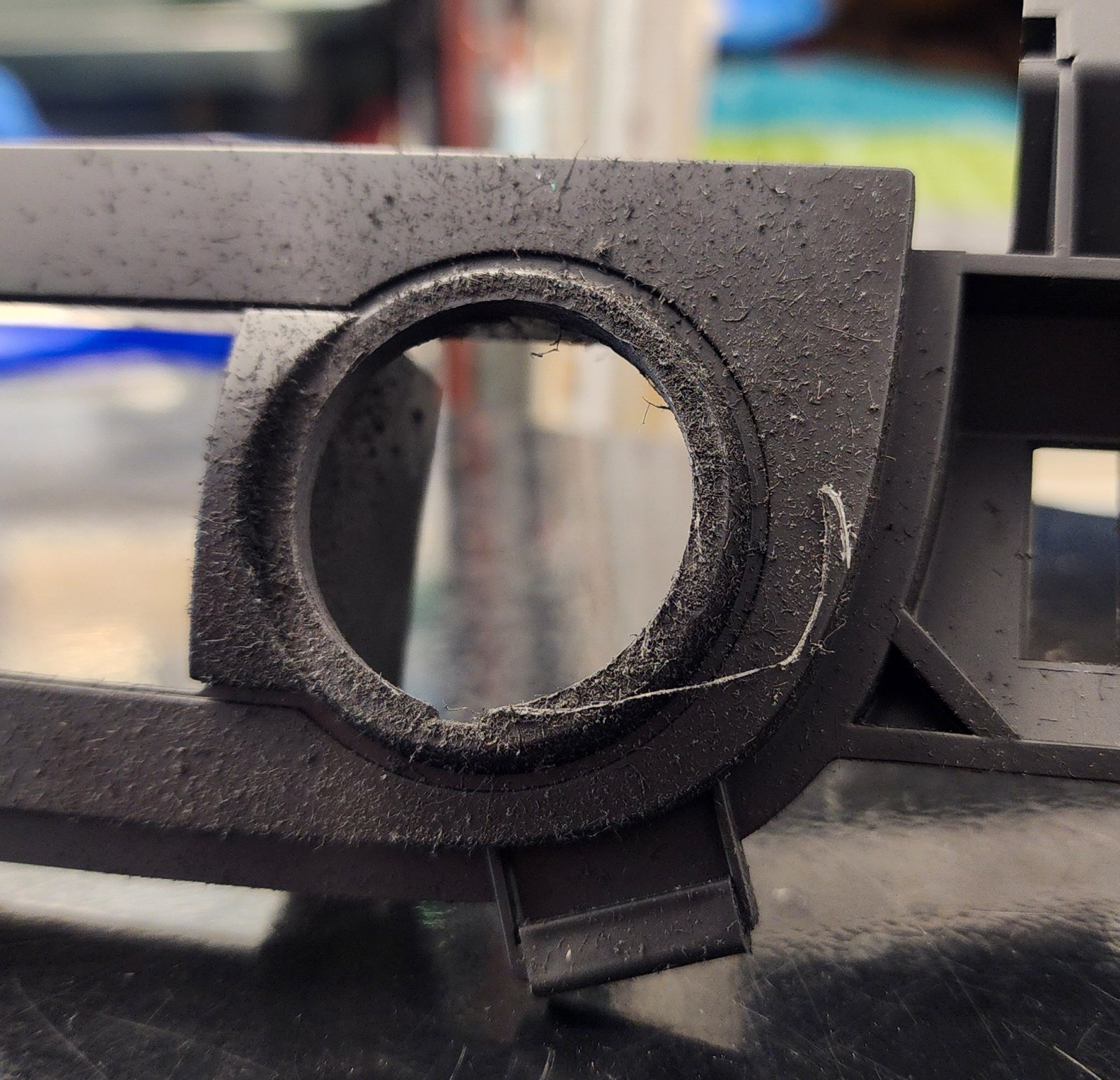

@vsp4717 was right, not much room was needed to get this socket to fit. In fact, if the factory faceplate was thinner, this USB hub would actually thread in. The barrel of the hub fits perfectly into the opening, here is the "just the tip" teaser.

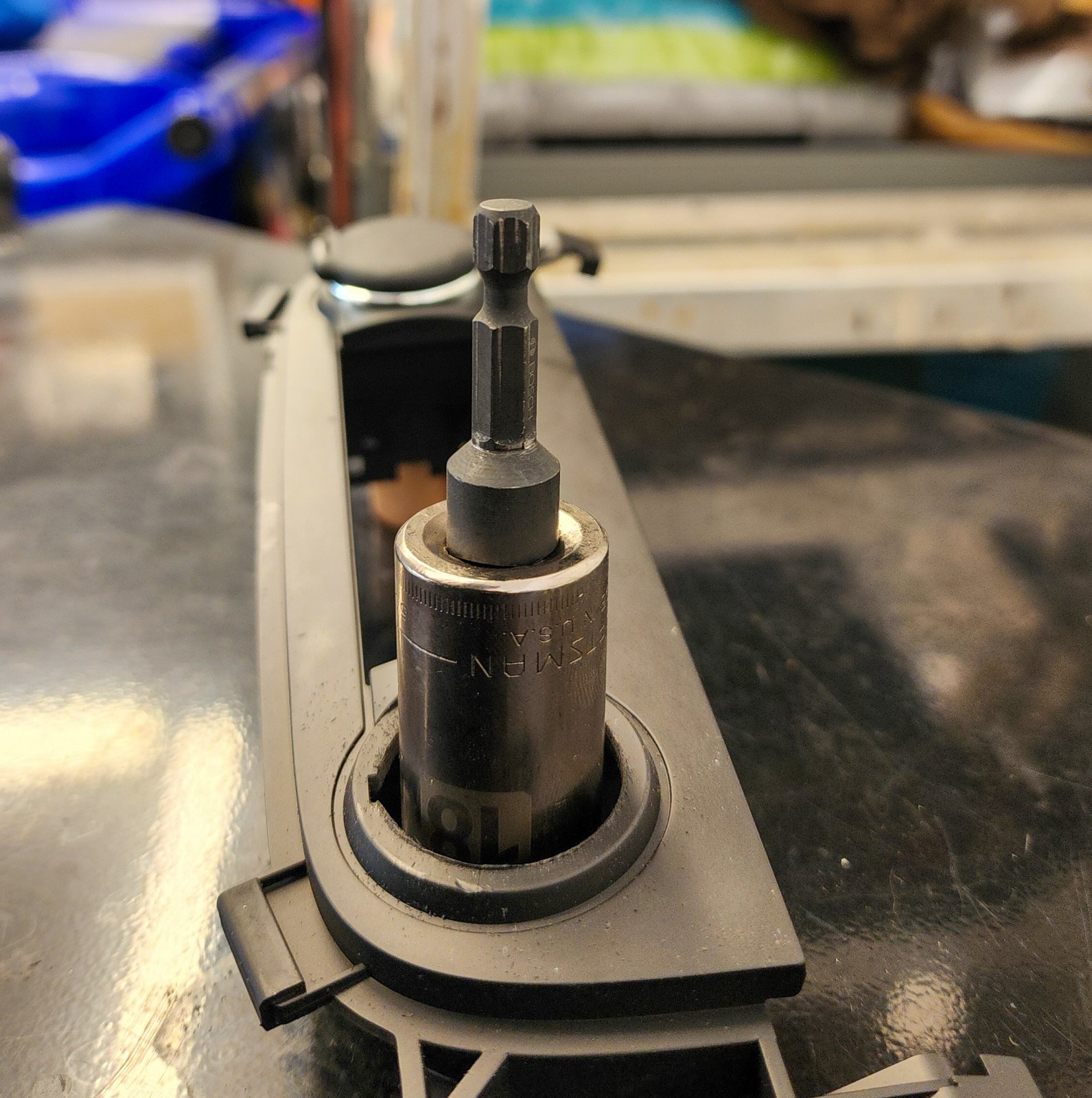

So, I had to come up with a way to gain more clearance and make sure to keep the socket opening 'round'. I found an 18mm socket would work great.
I had some sandpaper with velcro backing, for a sanding block. I grabbed some 80grit and wrapped the socket went to work. Normally I don't wrap it.....doesn't feel natural.
Here it is after I pulled out. Awwwww yeah......grab a rag.

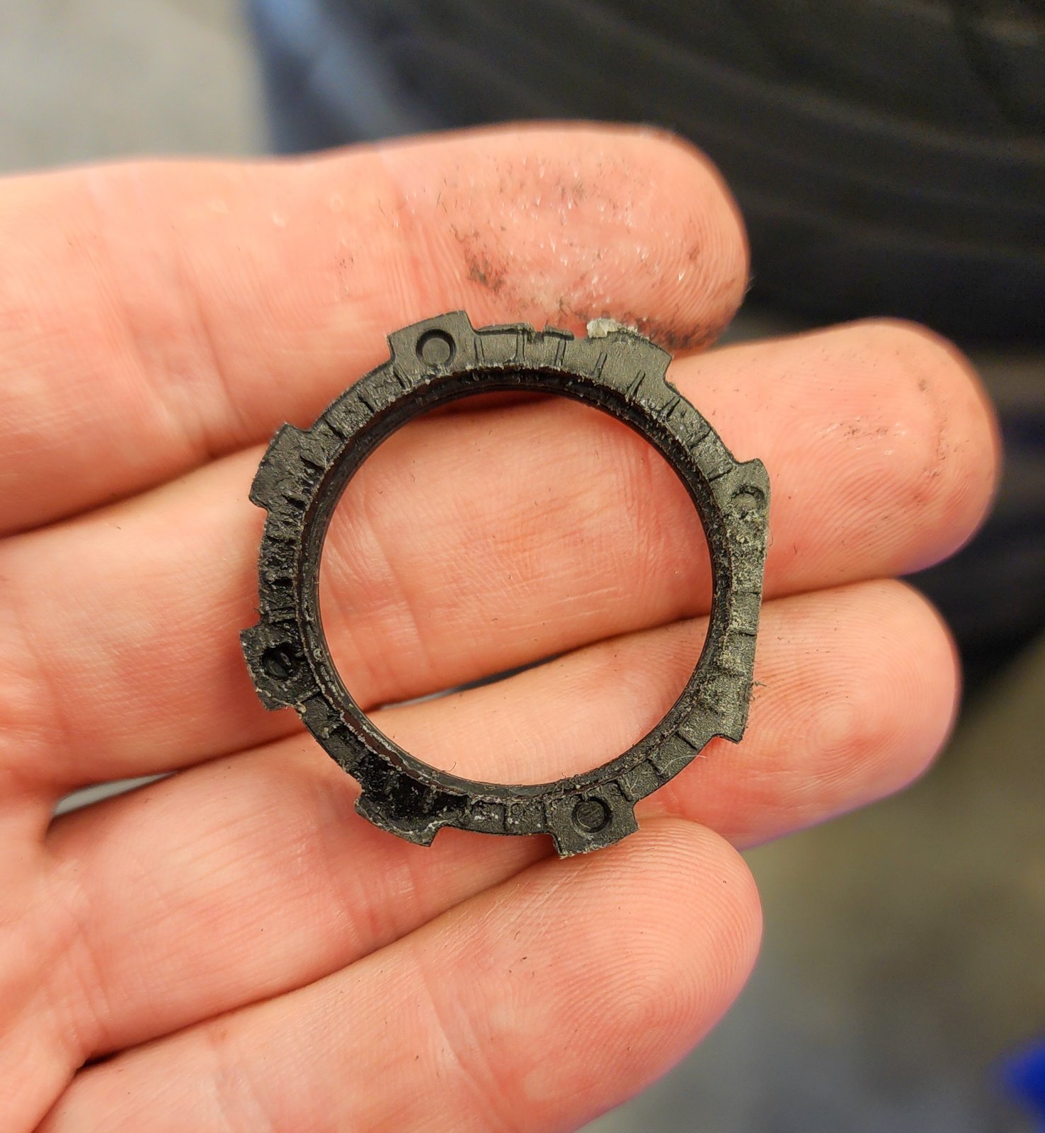

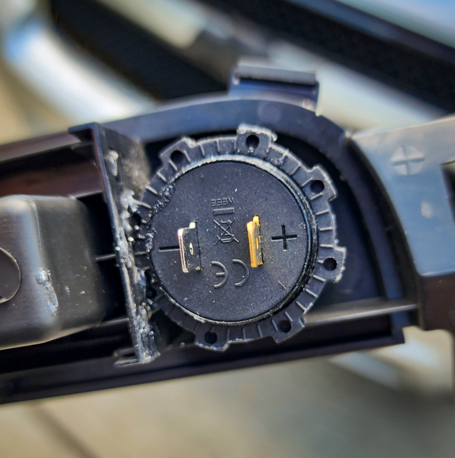

The socket came with a locking right you can thread on, but with the center pocket in that lower trim panel, there is no way it would fit on all the way. If you could get it on, it would certainly be crooked. And this USB socket won't sit "flat" on the face, unless you clearanced a little of the shoulder of the face itself. I didn't mind the ~2mm gap, since the rubber grommet/cover for the USB outlets sort of filled it.
So I test fit the socket, and determined I could sand off 2 of the knuckles on the retainer ring. I could still thread the ring on, but would have the sanded side butt against the center pocket. This would also give me a place to super glue the retaining ring to that center pocket.
