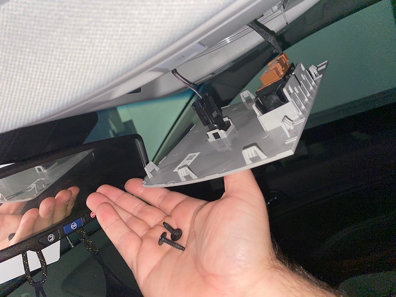

two phillips screws, not sure where they go. The overhead console does seem a bit loose now.

I just had the same issue, my wife and I were arguing what side the rolling sound is coming from in the dash. Luckily, after searching this forum and a few other sites we discovered the problem is in the overhead console. A screw or screws fall on the backside of the overhead console cover. Let down the sun glass holder and pry the rear clips loose and sure enough I had a screw in my overhead console cover. Problem solved. There are videos on how to remove the overhead console on a Tahoe which will show you how to pry the cover off.

Thank you, had one screw in mine.
I realize this is a REALLY old thread, but, I had something rolling around in my overhead console and it was a black Phillips head screw with a built in washer. I couldn't tell where it went, does anyone know? Thanks.
