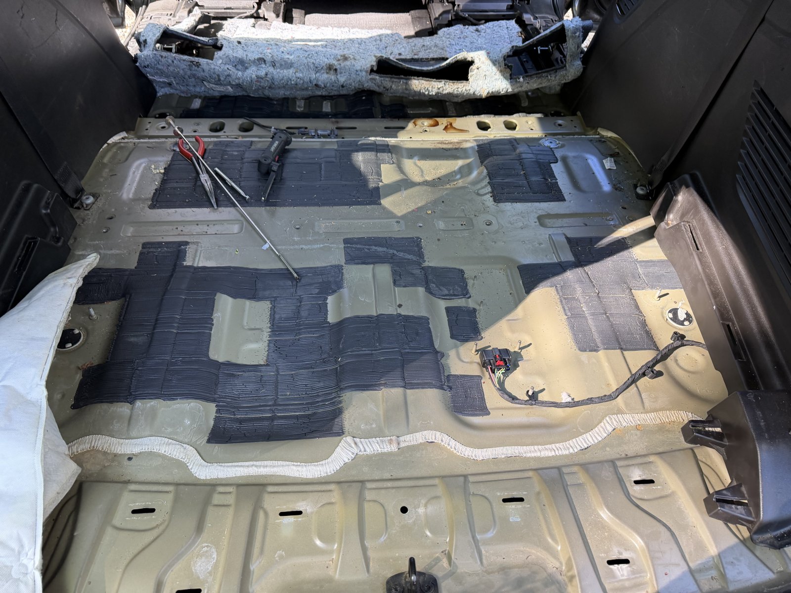

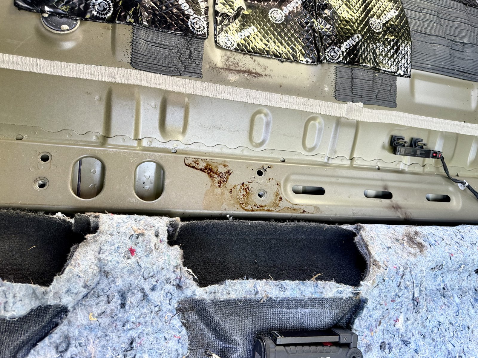

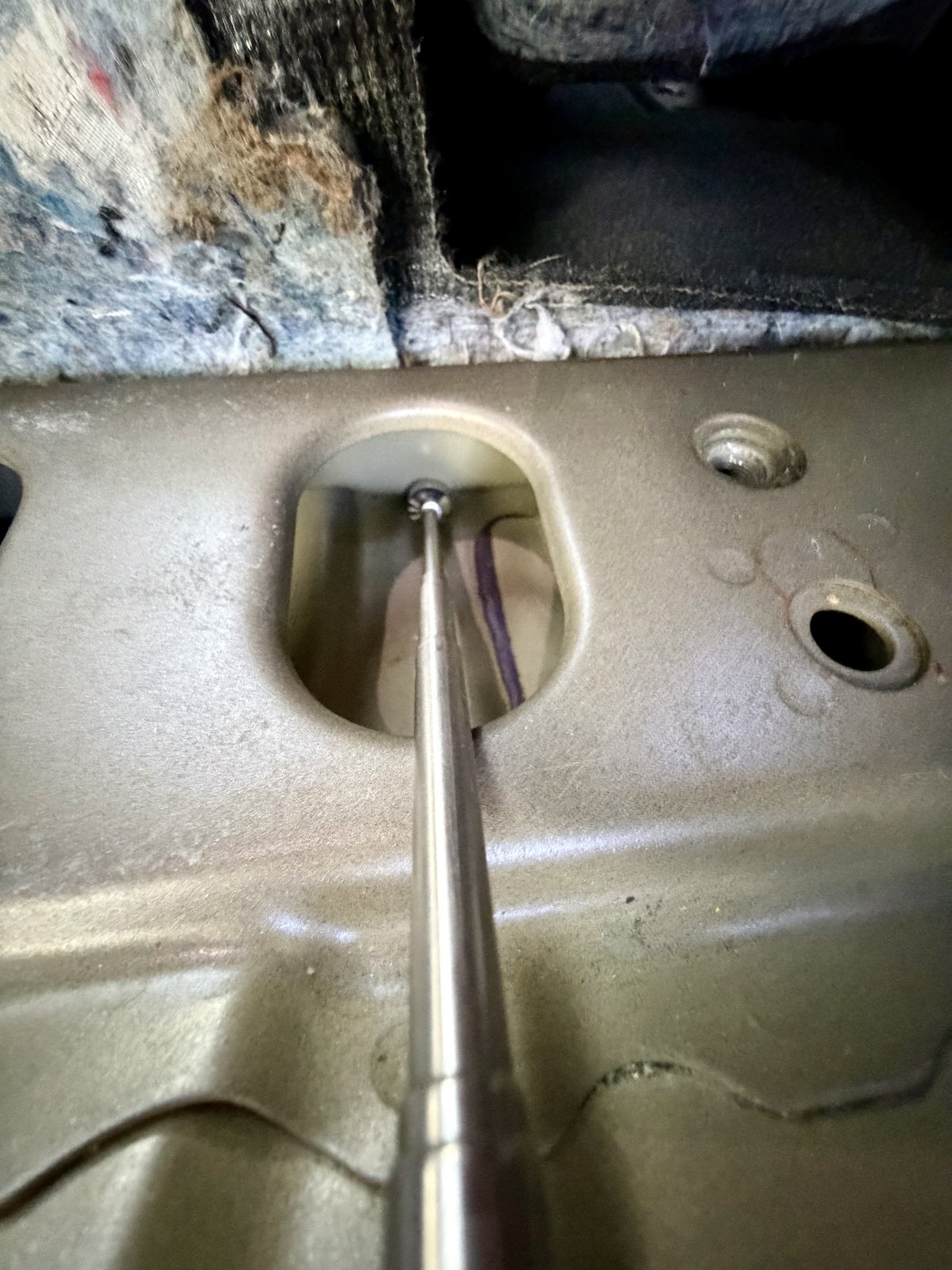

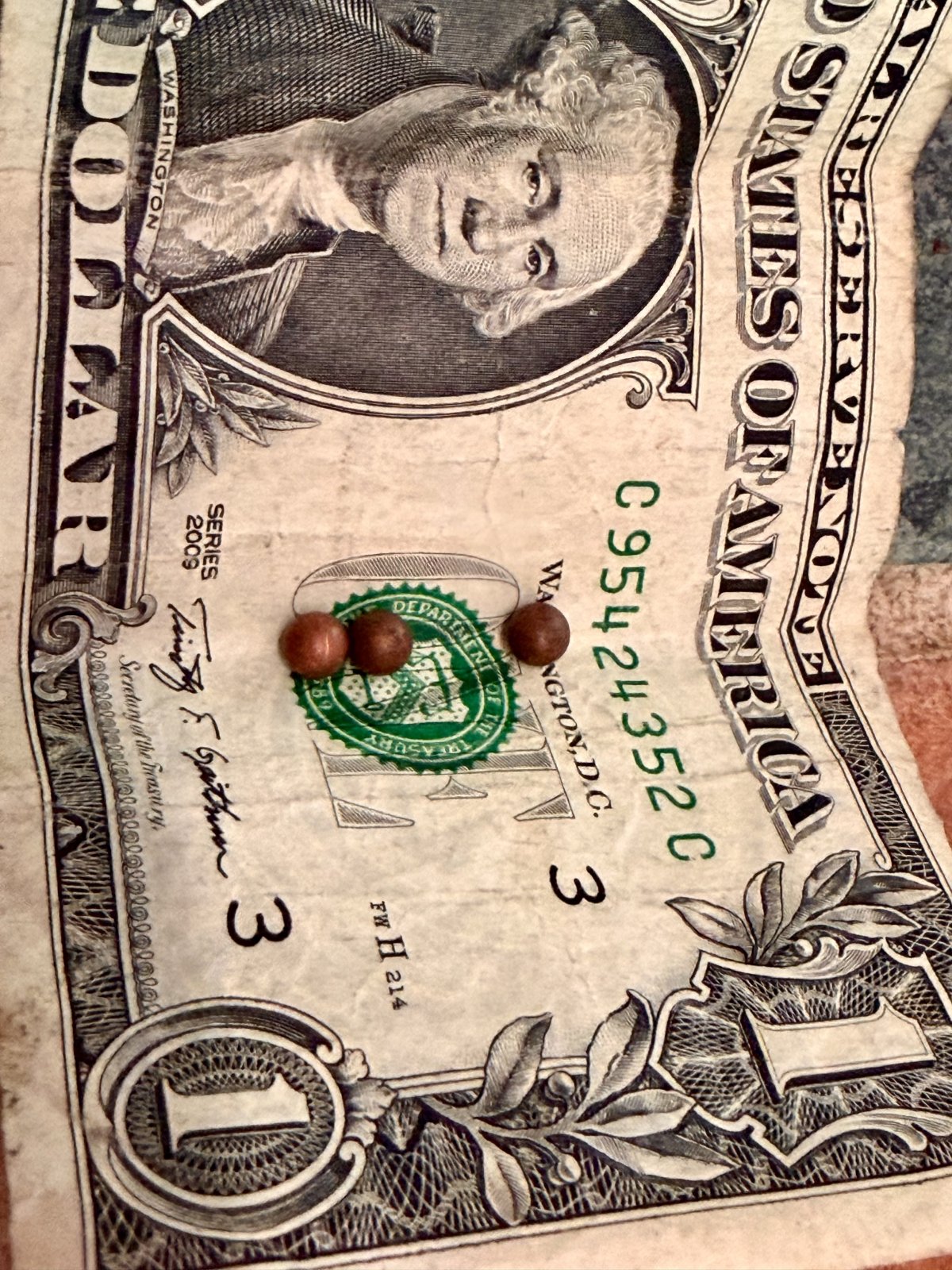

Finally got my noise figured out. Removed the third row seat and found BBs in this channel under the front third row seat mount. Couldn’t get to them with a tool as they had rolled into an area I couldn’t reach, so I put a magnet in there and made some S turns and they rolled right into the magnet. Noise is gone. Not sure how 3 BBs got in there but that horrible rolling noise is gone now.
