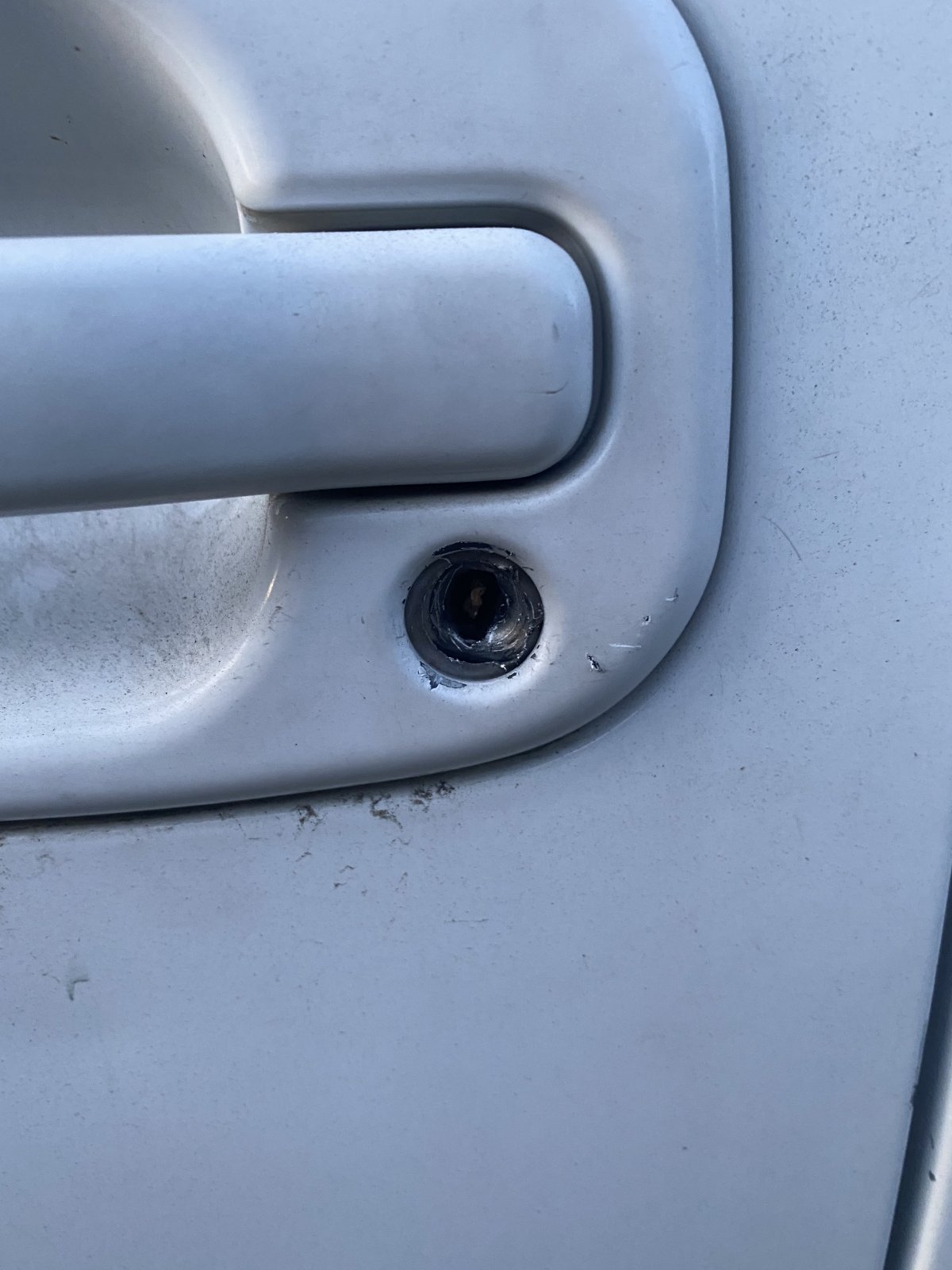

I was out of town and when I got back there was another surprise with the Yukon. Thieves broke the cylinder and broke off what looks like a house key in the lock. On this SLT Yukon only the drivers door has a key lock. Question: is it easy enough to get a GM tumbler/lock set, and key it to my existing original key?

For replacements... $80 - 100 on Rockauto.com (we get forum discount). Once you get the lock cylinder, you can have a local locksmith key it to your existing key. I don't think the locksmith would be terrible expensive.
GM will probably be more $.
If you have a deductible on your insurance, check the total cost for parts and locksmith. It might not be worth going through insurance in the end.

No kidding. They didn't realize that the door handle is all steel, not the plastic one, making it difficult to break the cylinder loose to access the linkage (at least i think that's how it's done). Would've been 30 seconds with an in the door slim jim, but they're not even aware of that. And the broken key is bizarre.
I'll definitely take advantage of the discount with rock auto. Thanks for the info.
if it is not broke off on the inside (happens often) then you can just grab one at the junkyard and any locksmith can re-key it (just take them the lock and your existing key) and then just install the new lock, there easy it's just a clip on & off, if it is broken on the inside then you need a new housing also.
the housing is plastic on the inside where the lock sit's that's why they pop it there because it's easy to break
Thank you for this explanation. It really helps. Much appreciated.
