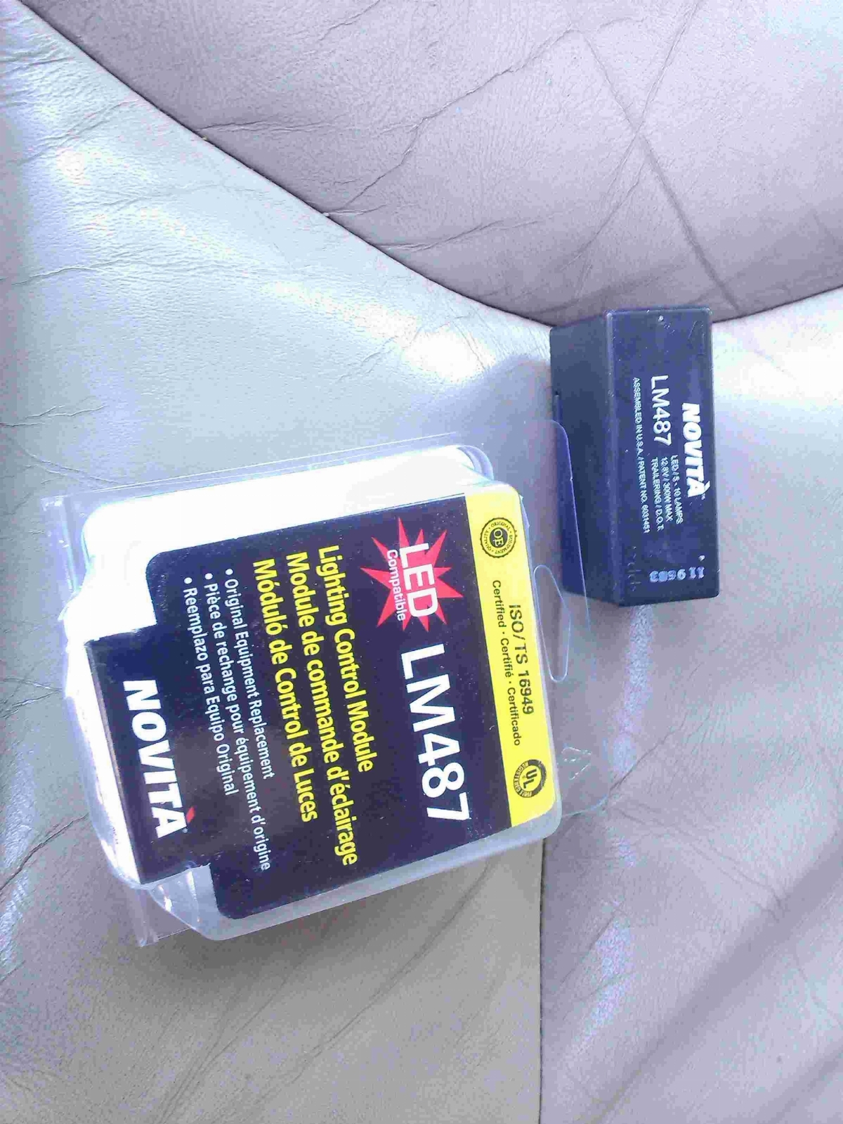

So I tried the resistor fix for the hyper blink, but still had the hyper blinking issue. So I went ahead and ordered the LM487, got it at a really good price for 20.00 brand new in the box. It did resolve the hyper blink issue, and like so many other have said is what I would recommend to fix the issue.

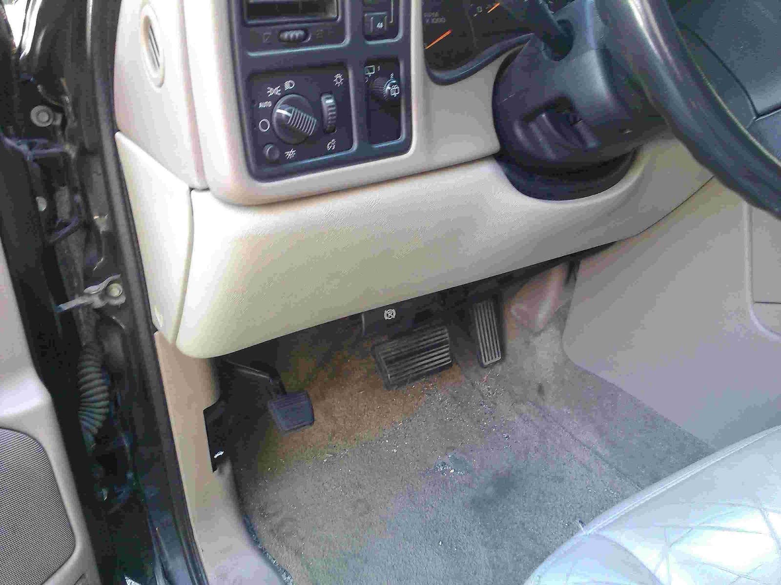

I bought this one :
Remove this panel (2 screws with hex head. 6 or 7 mm).
Unplug the blinker and replace with the new one :

Hi guys..
I've boughts LED bulbs for my turn signal/hazard few weeks ago.
When I replace even only 2 out of 4 bulbs I noticed that the turn signal was really fast though the hazard signal was still at normal speed.
To fix this I only had to replace the OEM thermal flasher which is set under the dash panel, with a Novita LM487 enectronic flasher.
I did the swap today and I tell you this works without adding any resistor : both hazard AND turn signal blinks at a normal rate.
