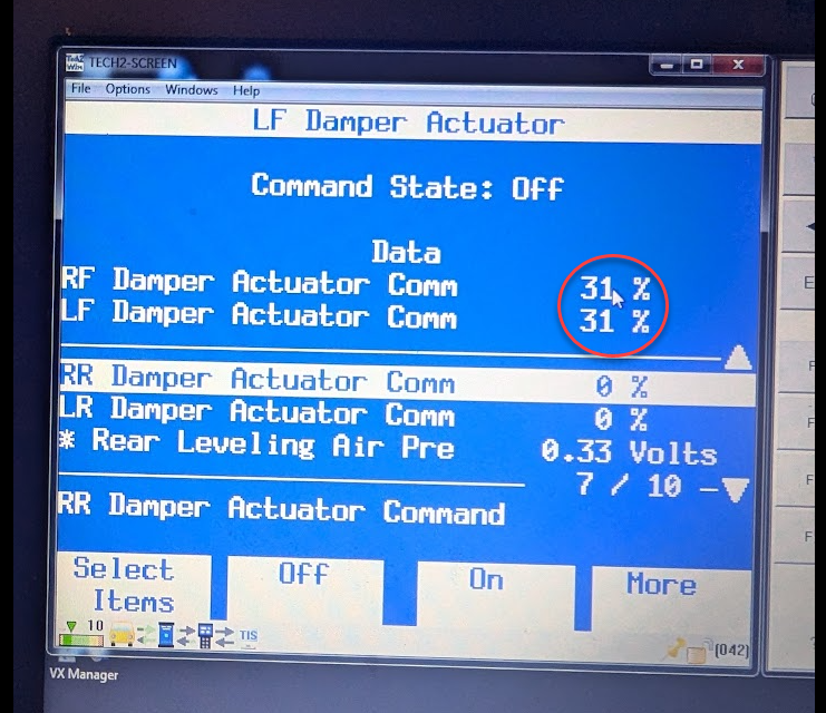

I've got a 2013 Escalade ESV. I bought it with the suspension completely crapped out. I replaced all 4 shocks and compressor. Because of this I'm at a bit of a loss for what the ride should have felt like before I replaced the suspension. My only comparison was my LX470 which rode much better. All parts are aftermarket TRQ. I did see that the springs are 6 coil with larger diameter steel, whereas the OE are 7 coil. The suspension does not ride as nice as I think it should. Noting that, I was wondering if there was a way to adjust it. I pulled out the trusty Tech2 and looking, I can see that the LF and RF Damper Actuator values are set to 31%, whereas the LR and RR set to 0%. This seems to me that it would be making the ride artificially more stiff. I looked around a bit but did not find a way to change the values.
Does anyone know if this is possible?

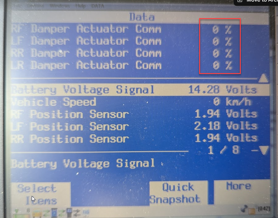

all mine are at 0% when not moving and % changes as I hit bumps. mines is oem stuff thou, so I don't know if your aftermarket brand is different.

As stated above, those number will change as you drive, if the system is set up correctly. Did you perform an Auto Level Control (ALC) reset after installing the aftermarket parts (can do this with your Tech 2)?
Keep your Tech 2 plugged in and take the truck for a drive and watch the real time data tracking feature. Are those numbers changing in real time as you navigate the turns and bumps in the road?

ALC calibration, it is under suspension, special functions. it will ask you if you have option z95 (yes) and if JL4 or not (built in trailer brake control)
empty the vehicle out
fill the gas tank
park on a level surface
open drivers window and use the tech2 while standing outside the vehicle
do the ALC calibration, only takes a minute to do.
bumpstop calibration probably won't do anything GM deleted that function due to premature wear on components.

FIXED!
I parked on a level surface and did the ALC calibration. After taking it for a drive I found that it was no better. LF RF still stated they were 31%
I parked again and did the ALC calibration again. Still no change. Finally, I did the Bump Stop calibration. 0% across the board. Got in and went for another test drive.
It finally rides like an Escalade should! No jarring potholes, it floats across the tarmac.
