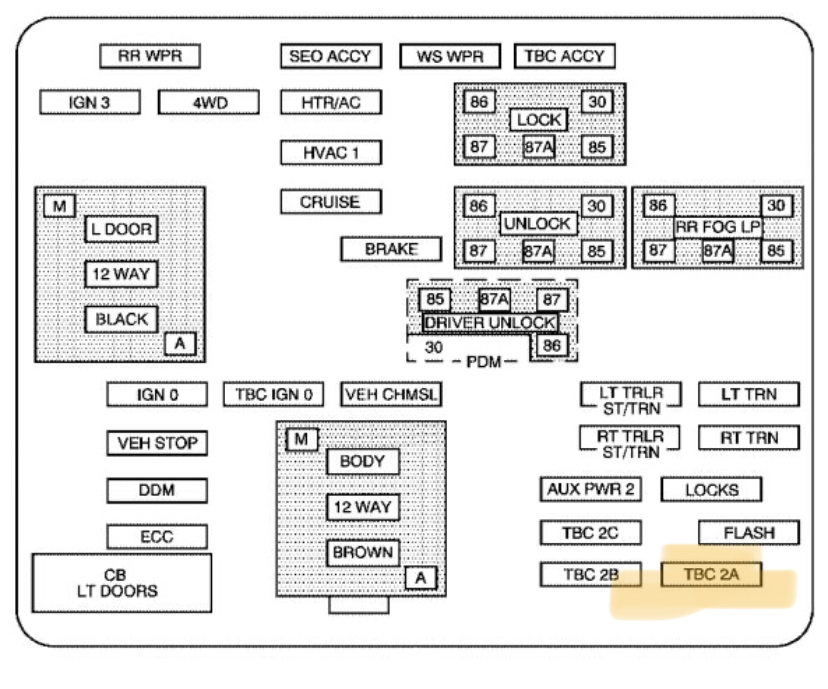

Hi All,
Last night driving home I noticed that all my dash lights went out. The cluster still working and the warning lights still work. The LED screen in the cluster and the HVAC still work so I think it’s the illumination circuit. Ive been looking and don’t see an illumination fuse. Is it tied in to the IP/DIC circuit?
I’ve also swapped in a known good headlight switch with no change.
cooki3mnster
cooki3mnster
May 24, 2021
114
169
I went back to the truck with a flashlight and pliers, started pulling fuses and found that “TBC 2A” 15a fuse was blown. This one is in the interior fuse block on the Drivers side of the dash. Swapped a new one in and we’re good to go. Adding a screen cap that has the fuse highlighted for anyone in the future.
