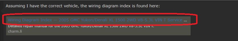

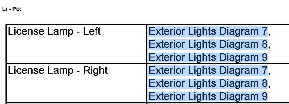

Assuming I have the correct vehicle, the wiring diagram index is found here:
Scroll down to the "License Lamp - Left" and the next block for the right-hand one, and look at the three diagrams (the highlighted diagrams are active links so you can click on each one). Each diagram is dependent on the applicable RPO code.
EDIT: you can check for voltage at the rear lighting junction block that's behind and above the RR wheel.

??? When I click it all I get is a larger version of the pic.
