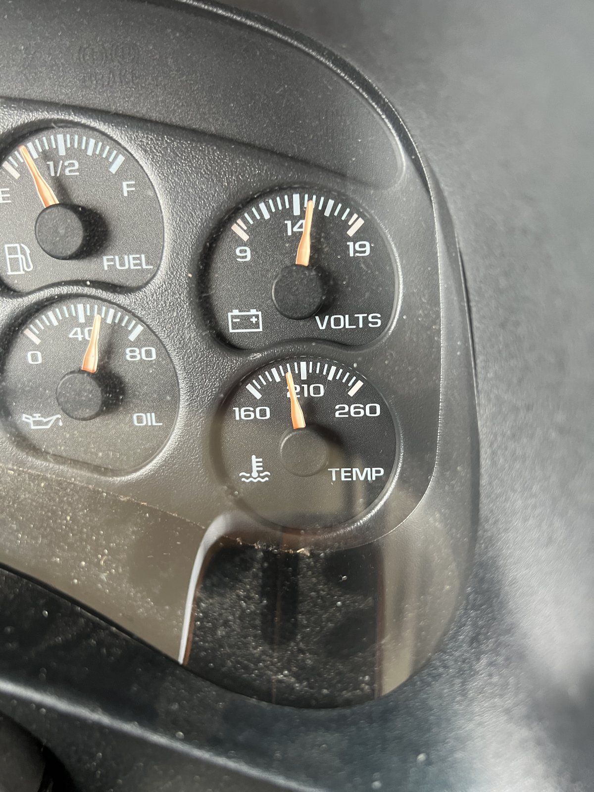

what do the temperature readings show when it is warmed up? does the temp gauge go to the center?

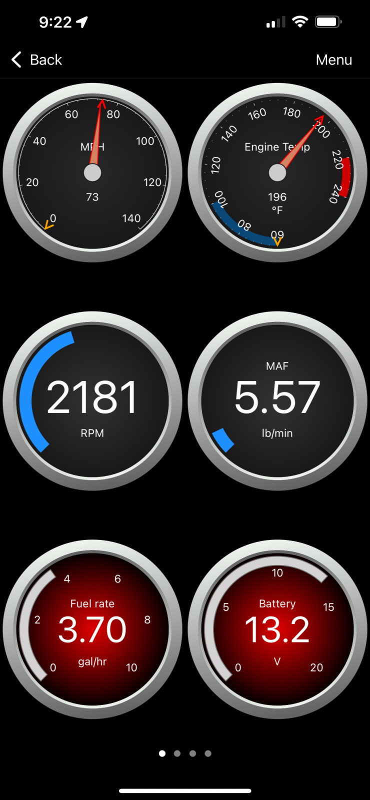

Always just shy of 210 other than when I was in 100 deg weather going up steep grades in Nevada/utah.
In my OBD 2 I do notice iratic swings on o2 sensor 1 60/70 down to 20 and below?

02 sensors do fluctuate a lot depending on rpm's, etc but if it seems out of sync with the other bank.
you could try swapping bank 1 & bank 2 and see if the behavior follows the sensor or if that is just how that bank behaves.

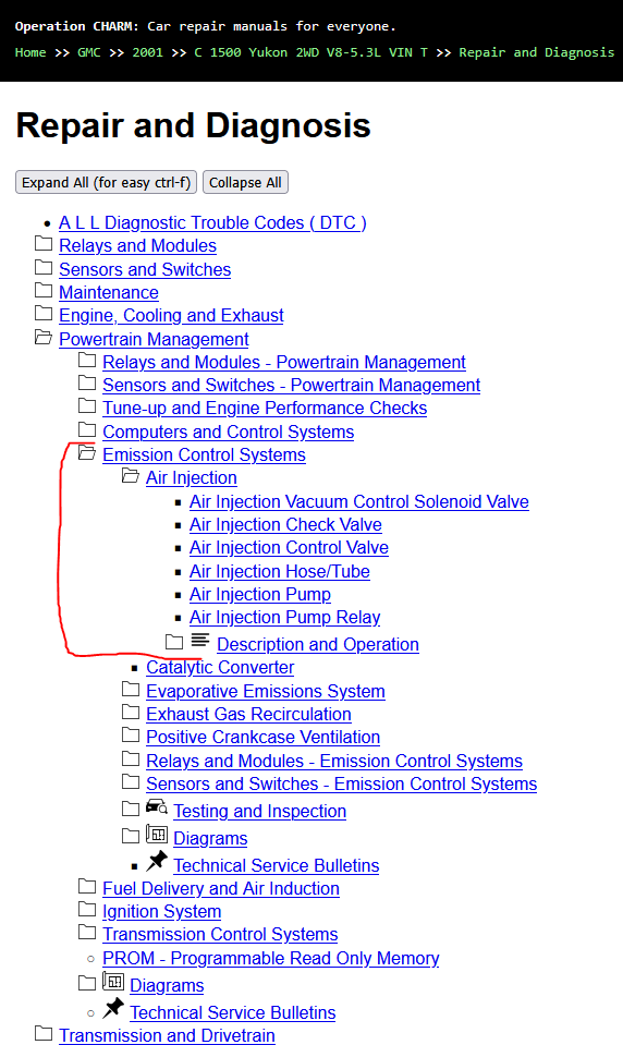

Dove into the link theres a lot of information in there! Did the I/M AIR System Set Procedure and still would not complete test, and dosnt throw a damn code!? in the past its thrown the p0410 but its so random and could be after 10k + miles and operation..
One bit in there says: If the diagnostic test does not run, observe the fuel trim correction. If the fuel trim correction is more than plus or minus 4 percent, the AIR System Test may not run. If the status does not update, the test outlined in this procedure can be repeated until the I/M System Status updates to YES.
Im not sure if my OBD tool reads fuel trim, what should fuel trim be?
What about throwing a new pump relay at it? i guess at this point i just need to start throwing parts at it.. those check valves seem like a real pain to get off.. buddy said theres no blow back but they could be clogged on other side?
