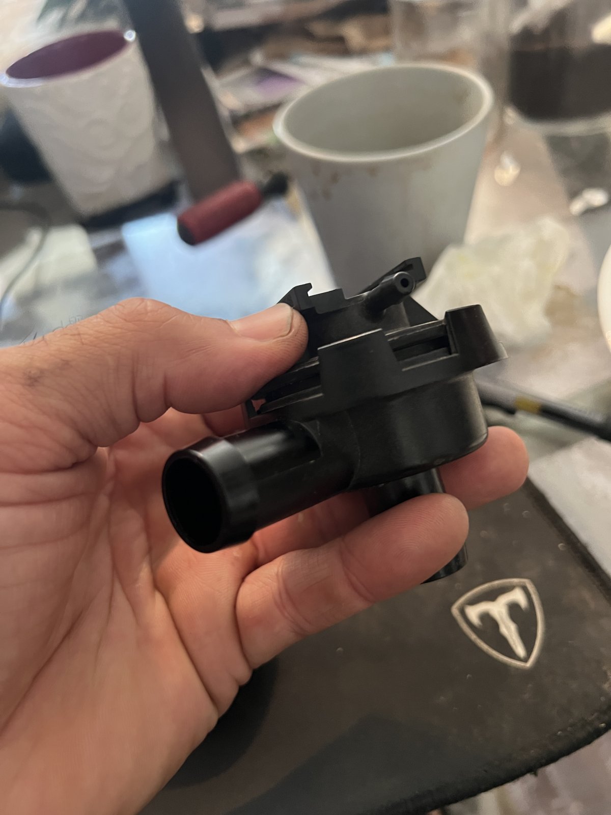

I’ve got my check valve out that’s after the pump, could it be stuck closed? When I blow into it from pump inlet it does not blow through how does this thing open? I can press it up from bottom and create flow- got it opened up just a spring and orange gasket.. def has a little debri around gasket lip.. cleaned but once reassembled still no flow I can’t imagine my pump is blowing harder than I can with pressure..

I’ve got my check valve out that’s after the pump, could it be stuck closed? When I blow into it from pump inlet it does not blow through how does this thing open? I can press it up from bottom and create flow- got it opened up just a spring and orange gasket.. could I run it without gasket to get this thing to pass?
not sure, but that valve looks like it is vacuum activated, so suction on the small line would allow it to open and let pump air in thru the larger pipe, trying to blow thru the larger pipe likely wouldn't do anything unless the valve is vacuumed open
so you would need to connect it to a vacuum line and then try to blow thru it.
there is a tool to test (mighty vac) it's but not worth running out to get one, you should be able to connect to the line that was on it or the one that goes from the air intake to the intake with the engine running. if it has enough vacuum.

Ok ran it without little vacume hose before i saw your reply and very little flow was coming through valve from pump, attached small vacume line from engine to valve and it flowed much better. Would that confirm that my solinoid is functioning to allow vacume from small line? Will try running it it for awhile it was pretty dirty around gasket inside
