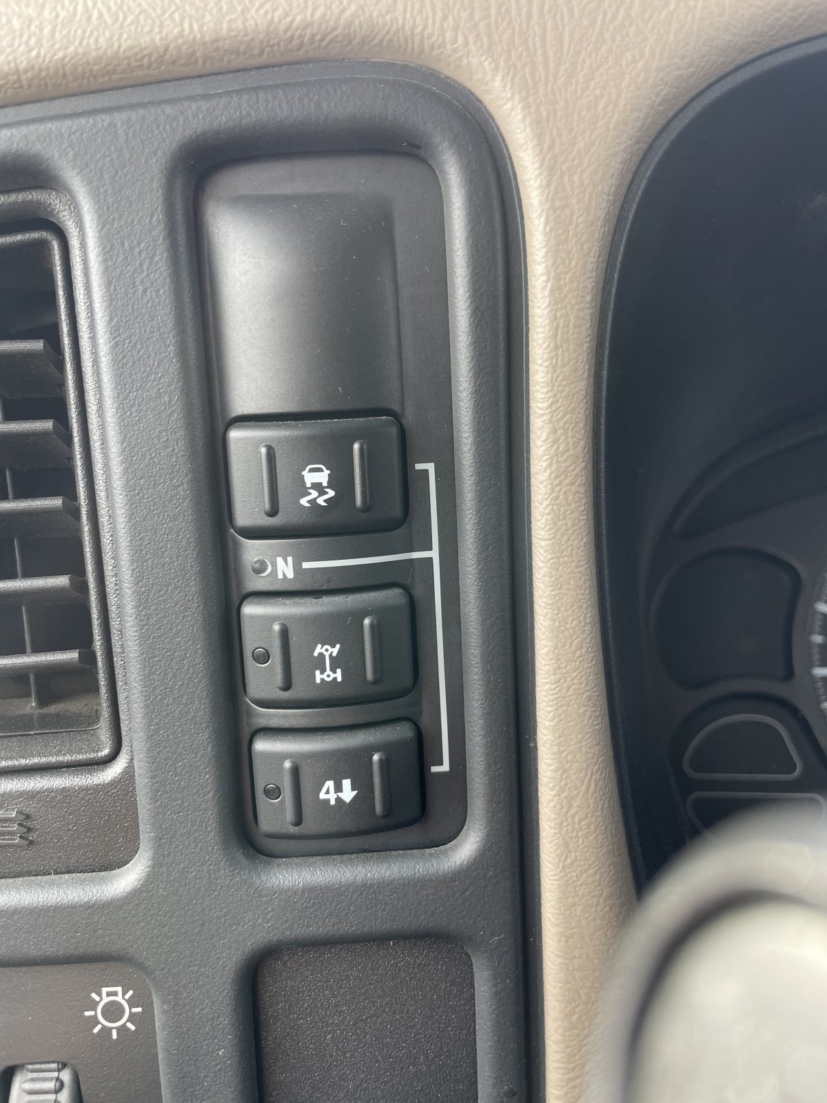

AWD, or 2-speed 4wd transfer case? Pic of dash switch for 4wd modes?
It’s a BorgWarner 4485 transfer case. These are my switches
I will have my shop check this out. Thank you for the additional insight and your expertise!
I forgot about this case. It was in a youtubers Yukon xl that he put a turbo on. Yeah it died because he didnt know it was awd and he did a few pulls on a 2wd dyno.
I do not have a file to check to see if it is different from a regular 4x4 case vehicle, but I would think they are the same for shift timing
