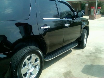

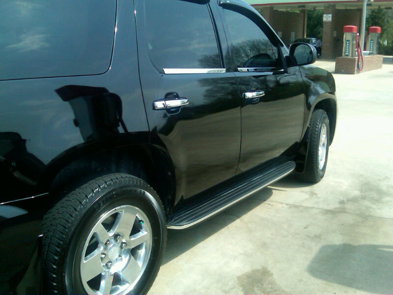

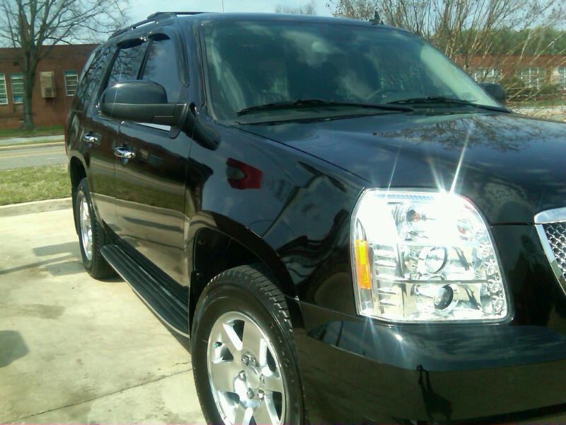

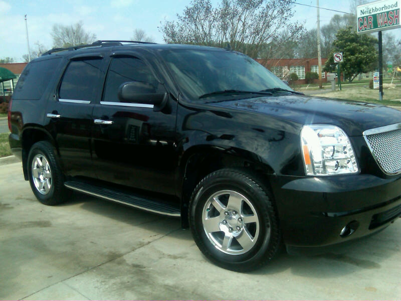

Been thinking about doing this for awhile. Finally did it yesterday and snapped some pics after I cleaned it up.

Nice. I will be doing it within the next couple of weeks. What method did you use to take them off?
Pretty simple...a hairdryer to heat the moldings up enough to pull them off, then 3m adhesive remover for the leftover adhesive. Follow it up with a good buffing and done! Took about an hour.
