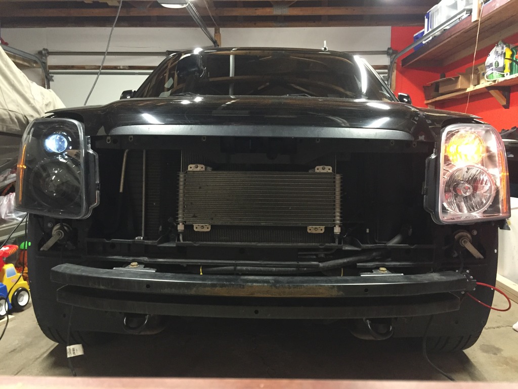

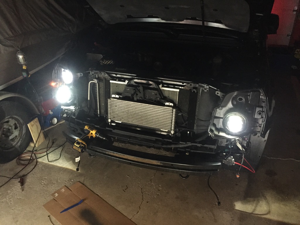

BTW...got some progress last night...took the bumper off...

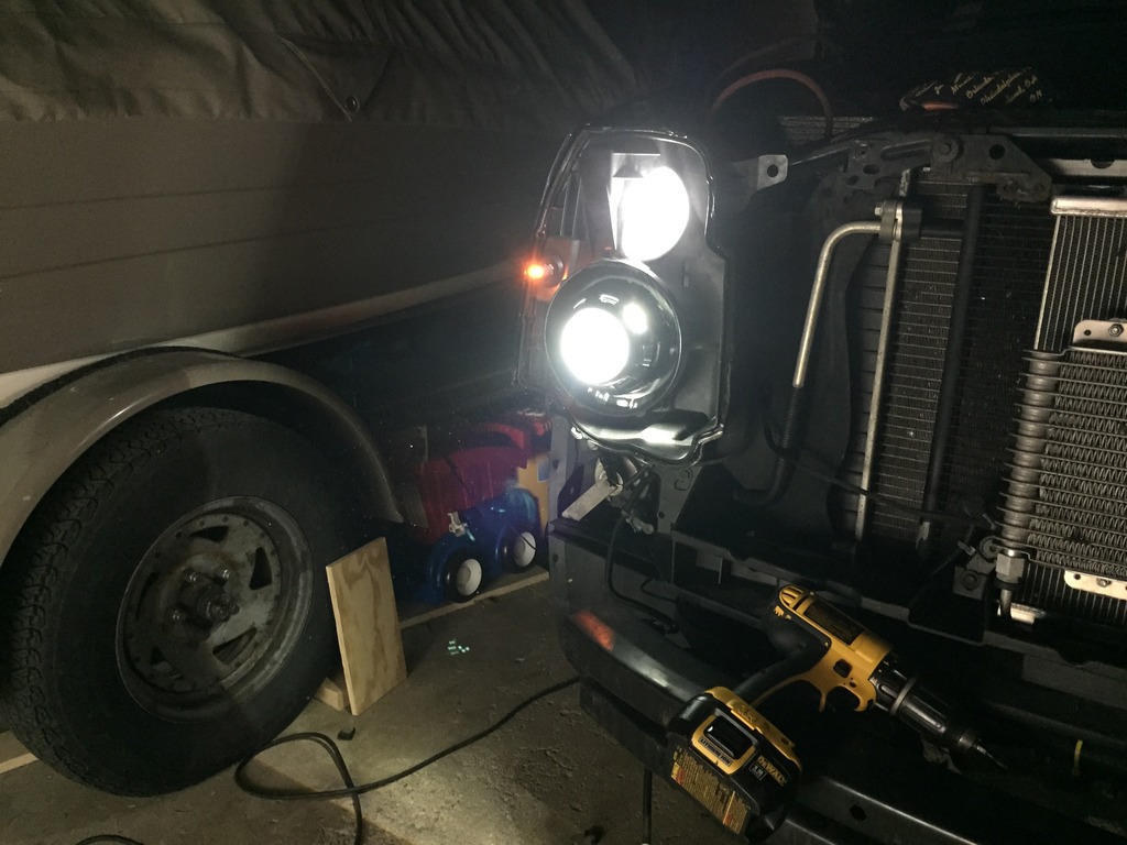

A little test fit...front lens isnt sealed yet and its not wired yet...i was just playing with the turn signals

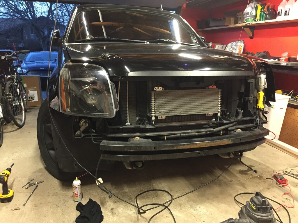

And man i hate MI winters...all the salt must have collected between the bumper and the fender there on the corner...you can see a little paint chipping off as i took the bumper off there on the pass corner...gotta take care of that ASAP...man was i pissed...two fo the bolts snapped off too...had to heat them up and vice grip them out...
anyways...here is a little video of the turn signal switch backs...
this is using the hazards...i have to use the resistors to prevent the hyperflash when using turns... need to get the wiring schematics out to see which one of the three wires in the signal pigtail is for turn signal itself.

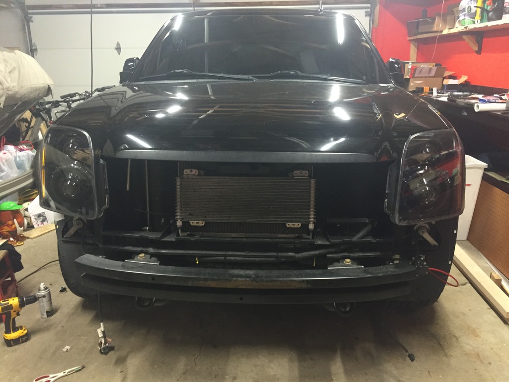

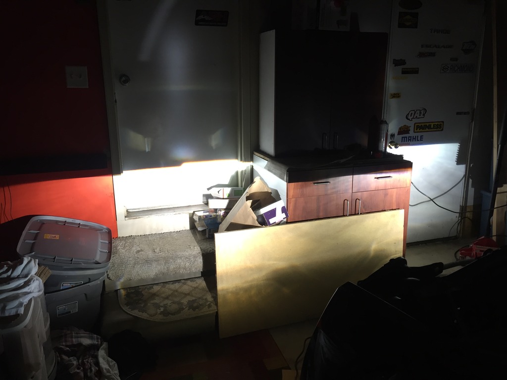

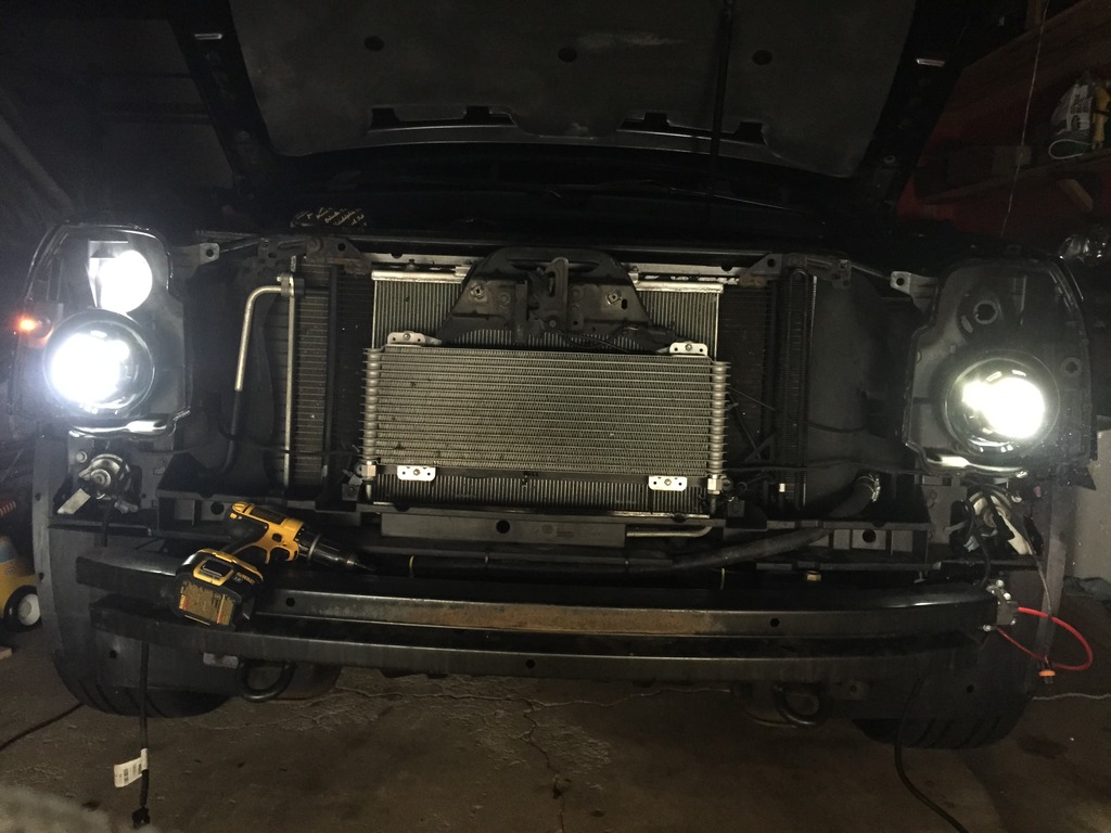

Got them wired up and powered on last night....my garage isnt long enough to get 25 feet in front of it as i been reading for adjustment, but initial plug in, they matched the lines of the stock lights....pardon the mess, the garage is under constrution

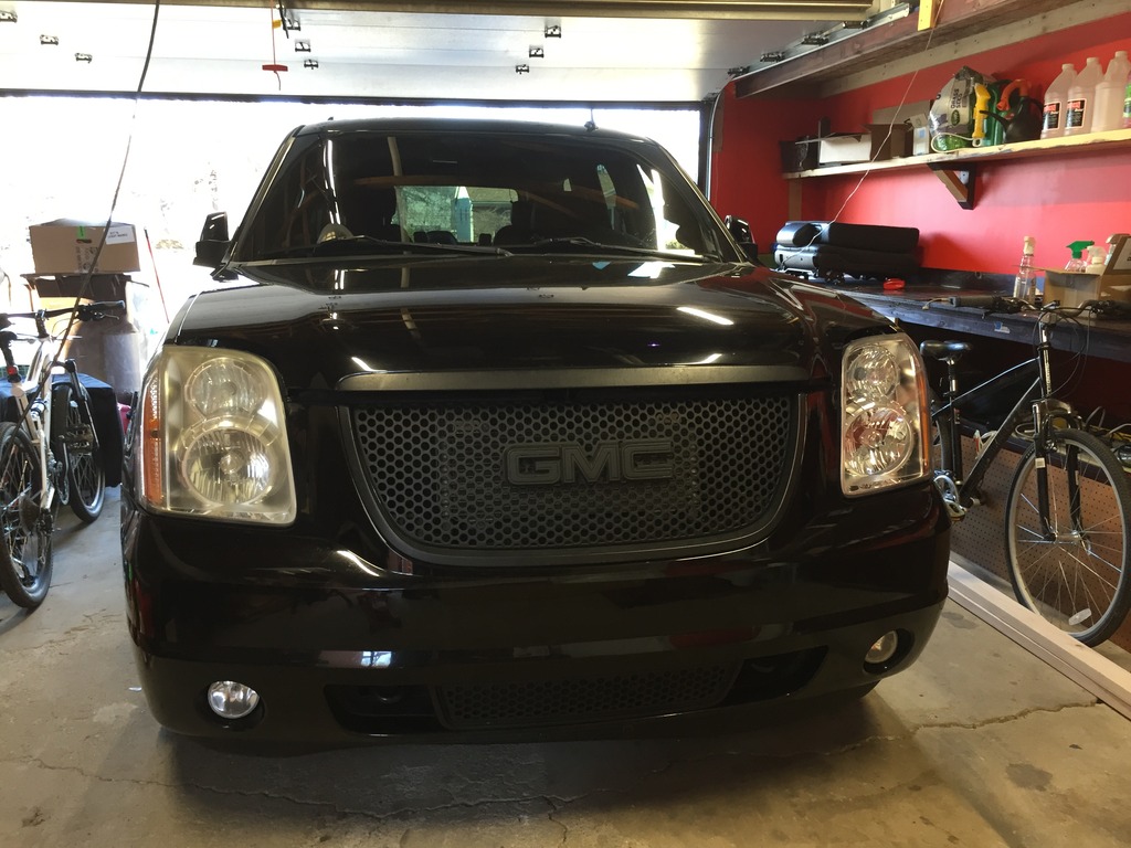

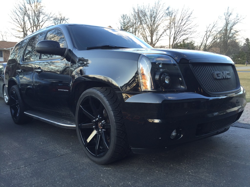

Shes all done other than installing the bumper...as soon as it stops raining..might take her for a spin to check them down the road
08grey
Jun 17, 2012
4,596
725

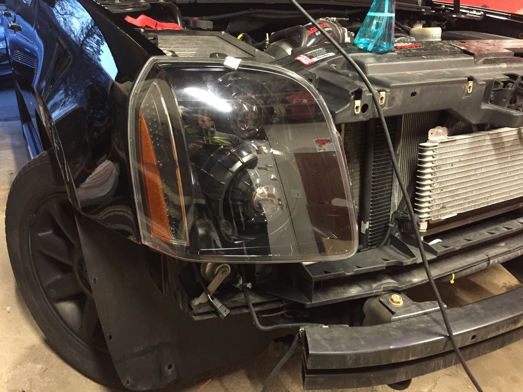

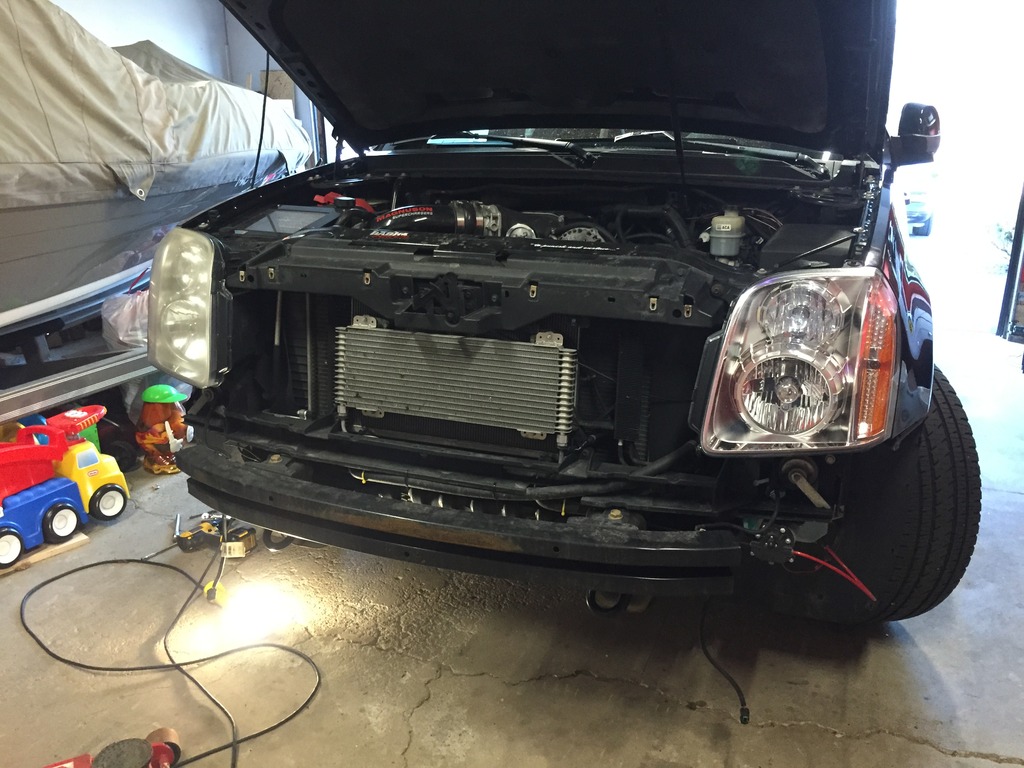

Is that the oem tranny cooler. Looks big.
Headlights are ****. Great work.
Smokymance
Smokymance
Boosted
Jan 11, 2012
795
60
MI
Thats a 40gvw trans cooler in front of robbies SC heat exchanger

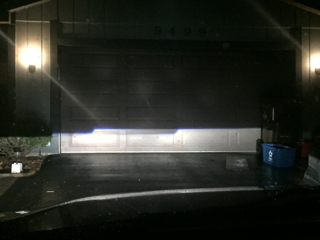

Here's the cutoff of the D2S projectors...pic was taken thru the tinted windshield, they are brighter but it was raining and im a princess and dint want to get wet...
