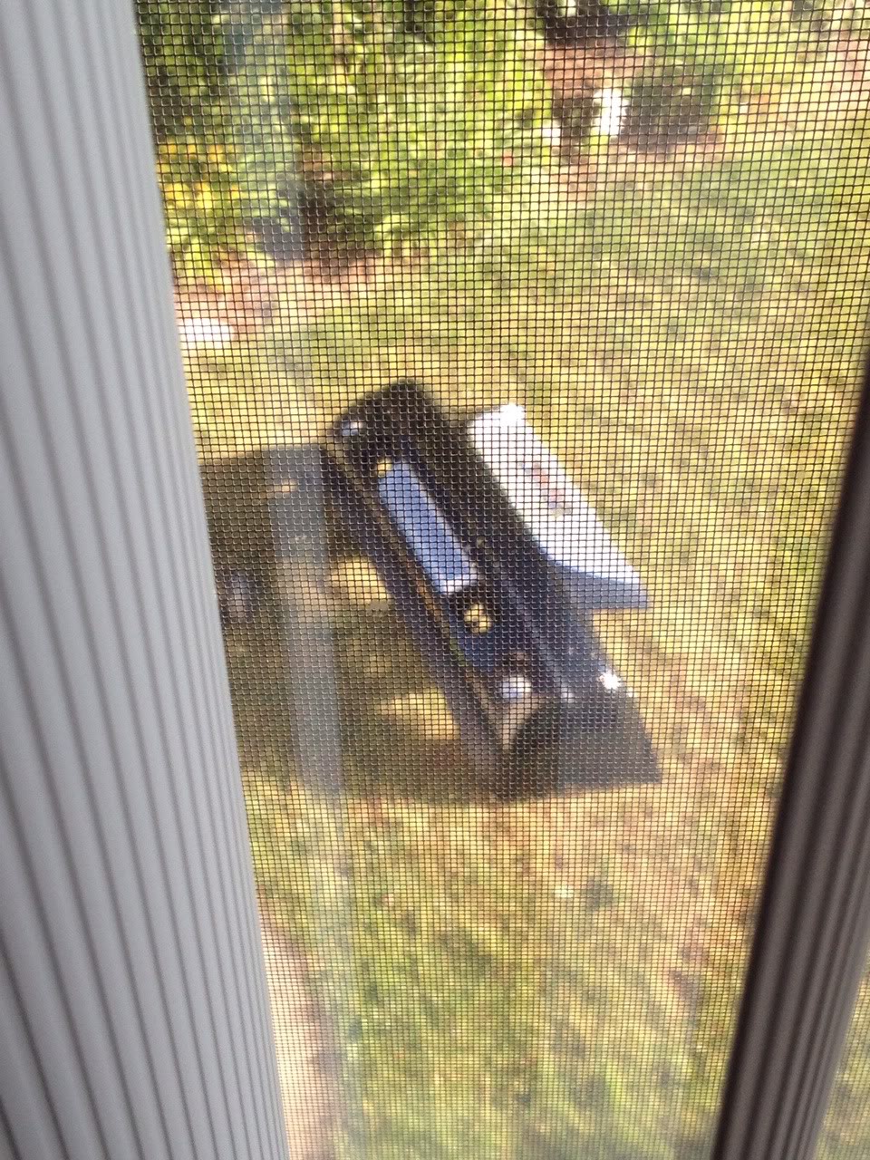

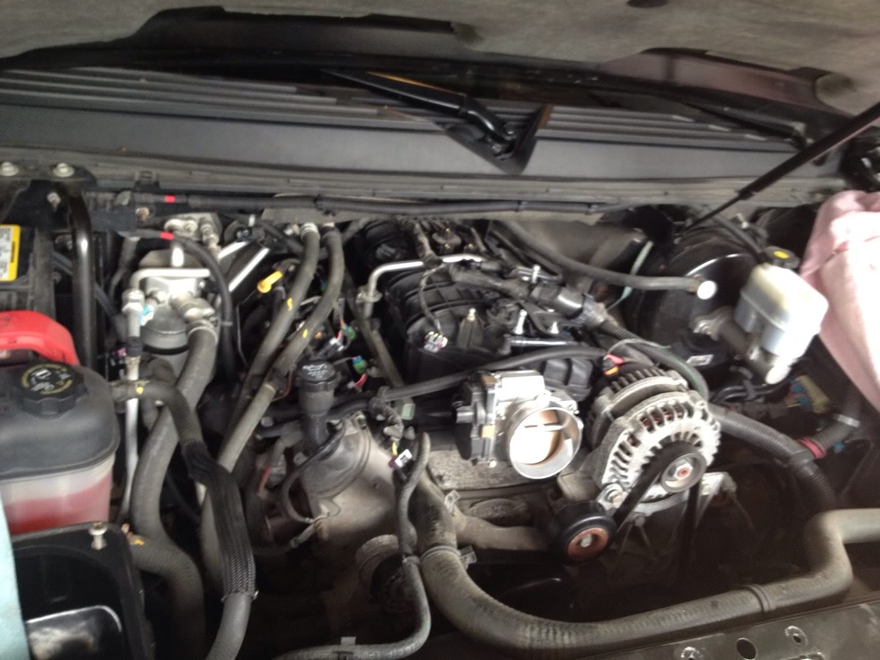

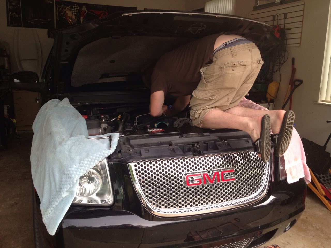

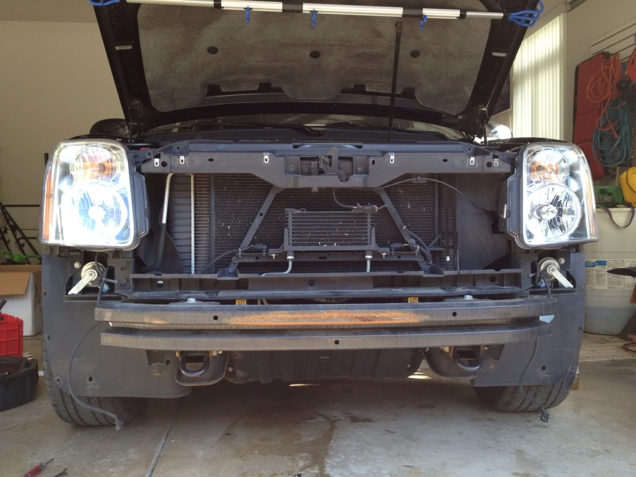

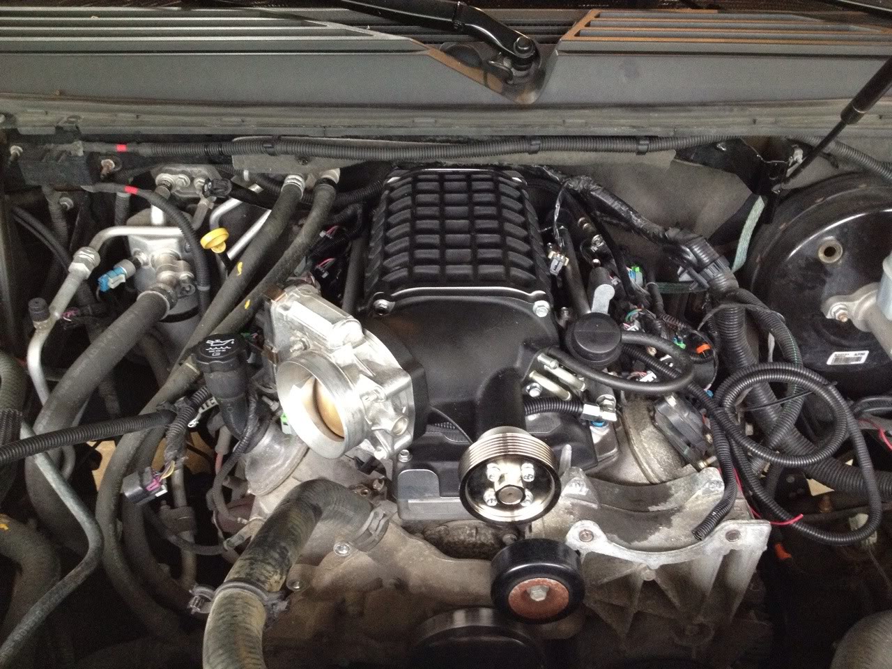

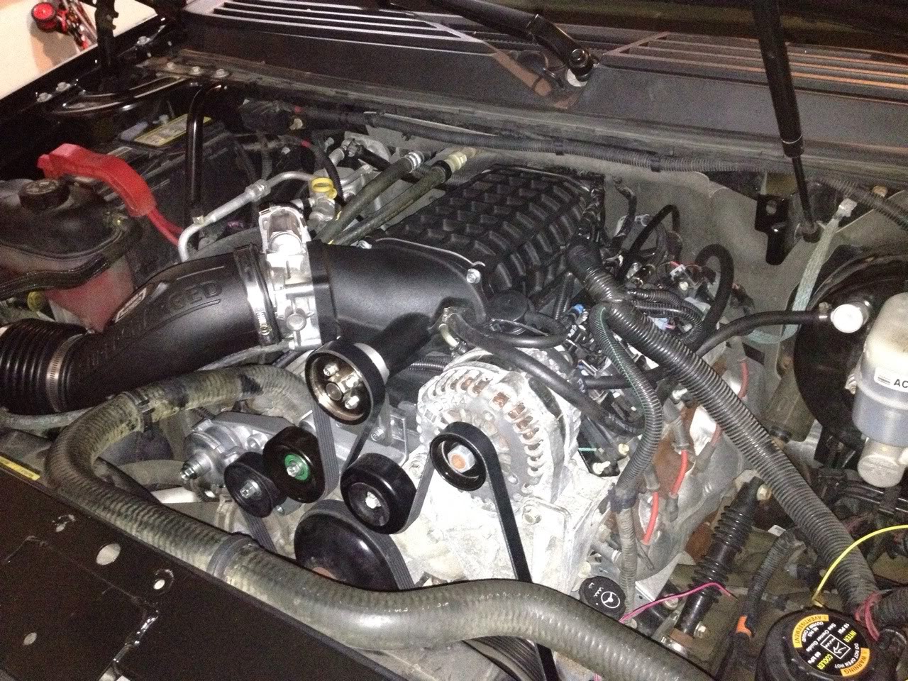

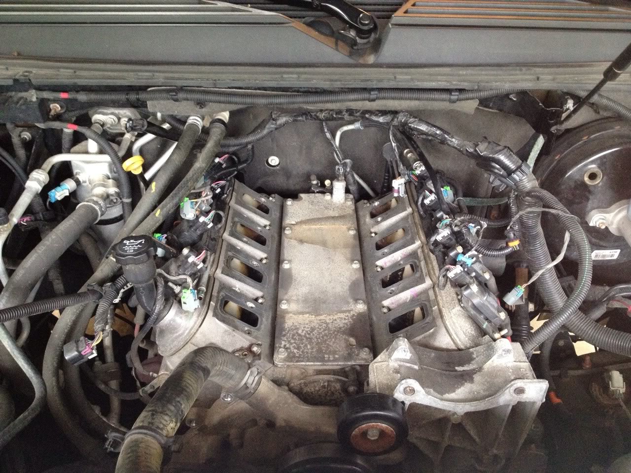

So last nights progress...started at about 5:30-6pm, after letting the car cool down for about 30 min...90 degrees outside didnt help on working under that hot hood....
Intake off
Some part removals...lowered truck made things a lil easier to remove but still not as easy as on a smaller car...
Buhh Bye L92 Intake

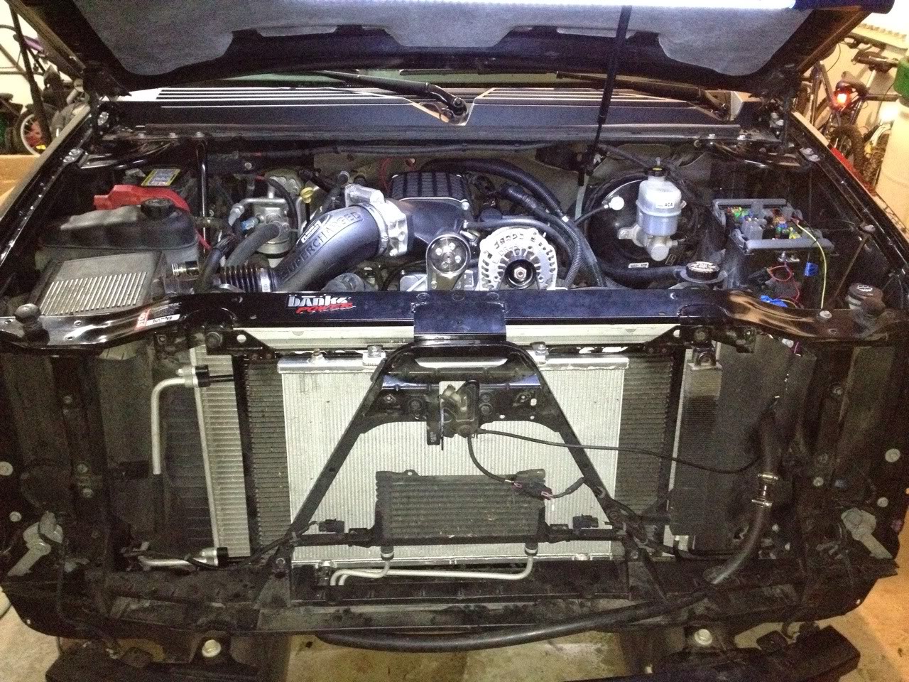

Hello TVS2300
Angle Shot

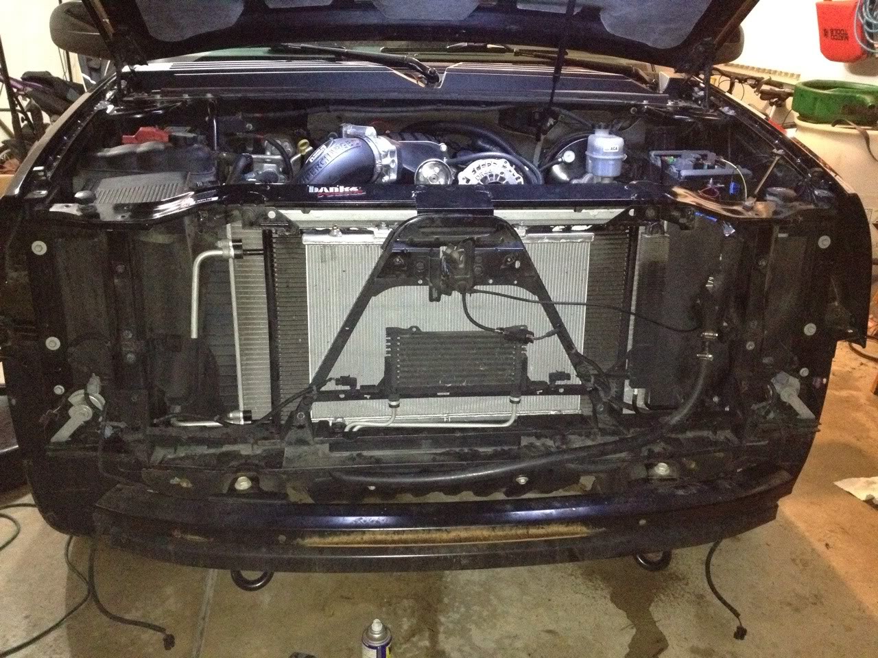

All we got left to do today is install the front heat exchanger and pump and actually run the wires from the fuse panel to the pump....load the tune from justin on the EFI live and tune it....
Only issues we had was loosing a injector adaptor which ended up falling air filter box hole and ending up on a corner at the bottom of the bumper...grrr
Had to put a few spacers on the coil pack brackets to lift them up a tad to clear the fuel rail connector on the drivers side...
Also found out that i cannot use my Banks Power intake with the maggy...it locates the MAF too close to the intake tube so i had to use the stock air box... :-(
If anyone wants a complete Banks Power Intake for a 6.2L let me know...have one with less than 300 miles on it...

Thank you sir...got the front off, exhanger installed, reflashed and ready to go last night...
It gave me a check engine light for a second, no stability track etc etc but that ended up being a 0203 code which was simply #3 unplugged injector. Got that plugged and it seems to be idling just fine...started right up and revs just fine...will drive it easy today and send Justin the log files...

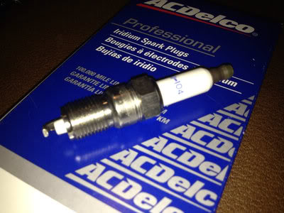

ZR1 Plugs came in today...after i find out the proper gap, in they go...
