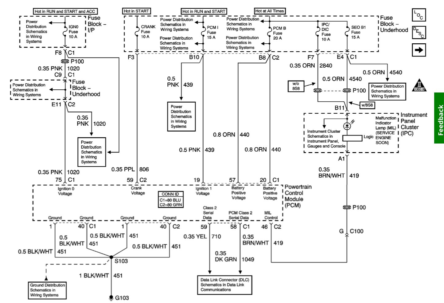

I would get a meter and start checking every fuse, if any are blown then replace it.
I would suspect maybe a fuse that provides constant power to the ecm is blown.
some fuses are labeled externally for xx, but may also provide power to other things that are not listed in the book
only the service manual will show the other things a fuse may be providing data or power too.
check all the ones in the engine compartment and the ones on the drivers side dash panel and maybe look on the right side dash panel also.
all you have to do is take a meter, put in on continuity and touch the outer metal tabs on each fuse, you do not have to pull each fuse.
smwalker
Sep 17, 2023
Looks like a 20 amp fuse in the underhood fuse box Labeled PCM B?
Not sure though this does not look like the standard GM diagram, not sure why its off a bit.
Do you have your own scanner you are watching the Monitors? I am wondering if the SMOG tech got a new scanner and is reading it correctly. No but it would not have "Monitors this key cycle " screen for a 2004.
