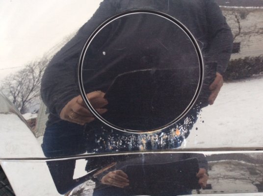

Yukon but same year and 5.3L. Don't wait to get fixed. Mine got worse until smelled inside and out. Had starting hesitation also. Blamed my son for hauling a leaky lawn mower around. Finally had to drop tank and fix.
Have paint damage around gas cap which may have been caused by fumes working on pain above tank.
