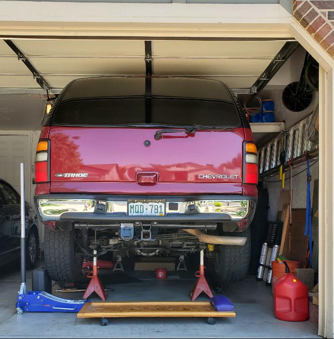

I actually helped my son change his fuel pump on his 2016 Chevy SS. We had access to a lift and he is more fearless than I. I took about 3 evenings to RR the pump. Not that bad given the $$ staying in his pocket.
Moderator
16,710
34,611
People's Republic of Colorado
I know that your GMT900s are a bit different, but not hugely. Plenty of YouTubes out there.
Did my 04's twice, with the diff on some large jackstands, in a few hours. The second time I prepped everything like removing all of the evap and fuel filler connections that needed to come off, and my son helped me drop it the next day. Not that awful. My frustration is always with the evap connections, but once I study them for a minute or so they're just a wrestling match that I win. Here it is after I prepped it, ready for the tank to be dropped.
