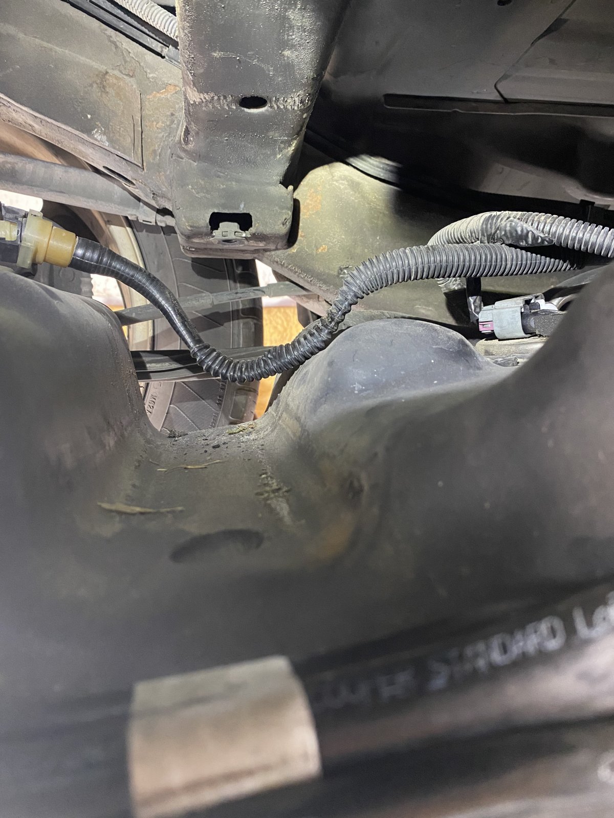

If you can reach it, pop off the large hose going to the EVAP ("charcoal") canister and see if that fixes it. Did it have the fuel pump replaced before you bought it? There are fools that forget to route the main vent hose over the cross member right before raising the tank all the way into position. It gets pinched and flattened between the tank and crossmember and is completely sealed/blocked.
If unplugging it from the canister fixes it, then you know the problem is in the canister.

You can see the hose and cross member through the left rear wheel well. I thought I posted a pic a while back but can't find it. I might've dreamt it.

Damn- I posted incriminating pics AND a confession! Hey @Matt06Yukon, this is what happens when you don't pay attention. There's not much slack in that vent hose, so you have to get the tank close to the cross member it rests against, then route that hose over it and continue lifting the tank into place. Don't forget to disconnect it before dropping the tank, either.
You can get an idea from the pic of where to look from the wheel well to see if it's pinched. If not, disconnect the tube from the EVAP canister to isolate the problem to that or the tank.
