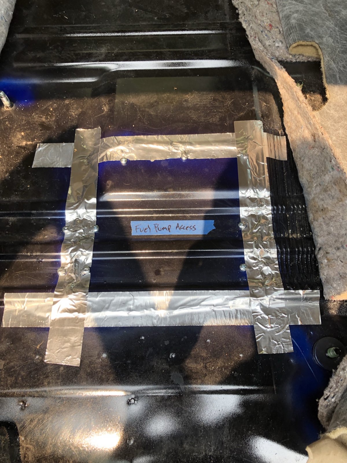

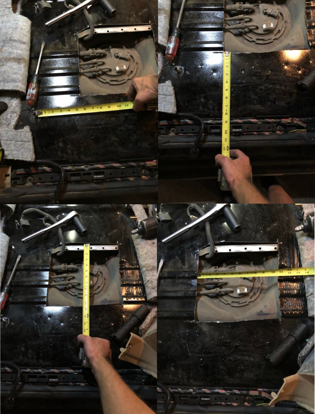

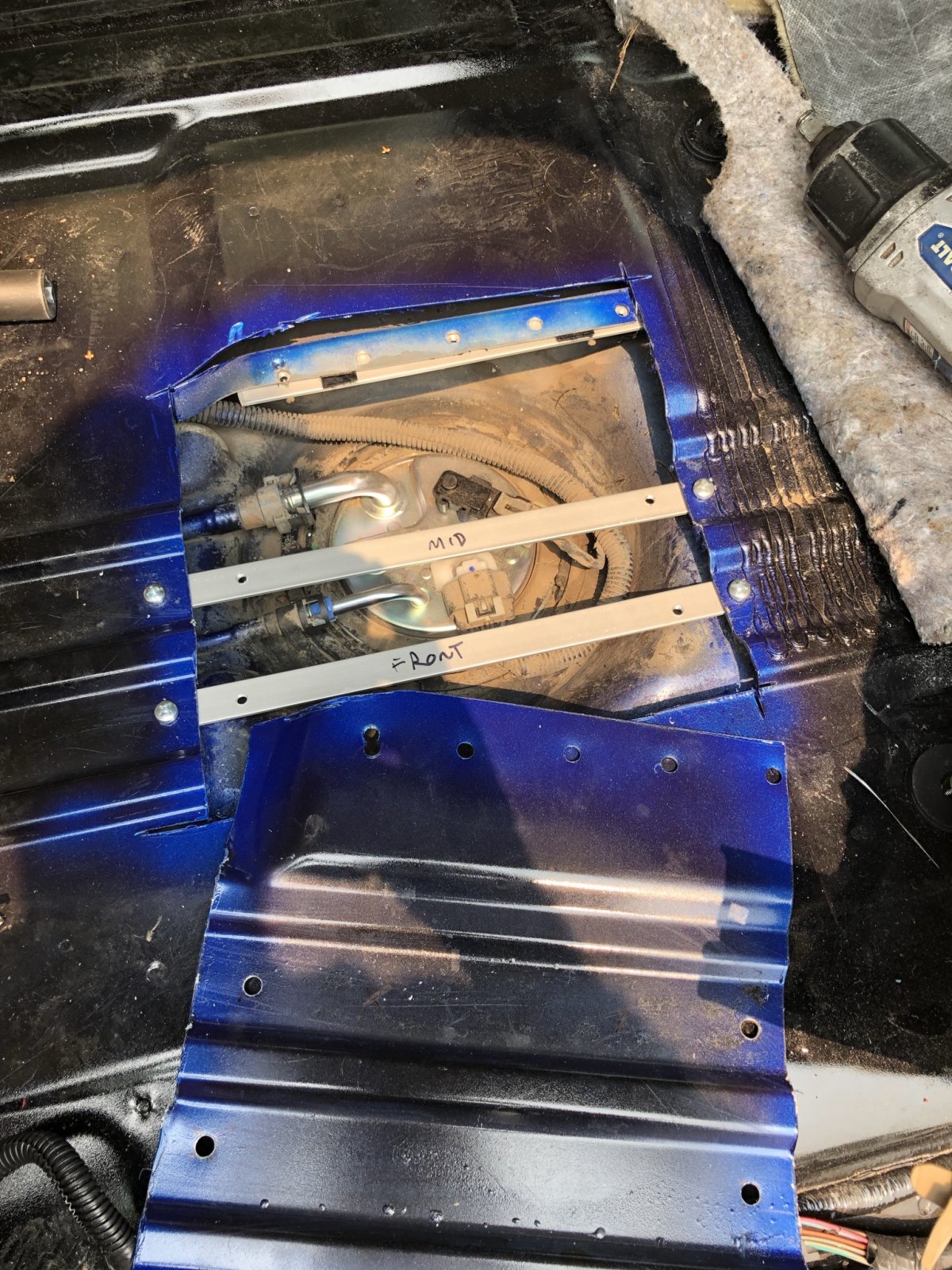

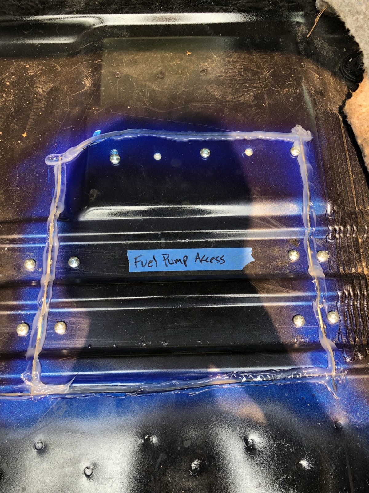

I replaced my fuel pump this weekend as well. Had the rough idle at stops, also a spike in RPM when coming to a stop (shift to 1st?) and had experienced some stalls and crank/no starts the last two weeks, including a tow. 3 days of driving and idle smooth and the spike in RPM is virtually gone, no stalls either. My MPG seems to be +1 as well. Pump was making some noise that was hard to notice until I could get close to it (I cut a hole in the floor). New pump is almost silent. Used same Delphi pump as @Geotrash. Truck has 150k on it.

I have done it twice. I can't take the beating of the concrete on my back so cutting a hole is worth it. I hit the cuts on the money this time so it came out nice. I plan on keeping it a while so I may need to use it again... This is on my 207 Yukon XL Denali.
