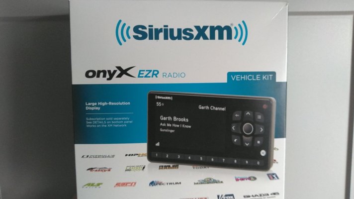

Update..... ( SiriusXM customer service sent me " the replacement box"... that was supposed to replace the factory box behind the glovebox... It was free).....
Again, due to the awful language issues, this is what they sent, as per photo.
I responded via e-mail, that the communication is a PROBLEM..... They answered back to call them again.... THIS TIME I talked to an agent in Canada....... We had an intelligent conversation finally)..
We determined, my signal loss was due to THE INTERNAL FILTER CHIP. The original filter chip was too sensitive. So they are sending me a "weaker filter" to stop the signal losses. Also included is an "Install Card", that I bring to an authorized Sirius installer, so the installer gets paid to access the XM box, and replace the filter chip inside the box...... at no cost to me.
They said to "just keep the wrong item"....

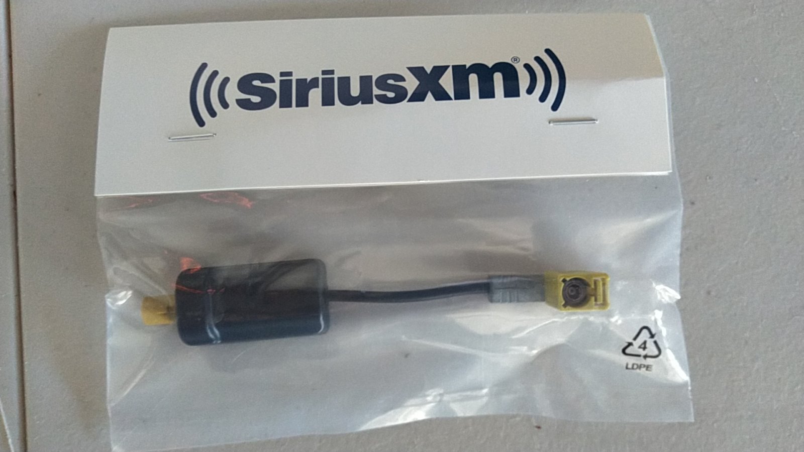

It's true that it is the filter in the XM receiver, but the issue is that it doesn't reject signals near the XM frequencies as well as other receivers. The problems started a few years ago when the FCC opened up some new frequencies for cellular that are adjacent to the XM bands and assigned them to TMobile. So, when you are close to a TMobile tower their signal interferes with the XM signal and the receiver can't pick it up. There has been a lawsuit going on for years over this, but at this point it is unlikely that anything useful will come of it.
What XM has, if you can find someone to talk to that knows about this, is an in-line filter that connects between the antenna and the receiver and attenuates these cellular signals so that the receiver can pick out the XM signal. My understanding is that the filter will do the job, and if you have the skills to get to the receiver behind the glovebox, you don't need to have an installer do it. I have wanted to get the filter for my Tahoe ever since I tracked down the issue, but getting someone on the phone at XM that knows about this is difficult.

I want to " use" the install card at the audio place for any warranty / future issues.
Here's the part... pn# WCSF1..... And yes, it attaches to the antenna line at the box.
When I get it installed next week, I may also have them switch out the OnStar box with the 'CoStar' box, since they are next to each other.
So, call XM ( ASK FOR AN AGENT IN THE US OR CANADA), and request the part. ( free when you complain about the signal loss)

UPDATE : The SiriusXM filter ( in-line to antenna cable at box)......
It works. No more signal loss!! Whoopee ....
