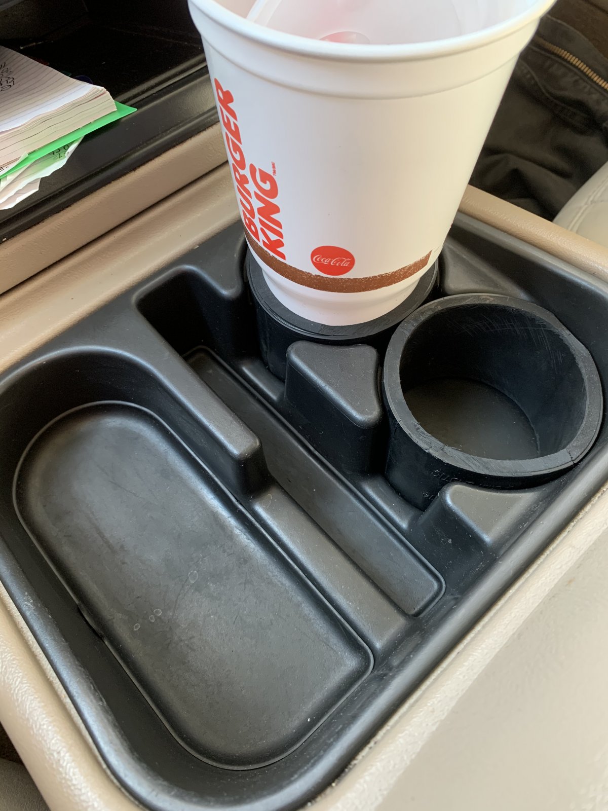

Ok, you know the deal, the cup holders stink. some 3 inch PVC couplers, cut the part where the clamp goes off, then slice them vertically so they are easier to squeeze into the openings.

Great idea! It surely beats shopping various travel mugs to find one with a wider bottom section.
