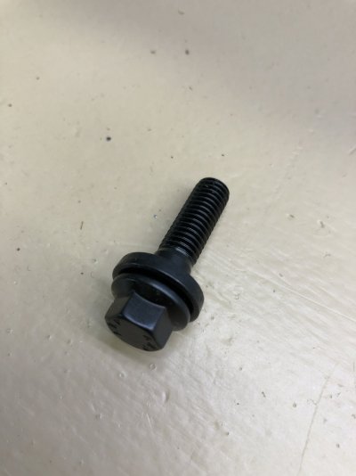

Here’s a couple pics. The washers are real thick, maybe twice as thick as a regular washer. They’re also a bit bigger in diameter than the flanges on the bolt. All in all they’re a great product imo, like every single ARP product I’ve bought. I like the fact they seem like the clamping pressure would be good.
And very unlikely to break like the OE ones

ARP always comes with washers so you have a consistent mating surface for the bolt head to ride on making sure you reach a proper torque spec ... Or at least making it more likely.
