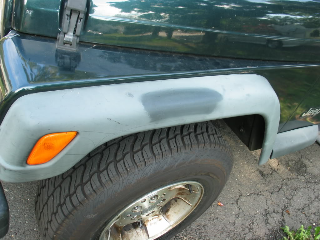

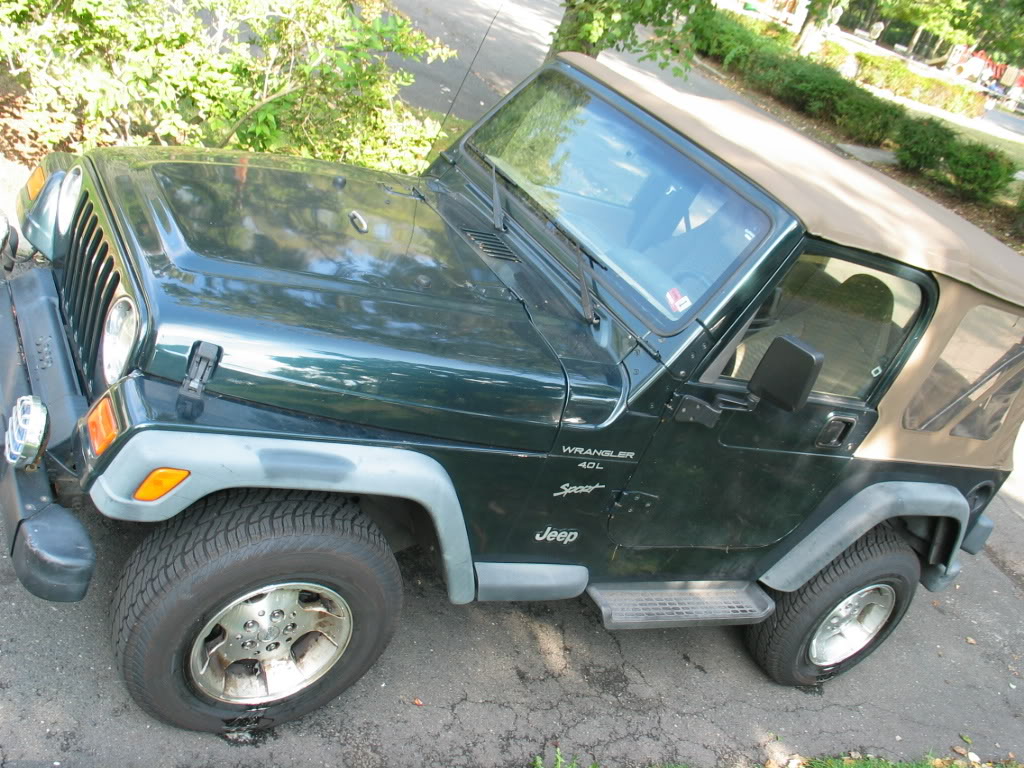

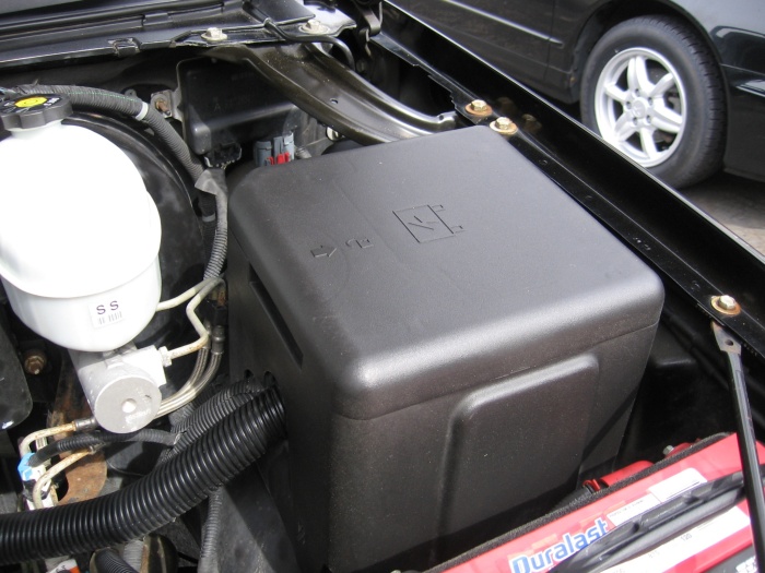

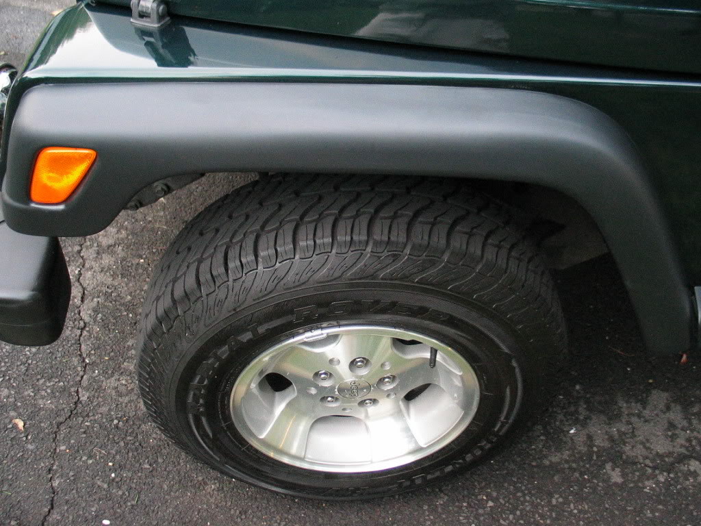

I use Poorboys Trim Restorer on textured black trim and it does a great job. Use it on a microfiber applicator pad for a little extra bite. Thats my best solution, hope it helps :)
This took about 3 coats and then a final buff w/ a mf towel. I did a quick swipe so you could see just how bad these things were!
And after about 3 coats of trim restorer... you get this:D (fwiw, I applied each coat and let it absorb for about 10 mins between each application)
Fwiw, you would have to reapply every so often, once you see the trim starting to fade again.

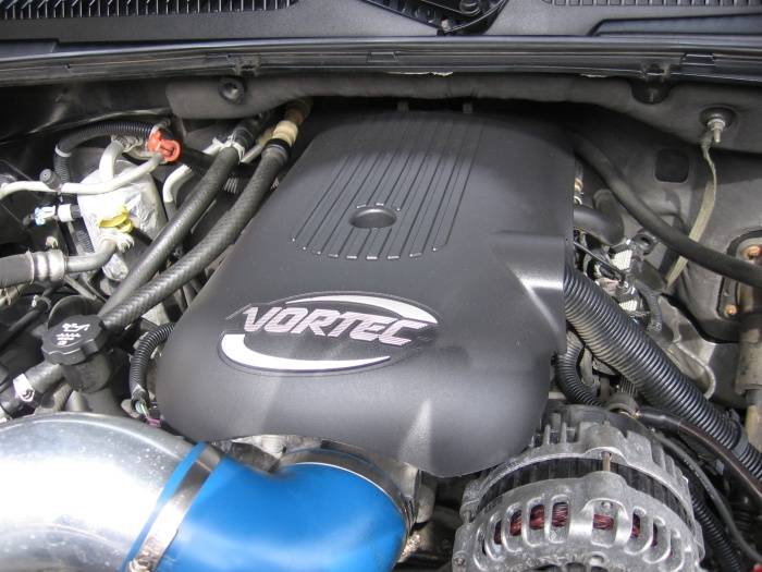

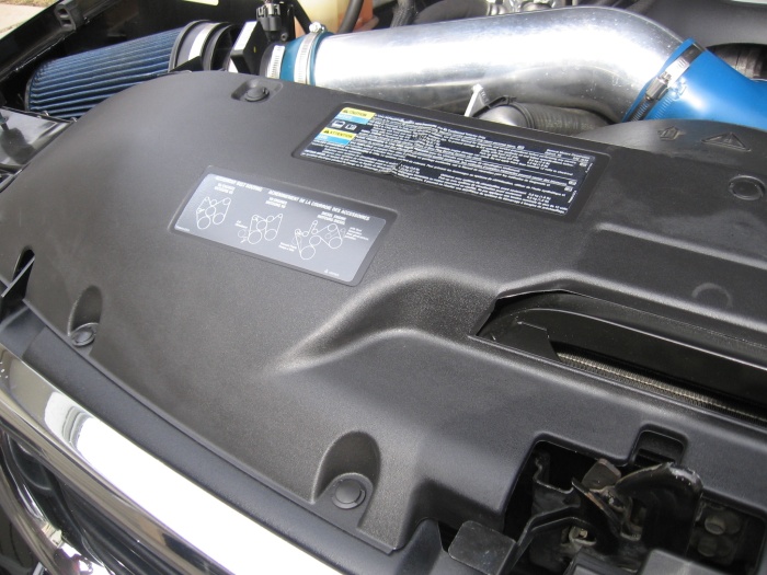

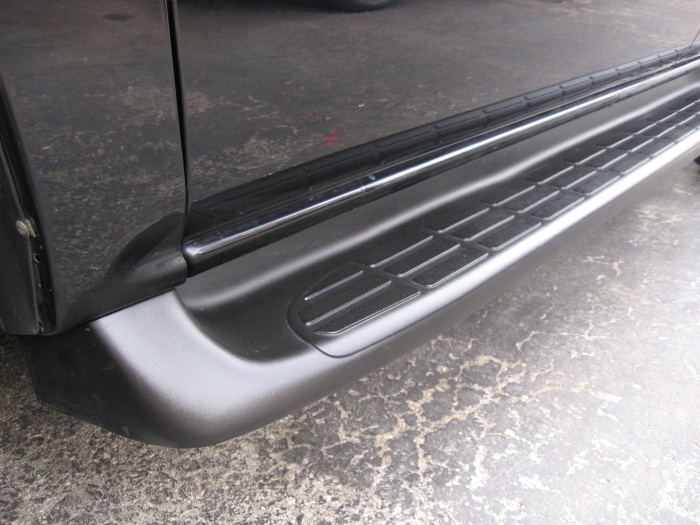

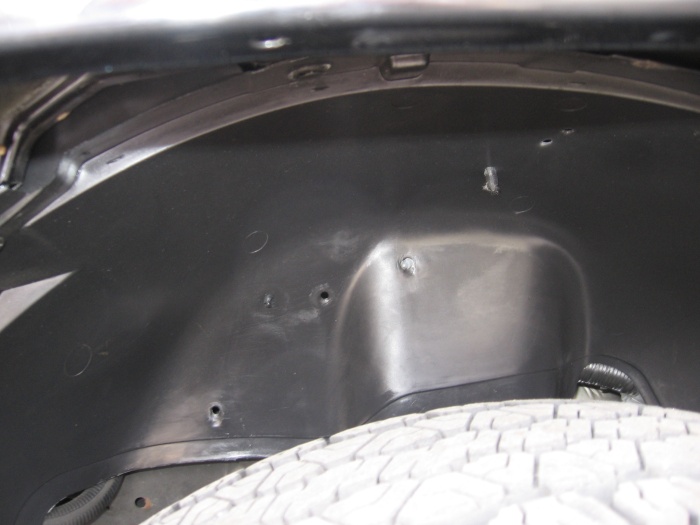

I started using poorboy's "natural look" and was very impressed with it! I slipped one too many times using various other shit but the "natural look" left no greasy residue, wasnt slippery when wet and a single application last 2 months before a reapply. Everytime I washed the car a dry wipe down would shine it back up again.
my 03 with 195k on it now.
and I use it on everything black not painted! Tires dont sling shit all over and dont have that greasy shiny look either.

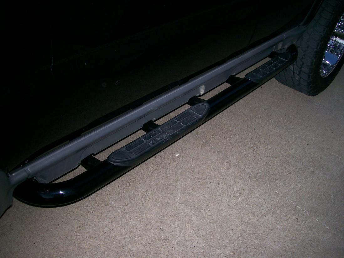

i just got mine back from powder coating looks tons better
