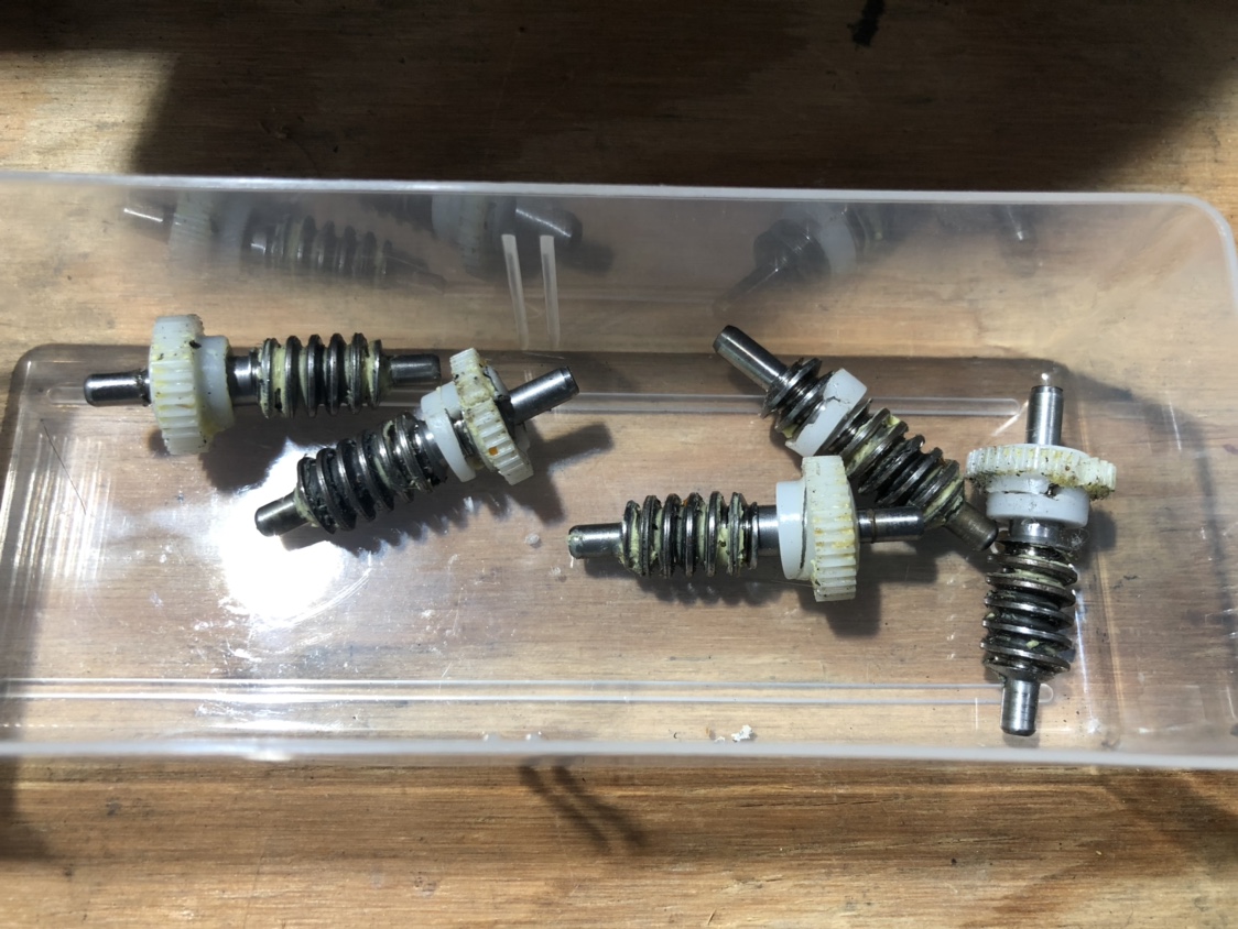

This is the fix. It’s not hard. They even have a video on how to do it.
https://www.gruvenparts.com/gruvenp...-2007-2014-gm-trucks-folding-mirror-assembly/
Here is a pic of the gears out some of my trucks.

hey wondering if you can get me some information on the teeth etc.. i see a lot of METAL replacements gear things on ebay on the cheap
but i just needs the specs like sizes and teeth count etc
I know there is a lot of sellers trying to charge like $100 or $200 for these parts which is insane.. :( for a item that in reality is only worth 10$ or less.. bought from china. I don't use the folding part enough to justify spending that kind of money...only like 2 times in a week..
