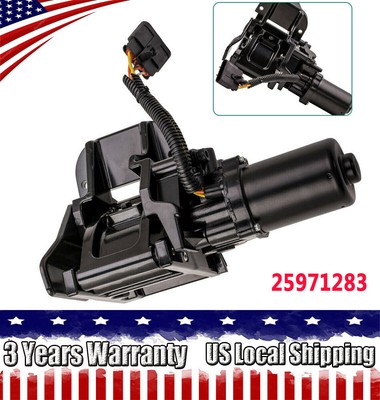

Looks like you can also just replace the motor, and that could also solve your problem..
These motors are everywhere, aftermarket and new. It may be a fairly common problem?

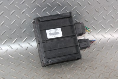

Edit: It could also be the power running board control module (Another thing I just found out these have)
Module:
Motor:
