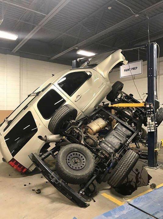

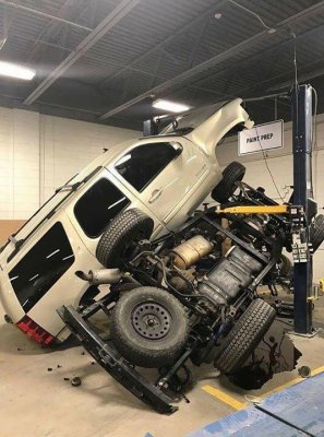

HTH did that happen?? Not related at all.. I hope not.. but that is crazy. Came in for an oil change, leave with a big insurance check.
