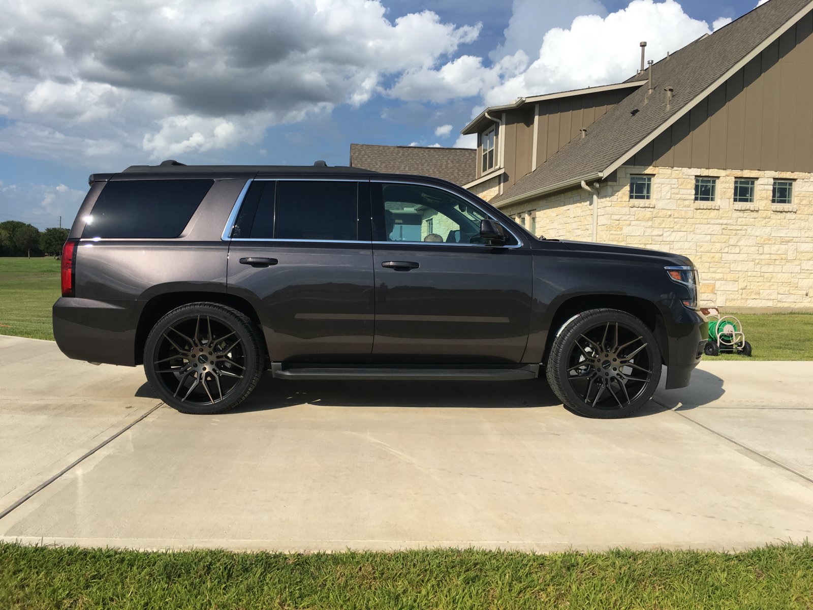

i am @ @2" front & 2.25" rear
just ordered spindles from Norcal SS
trying to decide if i want to go 4 or stick to 3 for now in front
eta:
fender to ground
ft: 34
rr: 35.75
That's a beast of a ride you have there.... if you bought the spindles you might consider going with the 4" in rear...I will measure mines tomorrow and post them up just to compare...

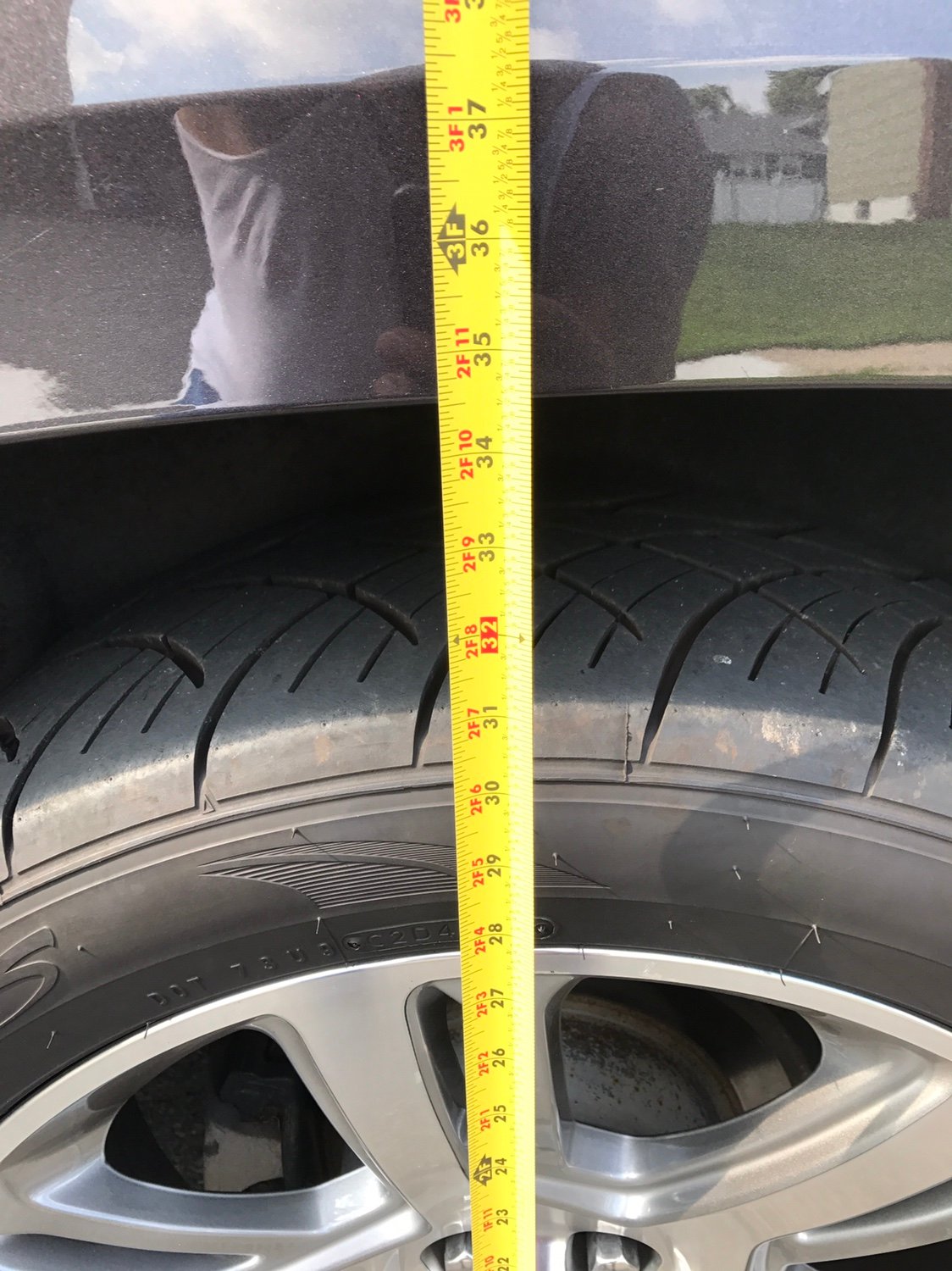

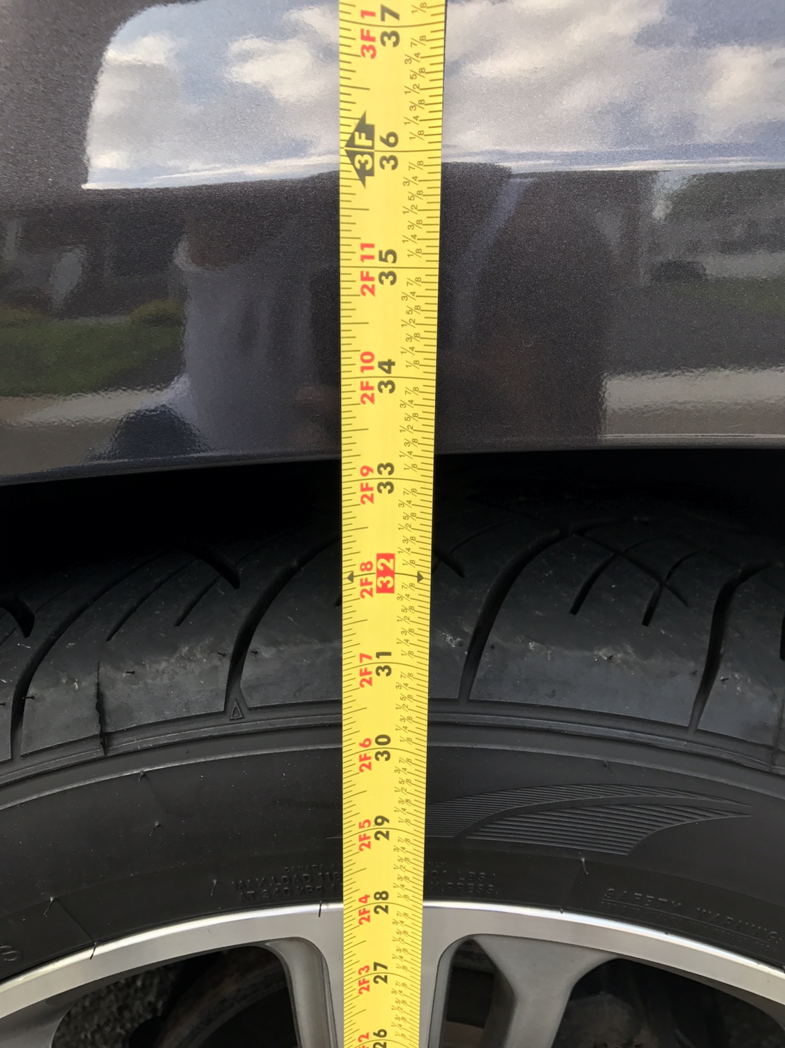

LF: 33&1/4
LR 34.5
RF 33.5
RR 35&1/4

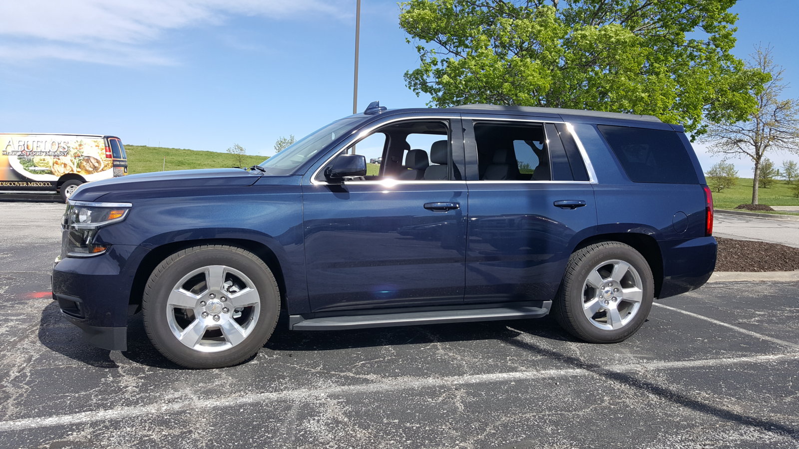

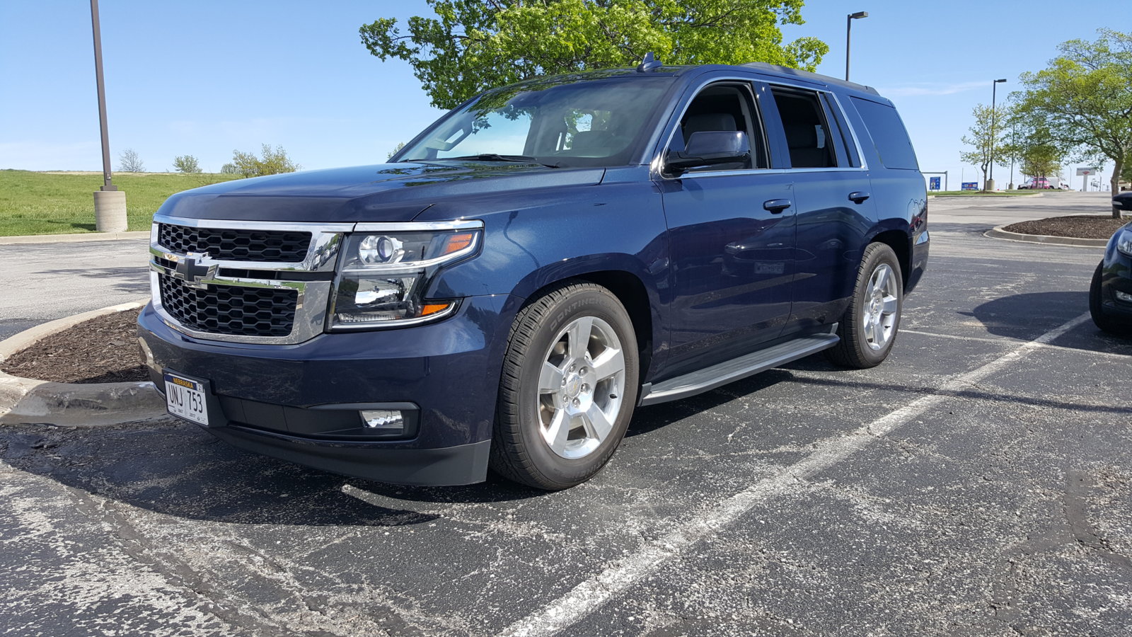

2017 LT 2wd running 3" DJM UCA/LCA combo & Tony's Belltech 3.5/4.5 rear. This pic has Thick Isolator installed AND a 1" spacer on axle. Currently, the Thick Isolator is pulled, heater hose installed on upper end & 1" spacer on axle. I know it's a crazy combo in rear but I was trying some different things & that's where it landed - slightly lower in rear than this pic. I had to add the 1" spacer cuz my wife thot the spring only made the rear sit too low.
