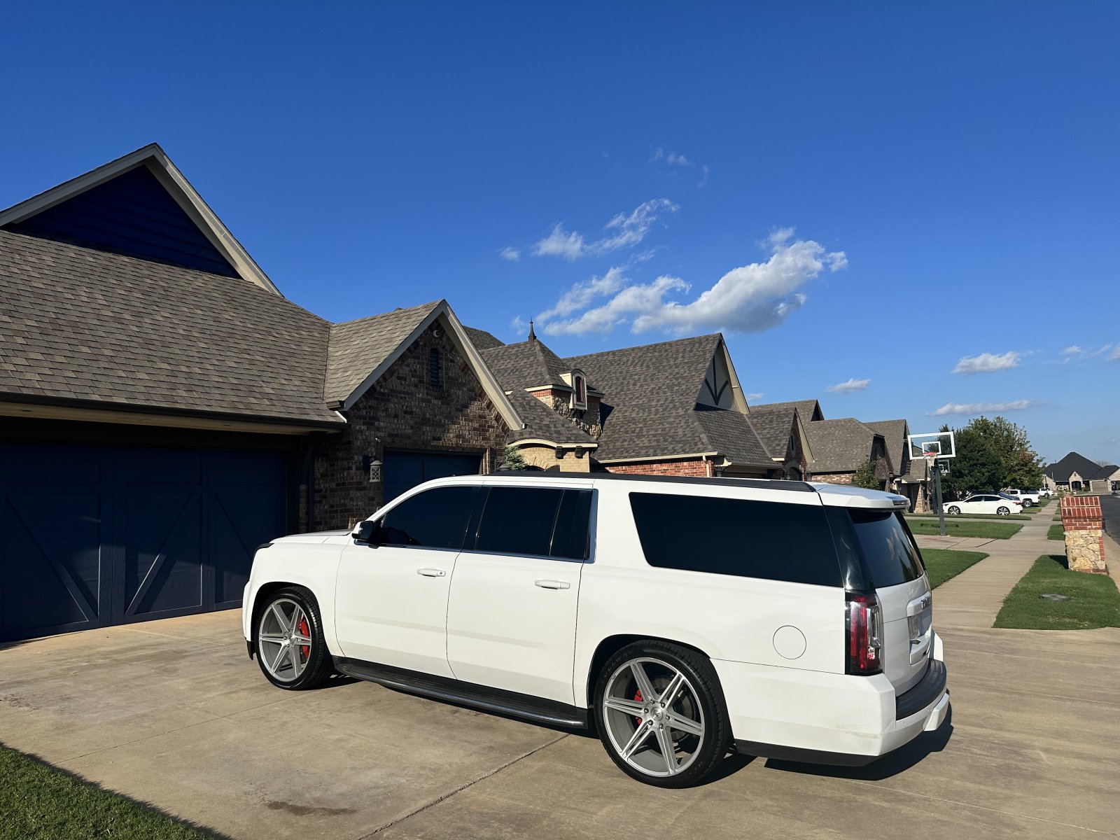

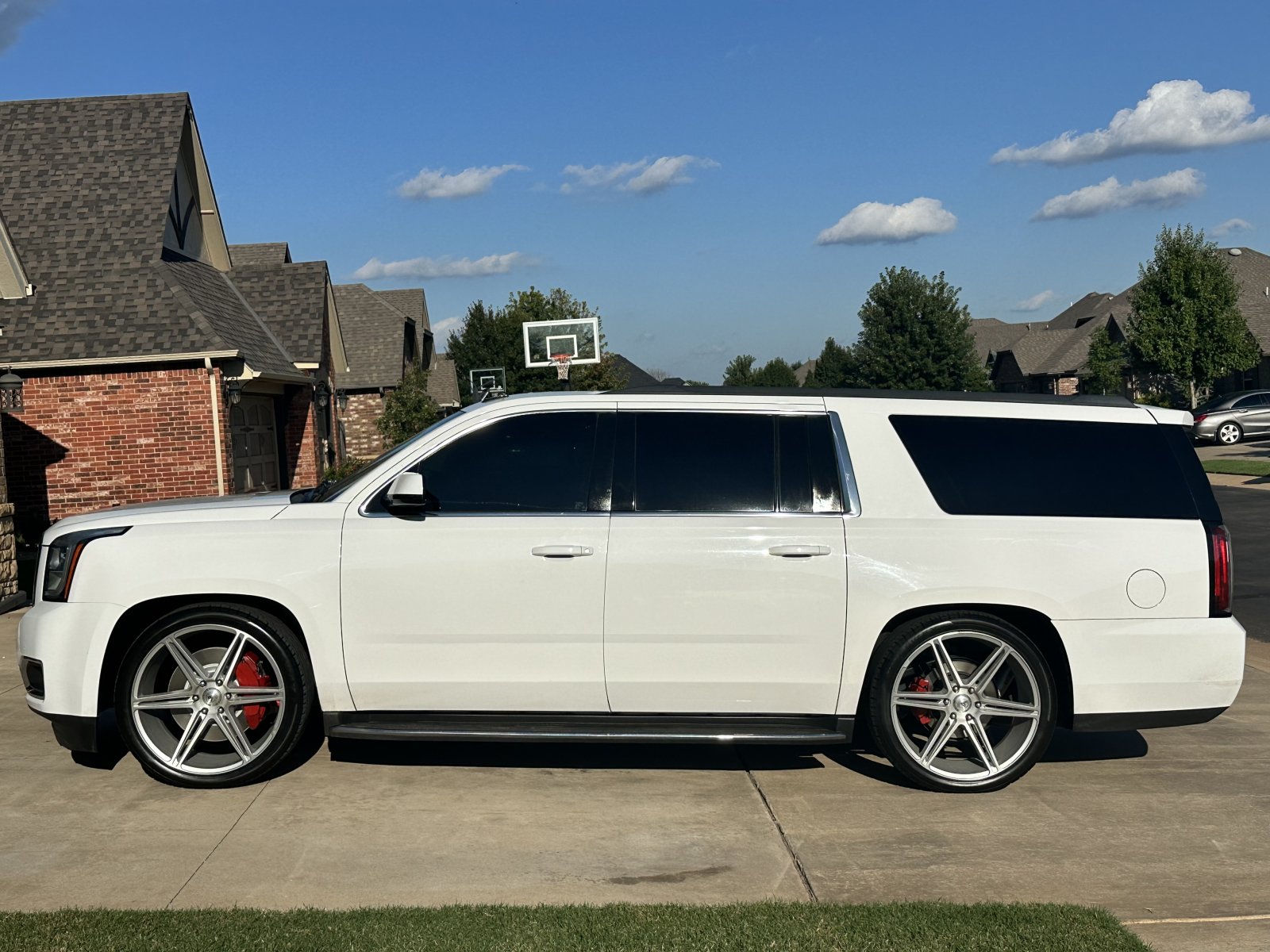

2015 Yukon XL 3/5 Drop on 24s
- Bell tech Spindle
- Bell tech Rear Spring
- Bell tech Shocks.
- 2021 PPV Front Big Brake 6 Piston Kit.
- 24x10 (+24) Asanti 6
- 295/35/24 Fullway.
