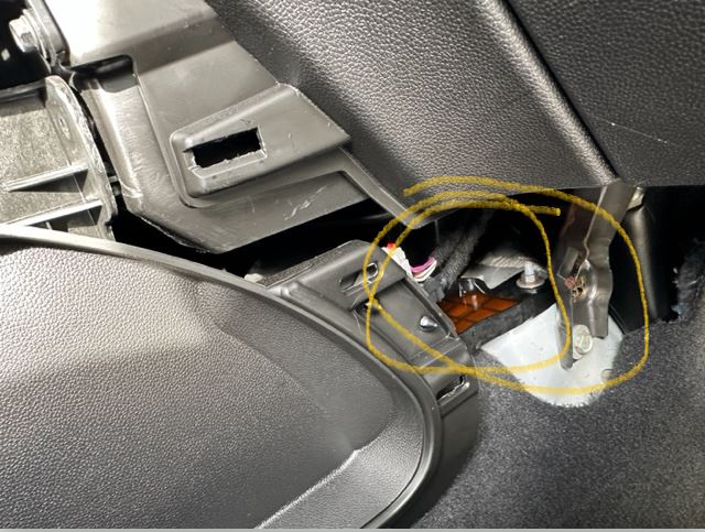

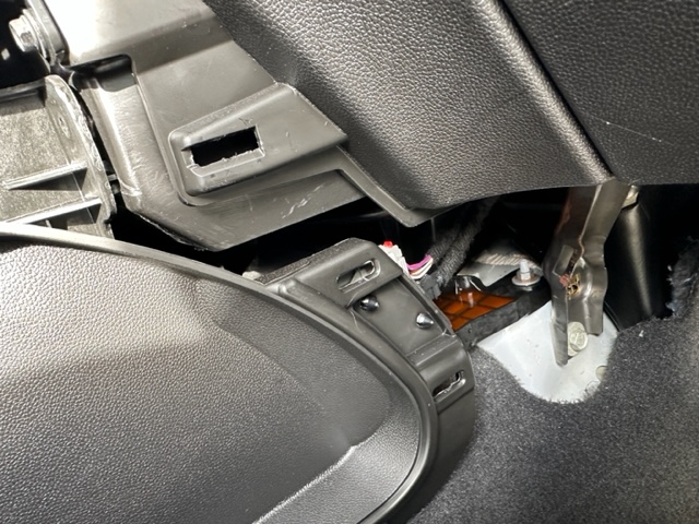

My 2022 Tahoe isn't running after running over some junk in the freeway which punctured the AC line under the car that goes all the way back to the rear AC. For a while the car started and ran fine but I noticed that AC fluid was leaking under the dash. You can see the red fluid pooled up in the black platic area. I can't drive it anymore because it will turn over but not stay running. The Speedometer / Cluster won't light up at all anymore. I can see that under the dash in the center console, (especially passenger side) you can see that the car is leaking what I think is freon. It's a red oily liquid. Is there a Engine control module or computer that is in this area which is shorting out, or damaged that won't allow communication between the car and instrument cluster or engine? When I hookup my OBD scanner it says cluster lost connection or something liket that.
Any help would be appreciated.

is the coolant reservoir still full?
there should not be any ac lines right there, being it is a T2 can't say that for sure, seems more possible the heater core is leaking.
generally the radio amp is under there and that's what those wires should lead to

Stop taking it apart and take it to dealer. That ref stuff is either coolant or soda. Freon is green. Dexcool is orange. Could be heater core leaking.

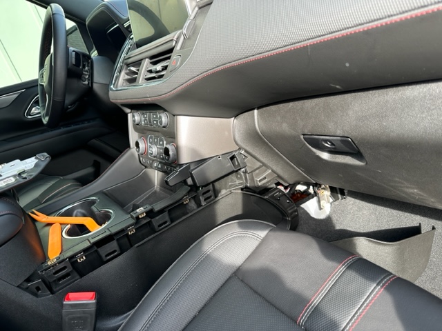

It isn't under warranty anymore. I am just trying to find out what computer or relay in this area might have been shorted out and could be causing the Speedometer/cluster to not turn on. Anyone have any ideas?

Freon (realistically in this vehicle the A/C refrigerant is R-1234yf) is not liquid when not under pressure, it is a gas...your A/C system may have some dye in it to detect leaks, this is usually either green or reacts to UV (Black) light.
Coolant in the GM Vehicles is pinkish/red, and tends to a more rust red color as it ages...this looks like what you have taken a picture of.
If the road hazard damaged the A/C line (containing the R-1234yf) under the vehicle that services the rear evaporator, the A/C system will become discharged, and the compressor should quit running to prevent damage to it via the pressure switch. This action would not cause a coolant leak inside the cabin.
Now, if the road hazard damaged the "heater lines" going to the rear A/C unit, I would expect a loss of coolant in the engine cooling system and this would be a critical failure. Depending on how big the leak is, and how much coolant you lost, you could potentially overheat the engine; possibly doing irreparable damage to the engine. Normally you would see this rise in engine temp on the gauge cluster, but you siad that the cluster has been rendered inoperable. I still don't think this, in and of itself would cause a coolant leak inside the cabin, unless the coolant line was pinched, or the pressure in the system became so high (due to the overheat), that it blew a hole in the heater core or one of the lines running to it.
I can't recall whether the BCM controls the gauge cluster or whether that is direct from the ECM. Could be either, so not sure, but if you have coolant leaking onto modules under the console, you definitely have an issue.

BCM and ECM are both under the center area of the dash?
No, ECM is under the hood.
BCM is under the steering column, according to this diagram on the GM Upfitter site, see pg 7-891: https://www.gmupfitter.com/wp-conte...oe_Electrical_Body_Builder_SM_U_2021OCT08.pdf
Same document makes reference to "Instrument Panel Control Module", but I was unable to find a location of it in the document. It may be integrated directly w/ the Cluster.
Note, there are references in the doc that the BCM and ECM both communicate w/ the IPCM.

on a 21+ not completely sure but the radio amp should be there and maybe onstar but it is a whole new platform so no telling. they have made the most buss more integrated with the other equipment and instrument cluster so if the amp got ruined it might cause a whole host of issue's (just speculation)
did you check the coolant level? it sure looks like coolant and if it is you won't be able to stop it unless you pinch off the heater hoses completely or replace the heater core and that's going to be a bundle if the dealer does it.

IT looks like you were right, its is coolant, must be the heater core. I am not trying to repair this vehicle at the moment, but get it started so it can be moved. Do you know what "computer" or fuse near the heater core or under the center of the dash that might have been shorted out? Whatever happened under there with the coolant getting all over it must have shorted something where the Speedometer/cluster doesn't turn on, and the car won't fully start. Any idea?

I ordered an ECM and tested it with the same result. Car cranks and almost starts, then shuts off. The ECM I switched out was on the far drivers side under the kick panel. Is the BCM closer to the center of the dash? That is where all the coolant leaked out. That is where I think something got shorted out.
BCM is shown in the diagream in Post #11 as under the steering column.
Did the Gas Pedal get wet?
Um you have to program these components for the vehicle. It's not as simple as just plugging in a ECM or BCM.
You need a professional to diagnose and repair. Not just throwing parts at it.
