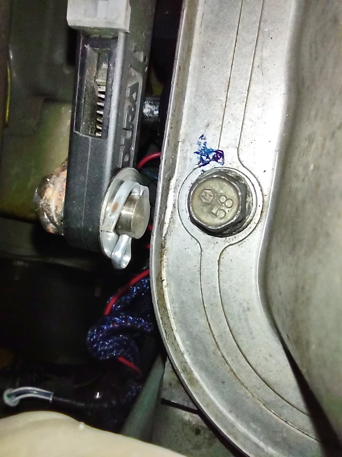

This will fix it forever.
30,738
48,416
Anyone have a permanent fix for this shifter linkage to the transmission gear selector constantly falling off.
Fix attempts to date are; change out the nylon bushing, replace the gear selector with a genuine gm gear selector and new nylon bushing at the same time.
Still have to crawl under this thing every time I drive it to secure the nylon on the pin and still cannot use the gear selector to often or I may be under it while it is hot trying to secure it while I'm out. Getting up and down is a major inconvenience being handicap.
drill the nipple, install a washer, insert a cotter pin behind washer. then it cannot come off unless you remove the cotter pin and remove washer.

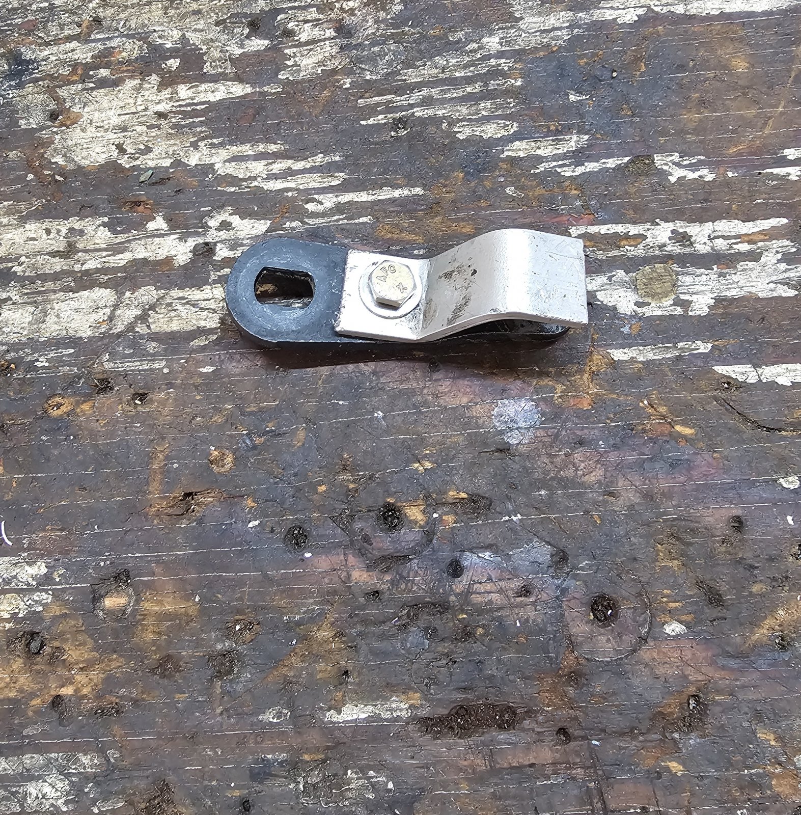

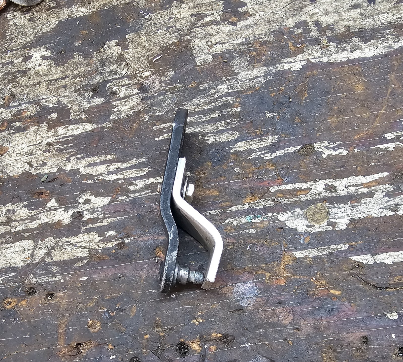

This $hit always happens at the worst time!
This never happened on my 2013 Escalade ESV until the last 12-18 months. I burned through (3) of these damn things:
The damn Dorman fix would fail every 3-6 months! :favorites68:
Thanks for the tip @Doubeleive
Wish the washer was a bit bigger, but it’s the best we had laying around and I think it’ll be ok.
Hoping this is more of a permanent fix now:

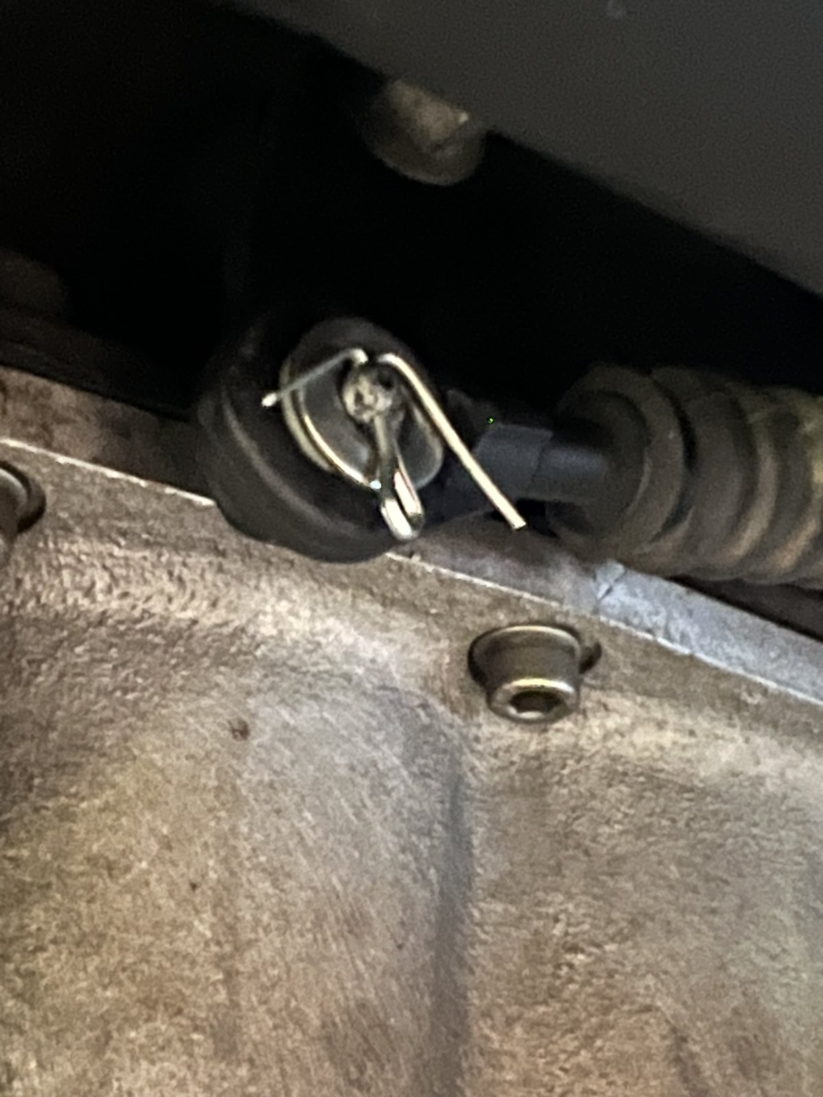

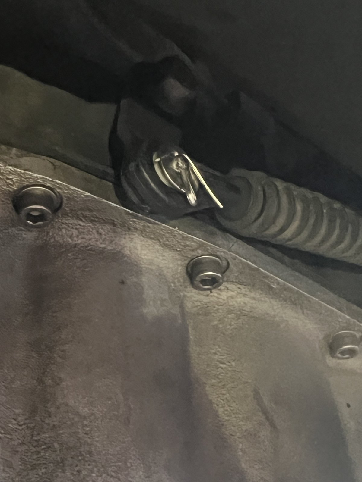

View attachment 490321View attachment 490320
mine has been fine now for close to 5 years I think, every time I look at it, it looks the same as it did when I made it. the inner grommet is still required, the washer and cotter pin just prevent it from popping off again
