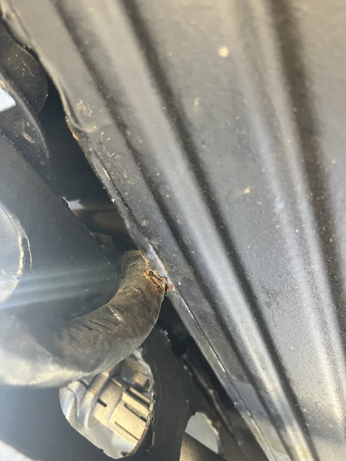

Well I got the fancy scanner and it won’t com with the suspension controller like it’s not even there. Only code was from the BCM saying it can’t comm with the suspension controller so I knew it’s either a wiring issue or the controller is totally dead. So I checked fuses for it and went under the car. I think I found the problem in case this helps someone else. The main wiring harness for the co troller rubbed on a cross brace and it cut through several wires, one of them the main power.
