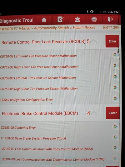

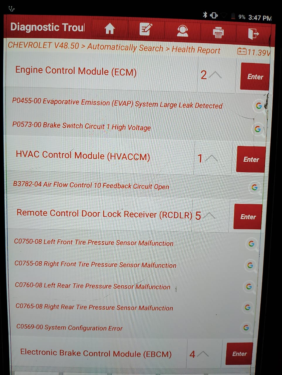

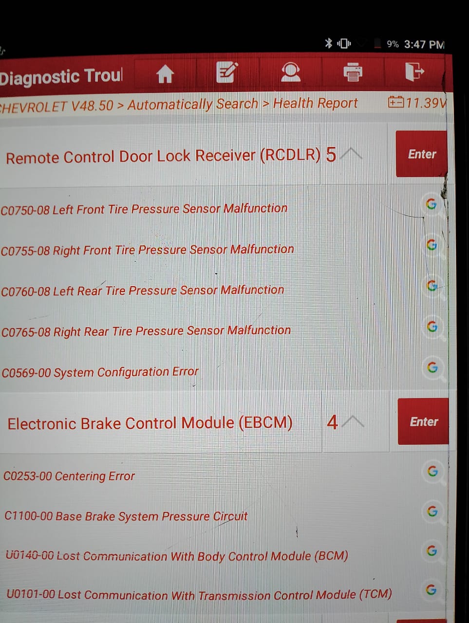

Regarding the scanner tool, you're right. Mine only does read "P" codes. But when first buying the car, I got it inspected and am going to attach photos of the scan done by then. The scan isn't that old (month or so) and the brake message was there at that time. Maybe it can assist you in any way.

the ecbm code for centering might be a steering wheel sensor. tells the computers the steer angle that's need for the traction control stability stuff.
just a guess. hard to know without data

Welcome to the forum Abdullah from Florida. See if you can sign up for a subscription to the shop manual at AllDataDIY for access to the troubleshooting guide for each of these codes.
The brake/chassis codes are likely due to the EBCM needing to be replaced but the troubleshooting guide ought to be followed to rule out the easy stuff.
All of your tire pressure sensors need changing or new batteries. They're not supposed to be able to be changed but people do.
The brake switch is a common repair item. Takes 5-10 minutes to swap out under the dash.
Do your best to use all GM or ACDelco parts, aftermarket parts do not play nice with the computer system.
