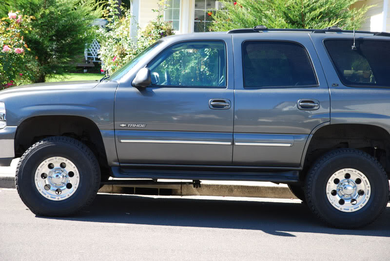

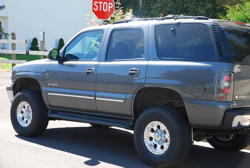

Here's it is FINALLY!!!ignore the 2 dents on the right side...*thanks mom*

Looks good man!
Often when a car is dropped with Autoride the Air rod links for Autoride are too short and need to be replaced with shorter ones.
When you are lifted it is most likely the opposite and you may need taller ones, don;t know how you would go about that though.
I would just ditch the Autoride all together and get Bilstein 5100 shocks with resistors wired to the ride control so you get not error message.
