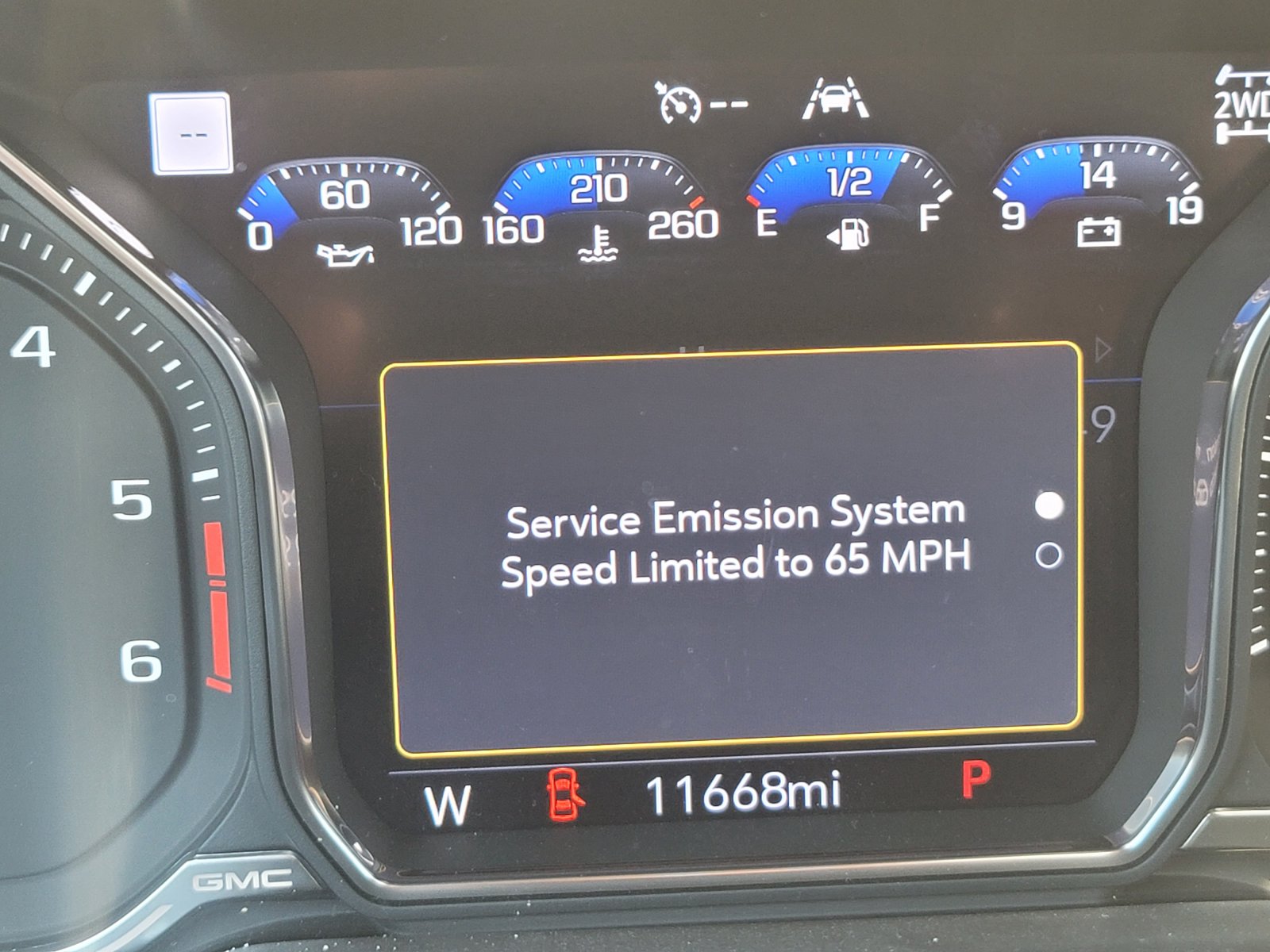

Service Emissions System warning came on this morning at the start of a long trip. Figured it was a regen thing as the car had been only grocery getting for a bit. However, 2+ hours of driving later and it's not going away.
Limping it to a dealer in Dallas now at 65mph, (soon to be 55mph) hoping they can clear this issue.
11,600 miles on the car so far, seems early for an issue like this.20220625_094957.jpg

At the dealer now, the code came up as high voltage on the DEF tank temp sensor.
The whole time we were driving, regen wasnt happening due to the code so they are attempting to bypass the code and allow it to regen again and see if that clears it up so we can finish our trip.

Dealer was able to fix the issue with a "software update". They didnt get any more specific about it other than that but the tech seemed to have seen this issue before on low mile 3.0's. Another 2 hours down and nothing popped up, so I'm relieved we arent stuck waiting on a part or worse.
