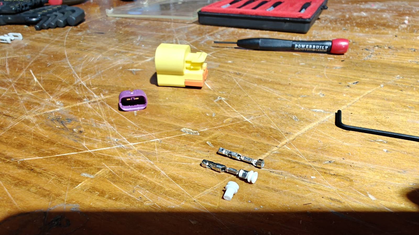

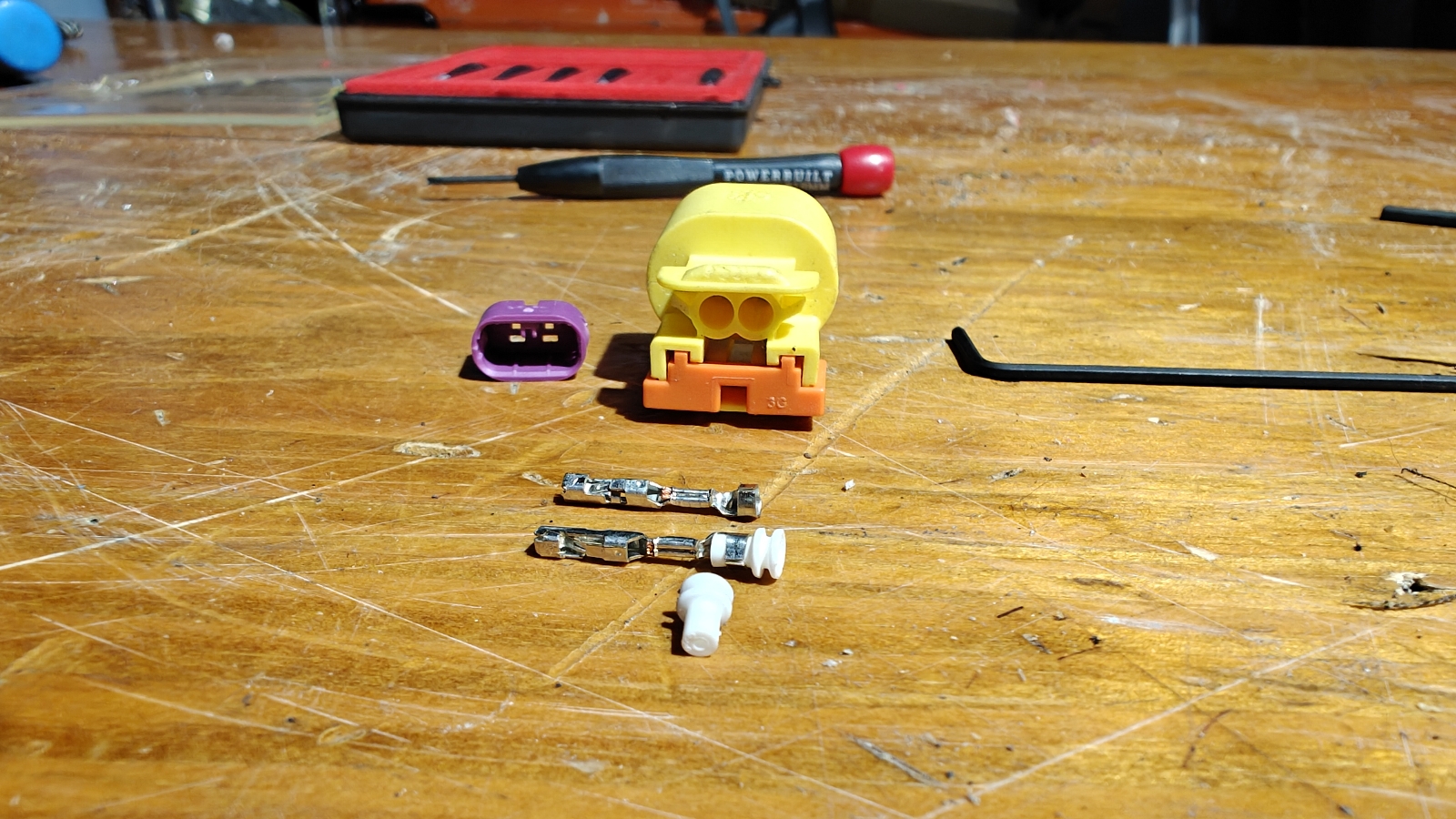

Any wiring diagram help would be great. I somehow tore the two wires out of the driver's underseat connection while removing the seat to replace the cushion the other day, and need to rebuild the harness with some new wire and solder.
