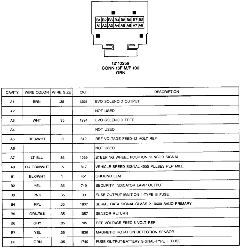

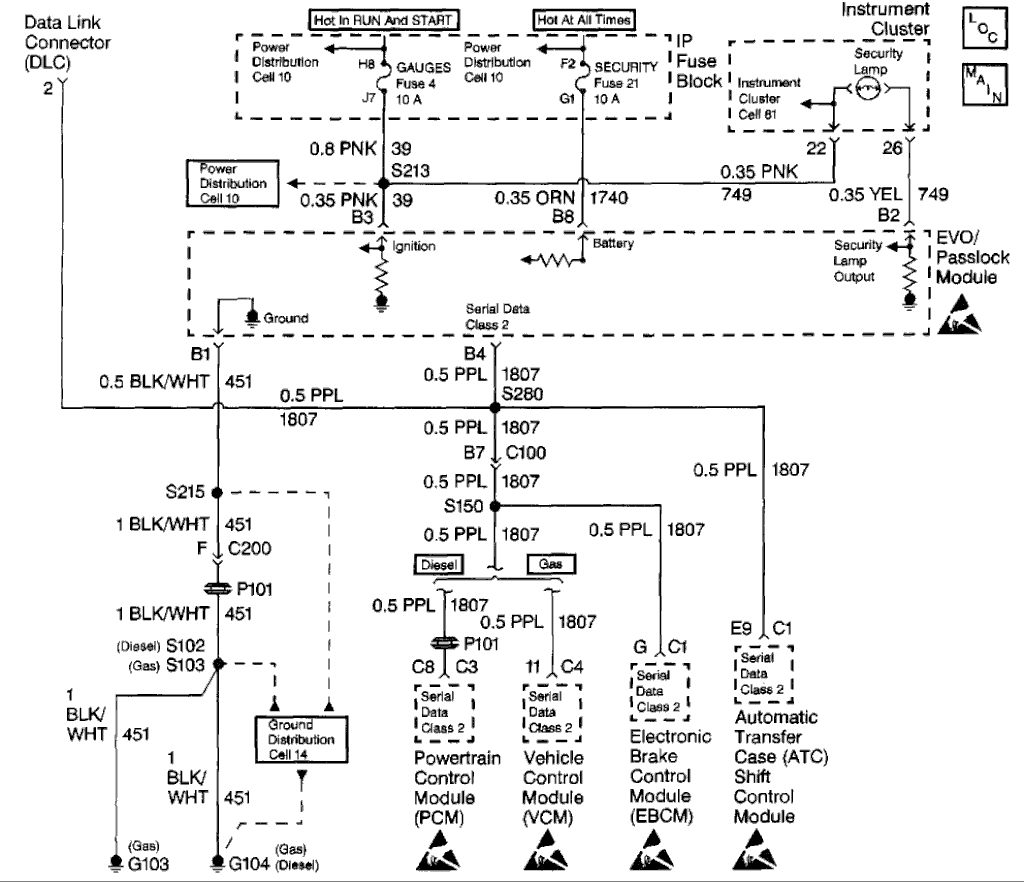

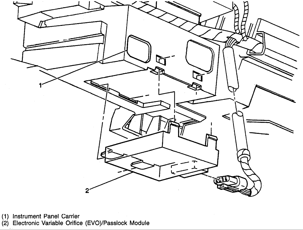

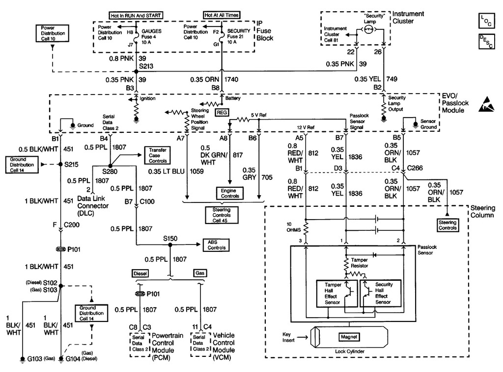

Here is the diagram from a 98. There should be three wires coming from the sensor at the ignition switch and going to the passlock module...yellow, red/white and orange/black. I believe the module is under the dash somewhere behind the ashtray.

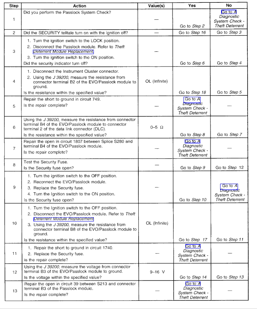

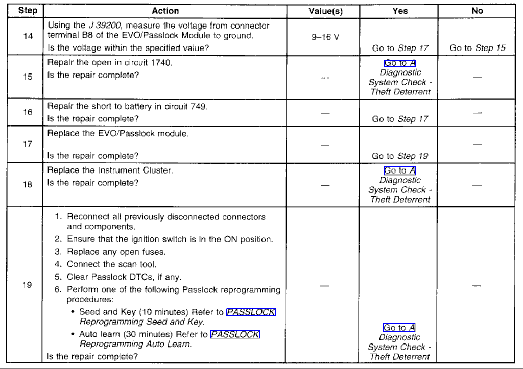

Here are the diagnostics for "Security indicator always on or flashing"...
