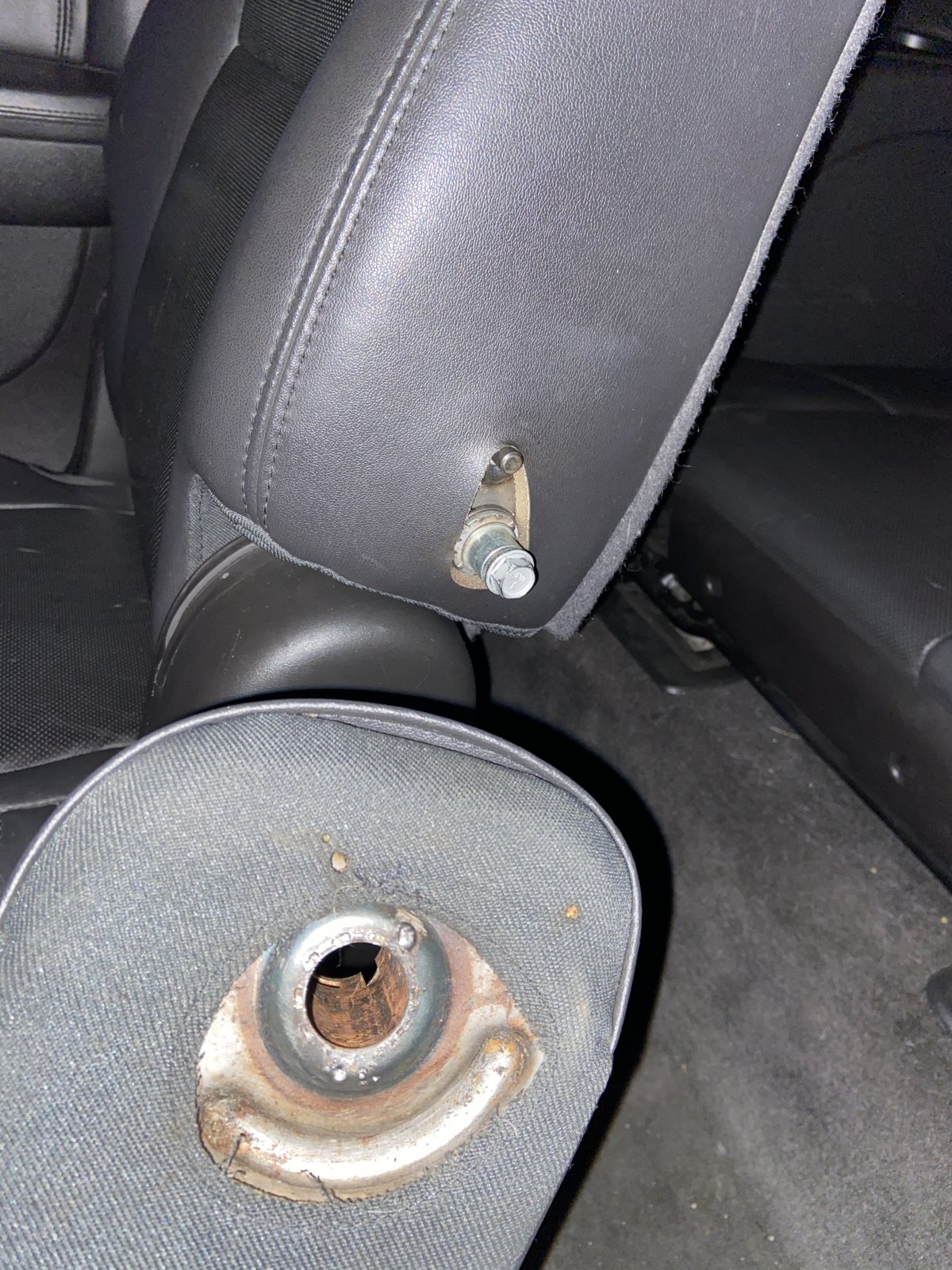

The armrest came off on the passenger side captain. Anyone ever have this happen, and how did you proceed?

Can you take a picture of what you have? Need to know what’s still attached and what fell off.

The seat has the stud and the nut is still on it. I’ll take a pic tomorrow morning. Thanks for the fast responses.

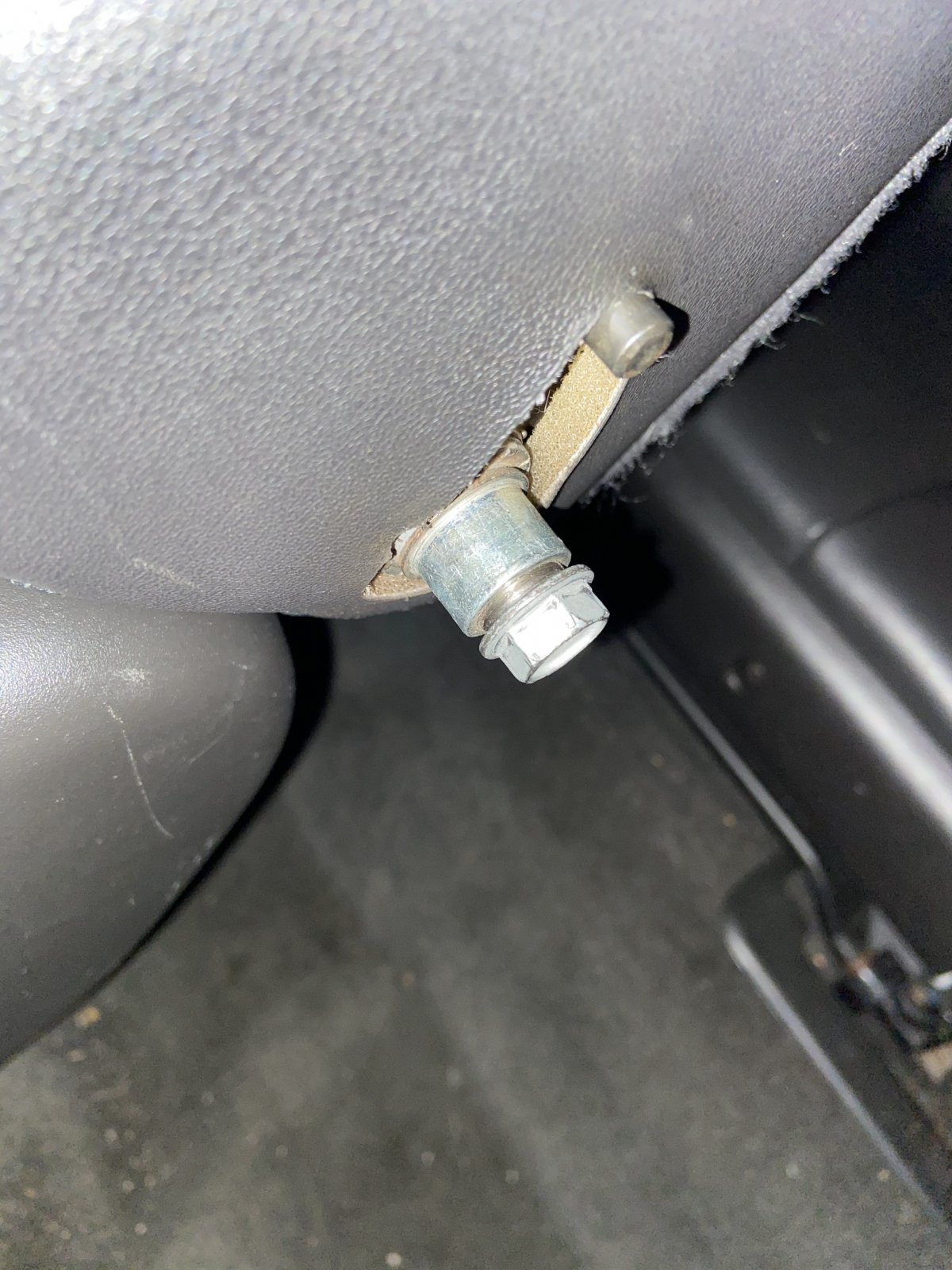

Sorry for the delay.

Looks like that bushing that's around the bolt threads should be attached to the armrest. Actually looks like there's some broken welds.
Remove the bolt and take that bushing and place it into the armrest and see if any of those tack welds seem to match up. If that's the case, I would just JB Weld or epoxy it in there.

So I went to a salvage yard and pulled an armrest off a Tahoe and the bolt on mine is a stud attached to the seat on the Tahoe. What years use a bolt and what years have the stud?
