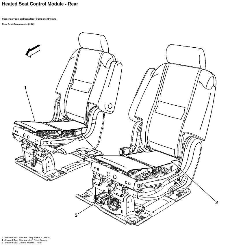

I have looked online and in this forum for the location of the 2ND row captain chairs heated power control module unit. Before I tear everything up looking for it does anyone have this location. I have already repaired the front seat module...I have one of the chairs in the back that turns off after a few seconds...Help...just need the location.

Look on www.charm.li. I've posted a link to the diagram for a 2011 Esky, so click on that link and note the path at the top of your browser. Navigate to your year and model for a similar diagram that applies to yours.
