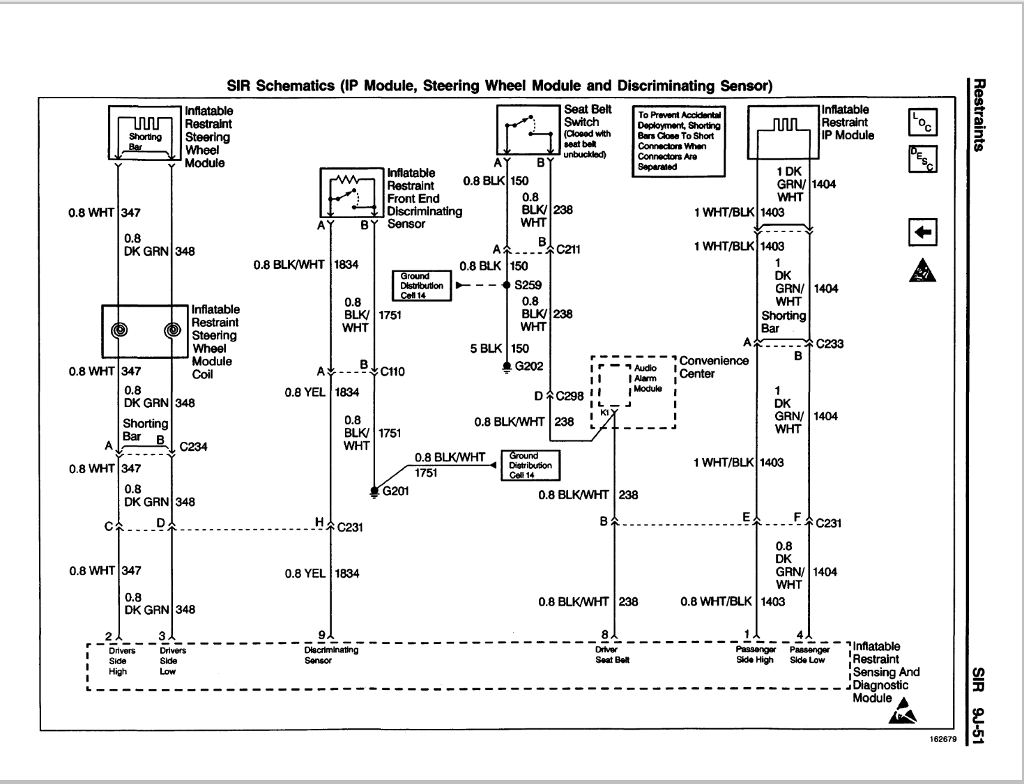

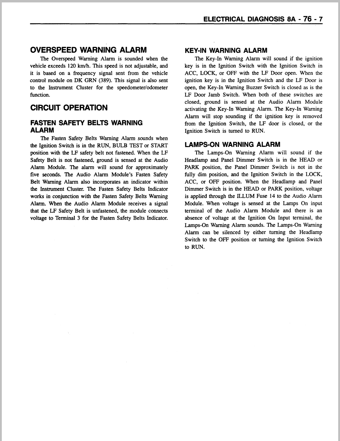

Here is what I see for a 1998. Fine print- no guarantee that it’s the same for 96 but it’s probably close enough.
It looks like the seatbelt switch is normally open, providing a ground through the door chime alarm module to the cluster. GM’s diagnostic is fairly simple...unplug the door chime box from the convenience center and see what happens. If the light stays on, it’s a short to the cluster or a bad cluster. If the light goes off, it’s a bad door alarm module.
So after spending several hours to confirm...the "Audio Alarm Module" is bad. Thank you again for the service manual info. Now the question is, if I leave the module removed, what does this effect negatively? Or does anyone know where to get replacements other than a junk yard?
